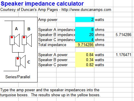

Consider Speaker A(or B) as the ballast resistor
Yes, that is what I did (I think), but when I use a value of 7.2, I can find no way to balance the watts between a 4 ohm and an 8 ohm speaker.
Perhaps I do not know what a "ballast resistor" is as opposed to a "resistor" and hence the confusion.
Here's what I did... ("Speaker B" is a resistor):
Awesome! Thank you!
I am not sure how you used the 3 s+p (A) page to come up with 7.2R in parallel with the CHR-70.
I did, however, model it this way:
Speaker A (CHR-70) = 8 ohms
Speaker B (resistor) = 19 ohms
Speaker C (EL70) = 4 ohms
The result is that speakers A and C end up with (roughly) equal watts and the total impedance is 9.62 ohms. If I go with 20 ohms for "speaker" B, then the CHR-70 ends up getting slightly more power (to compensate for minor lack in sensitivity).
Am I doing this wrong?

Thanks for this info. Just out of curiosity today I plugged the rated DCR values of the EL70 and CHR-70 (3.6 and 7.2, respectively) into the same spreadsheet application (referred to by Chris) and the numbers still work fine with a 20 ohm resistor. I can only assume that the numbers work fine in that spreadsheet across a pretty good margin of impedance, which should accommodate any driver-to-driver variances.
I think this is my way forward. A 10 watt 20ohm resistor should be plenty, considering that even if I push my amp to its full 50 watts the resistor will only be getting 8.4 watts of the load. I typically push between .3 and 1.3 watts, so I doubt the resistor will even get warm.

So the higher impedance driver receives more power when in series 😉 I knew something was off about the discussion and what was being drawn from that quote. That makes a lot more sense because it's a higher load, so it burns up more power. If in parallel, my analogy applies, because the current floods the lower load.
I still feel the resistor is not required. I'd take the time to try with and with out. The top firing woofer is more a BSC device than anything. Having said that, I'm not the designer and I haven't heard this speaker, so it may be more than that.

Been quiet since i didn't want to come out and say that the idea was closer to the former than the latter. But now 50-60 posts in that is becoming evident (i just skimmed, busy getting flat-paks out).
If Cogi can get some CHR70.2 it might work, with CHR70.3 that unit will -- on average -- be 3dB down from the EL70 (actually more like 5 dB given that EL70 is a couple dB more efficient than CHR).
Given how easy it is to try, i would, you might make one of those serendipitous discoveries. And if that 2w i saw somewher is a Decware E84, wire them in parallel.
Now using 2 CHR.3 + and EL70 is a more interesting proposition, but then it would be time for a new box.
The idea of trying to fudge things with a resistor is anathema to me.
