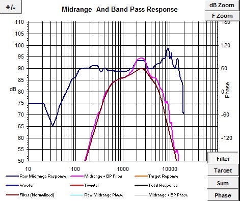

Are any of you guys having trouble implimenting the Aura 3" into J Bagby's X-over designer? Are any of you using that program?
In a 3-way, 300-6000 LR4-LR4 is not a narrow band for a midrange, but the filter curve that the program comes up with kills all curve flatness and brings a big bump around the driver's natural 4 db bump @2-3k. I can EQ that out, but why is that happening? Will that problem translate to the active or is that an artifact of the passive?
