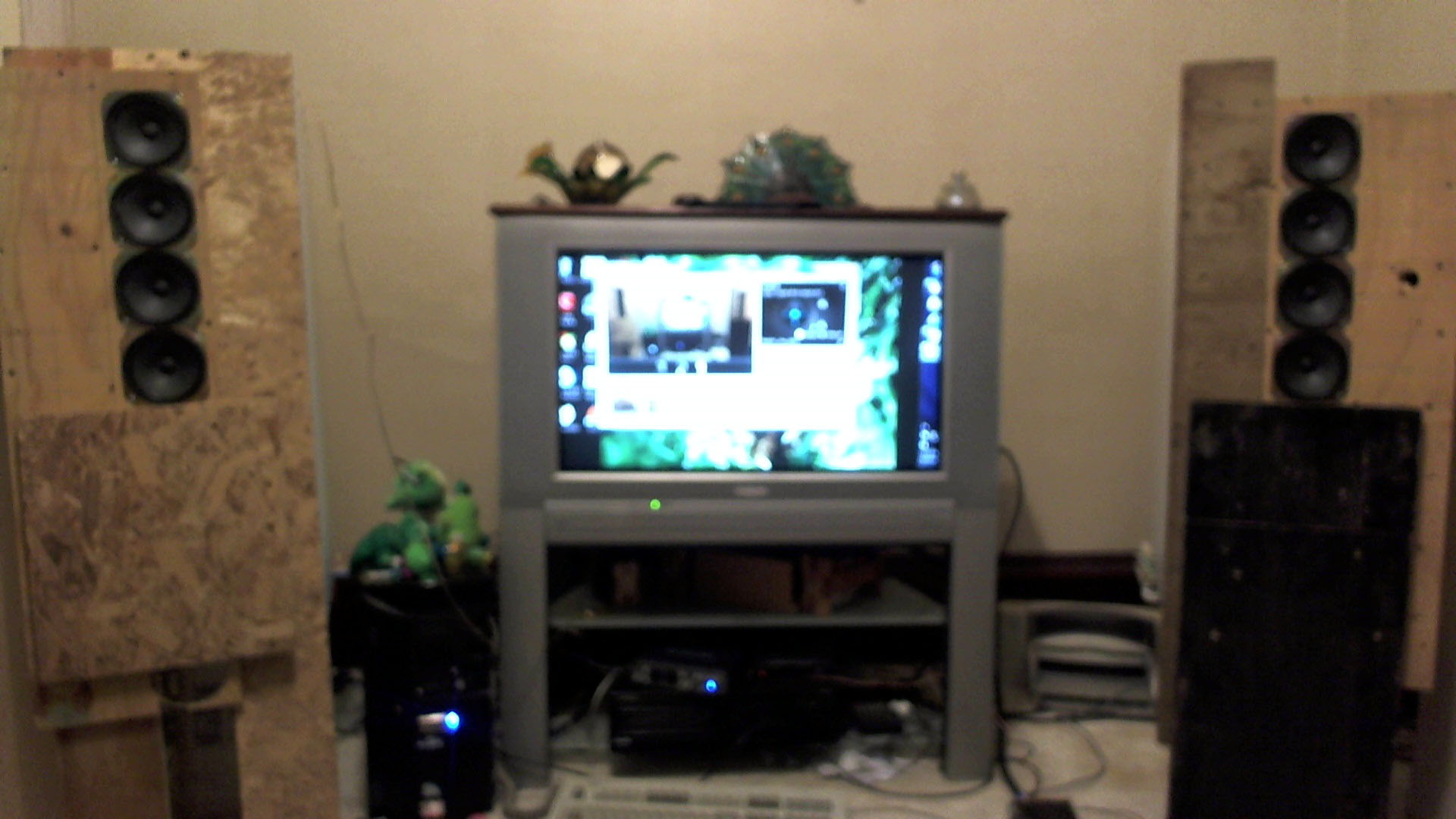

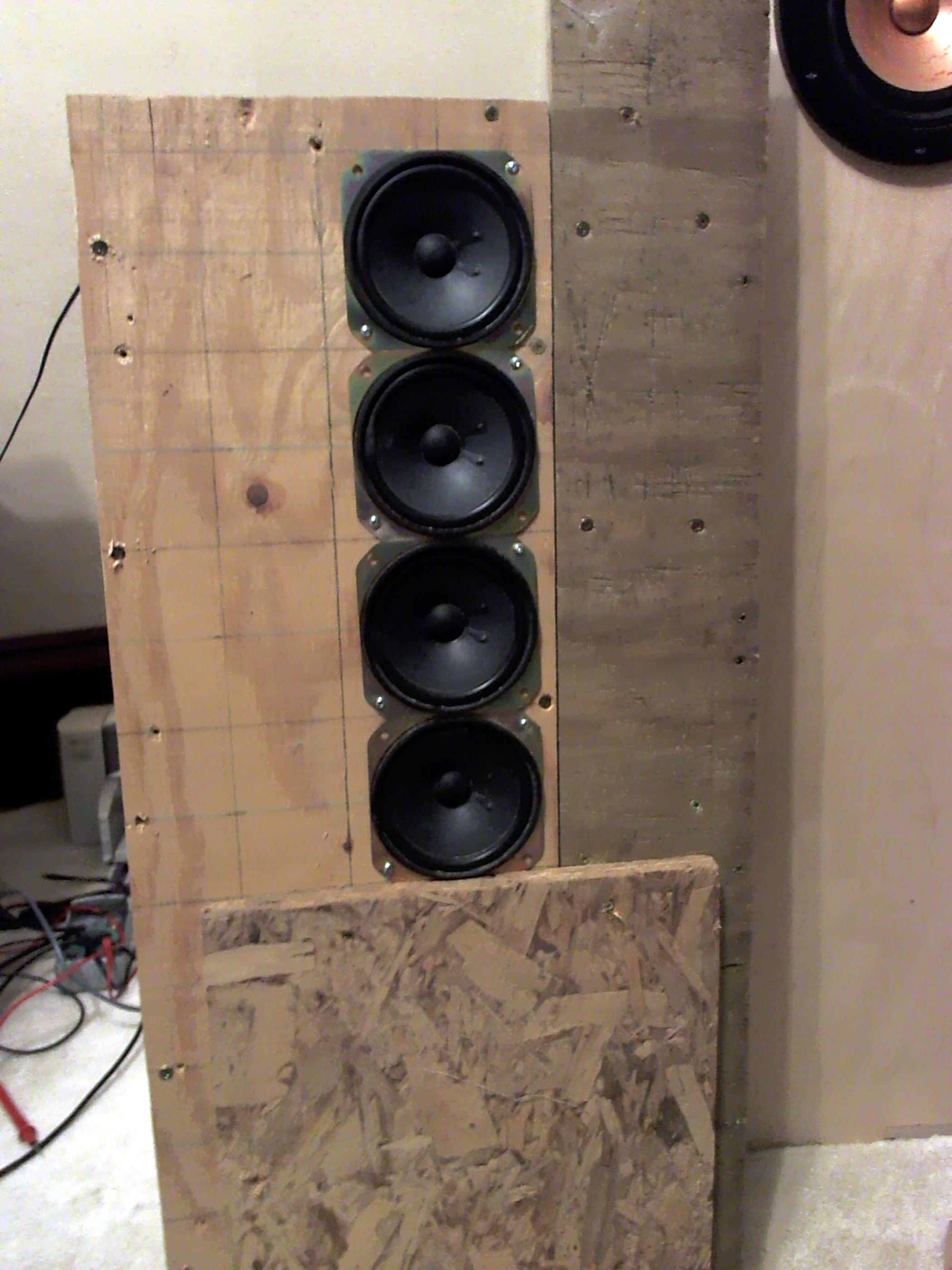

The first photo shows the driver spacing of some panels I had cut well before I had done any research (like reading Jim's white paper). The goal of these panels was to space the 15 drivers/cabinet to create a floor to ceiling cabinet. Needless to say, that was a waste of time, definate sound phasing issues...

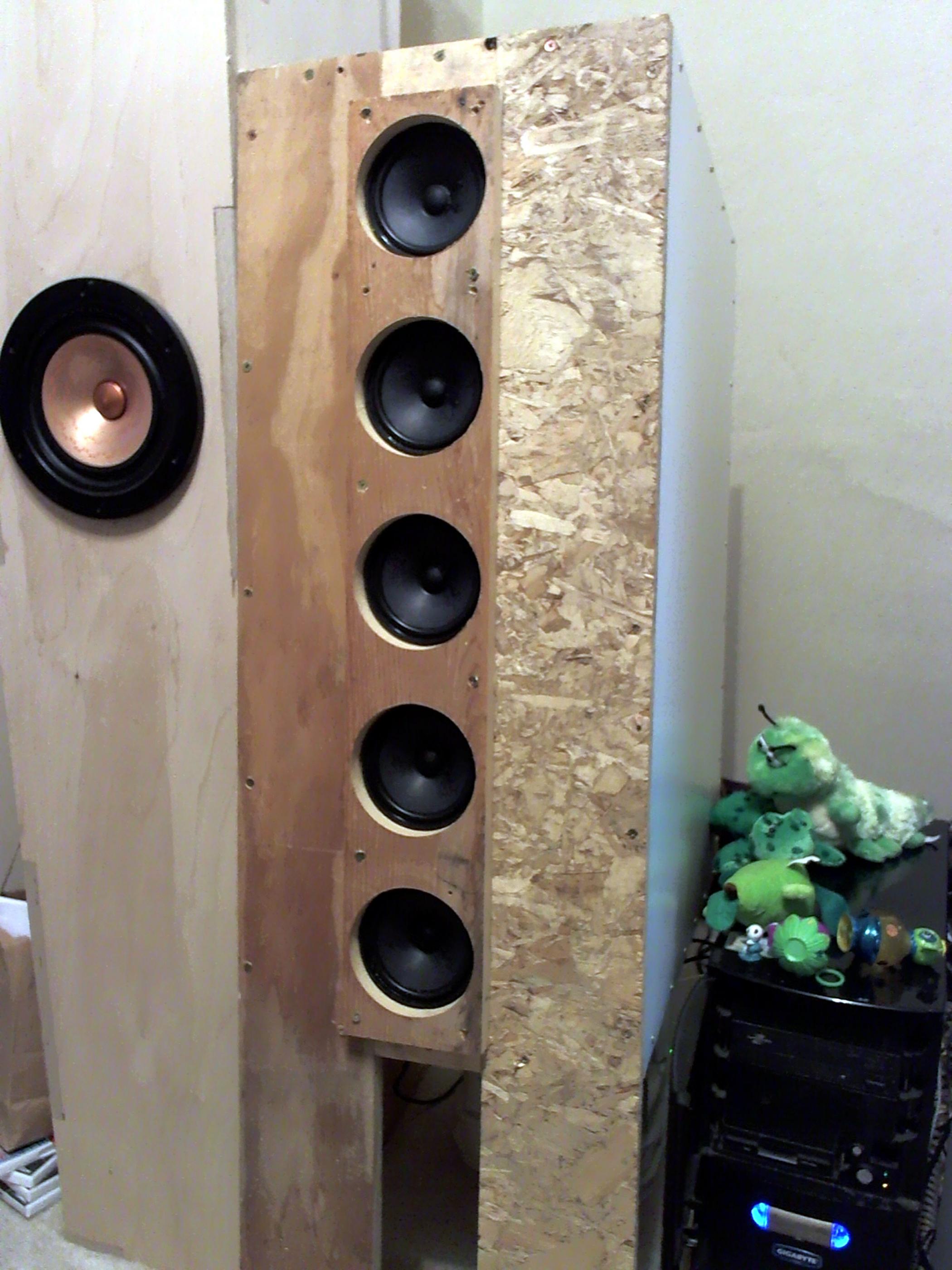

Having the drivers right next to each other (second photo) certainly produced a clearer sound, which justified a stereo listen (photo 3).

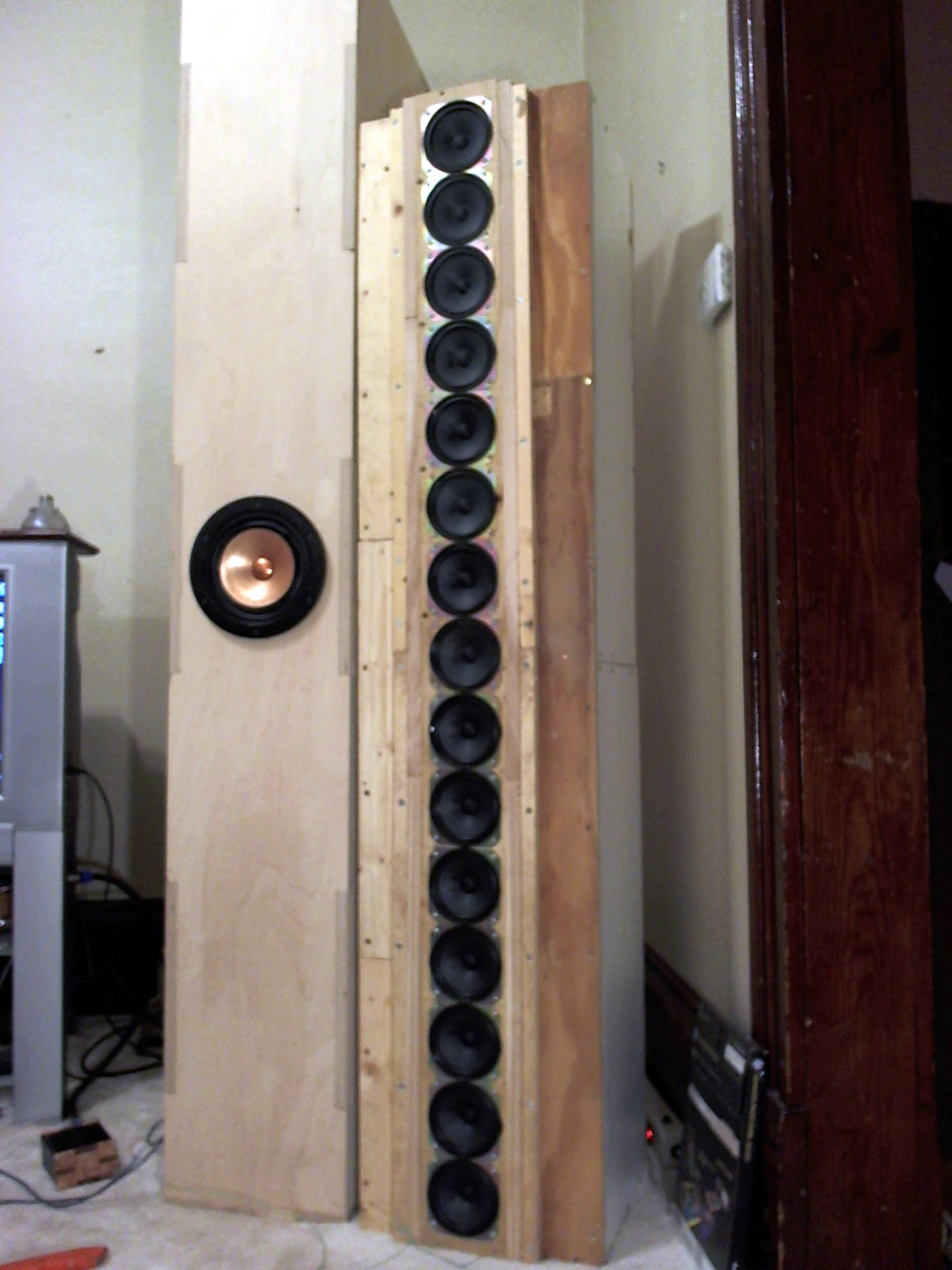

Already I was noticing a larger sound feild eventhough the bandwidth was really lacking. However, this proved enough to go for the full 15 line build. (photo 4)

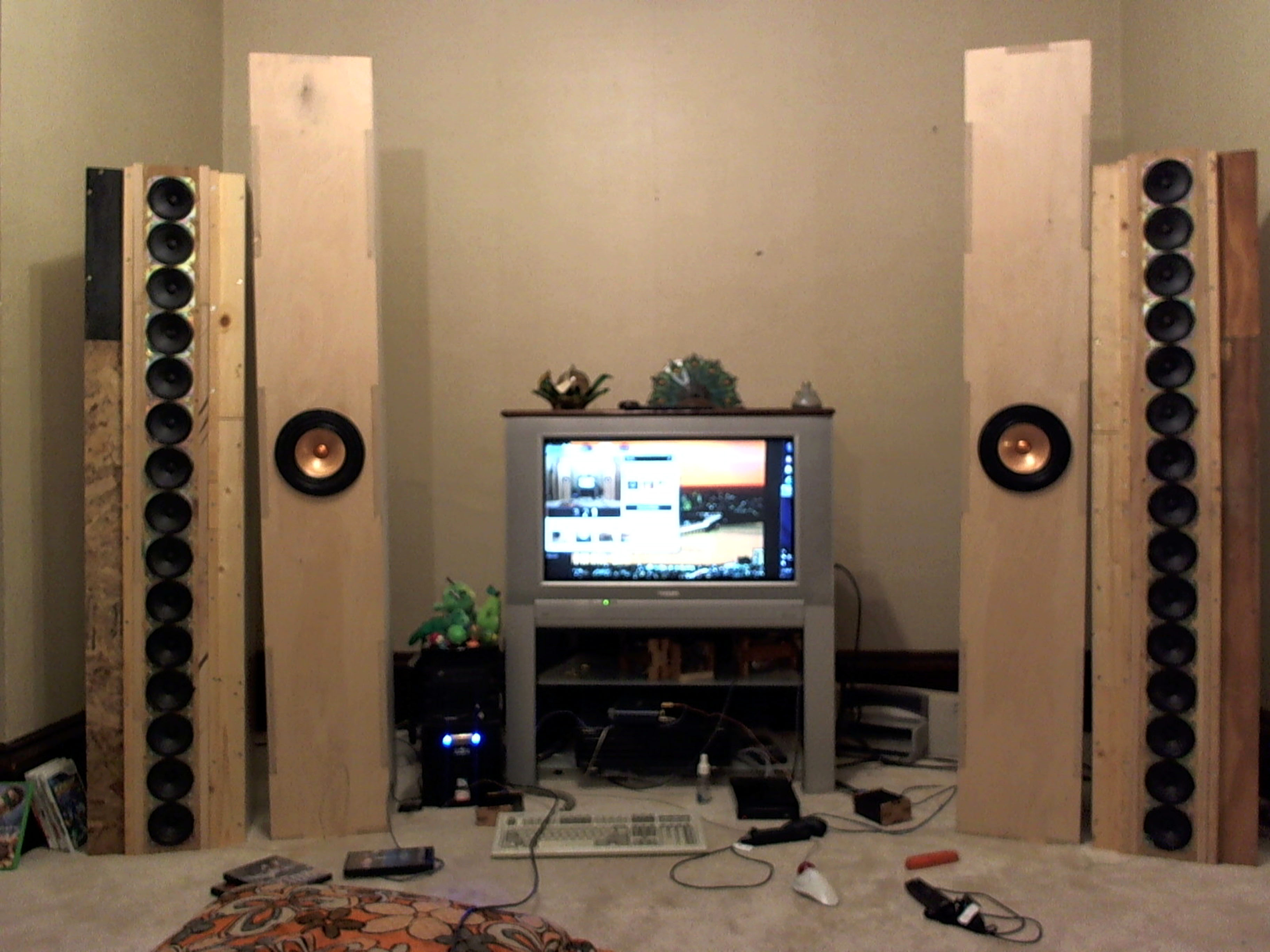

Listening Impressions
The 15 driver arrays had a much better mid-bass presence, and as expected, a high roll-off. I also found the mid-treble quite shouty and the low bass lacking all together. None the less, I really liked the big sound scape.
Using test tones and chomatic scale, I used the EQ in Foobar to remove the shout at around 2kHz, (-4dB) the extra bass at around 125kHz (-3dB), add some treble gradually up to 10kHz (+6dB) and low bass at around 77kHz (+4dB) and 55kHz (+8dB). This turned out surprisingly well. Almost as good as my Avebury System. The Avebury wins hands down on low bass, and a more refined treble. (I built this with the Alpair12 enabled). But when it comes to enjoying music, these "stupid cheap arrays" sound really good, better then they perhaps deserve to when compared to baltic birch all out Avebury build! Do not get me the wrong, the Aveburys put out a big sound scape also, however the main diference is, and it is an important one:
When I hear the Avebury (point source) the music is "over there" like you are sitting in the back row at a concert.
When I hear this slapped together Array, the music is "right here" and I REALLY like that! I want to get up and dance (although I have to watch when I stand, as my ear goes just above the array, where you hear a significant SPL decrease. So what you read about in line array theory is true. The sweet spot is larger. And yes, they go "swish" with certain sounds in trance music too. But when you are sitting or even dancing, this is really no big deal at all. My Avebury system sounds diferent all over the place, so in that way, the array wiht its comb filtering is more even thru out my room! Do not get me wrong, if you want as big of a band width as possible from a six inch driver, build the Avebury. But I tell you what, I am kind of thinking I would like to persue this line array idea some more. I would like to try a better driver, something with a more refined high and something I can push thefelt lows on more. I still want to stick with full-range, as I am sold on that concept, although I would not be completely heart broken if I need subs at 40Hz and below!
I have a feeling also that I can get better bass from this current build if I build the cabinets better, as in unscrew them and actually glueing them! Yes, you read that right, this was all 100% a no loss, cheap skate, half ^$$@) build! But it has proved its worth, not nesicary a baltic birch build, but awell built recycled wood well build, atleast something I can share photos with. And I can tell you this, after cutting all those holes and doing all that wiring, no point messing around, get good wood, and use good wire (I used cat 5) - (thankfully, that part is glued and done proberly!)
At this point, I am debating whether to sell my Avebury system to pursue a better line array build.
My system is PC based using Foobar for music and media player for DVD (no EQ on the movies thou - 😕) I am using a M-Audio fast-trac Pro outboard DAC and the speakers are being driven buy 40 watt Peter Daniel Chip Amp kits - another advantage of the Arrays - higher sensitivity!I am listening to the arrays nearfeild in a 10 X 14 foot room.
