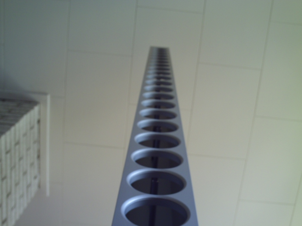

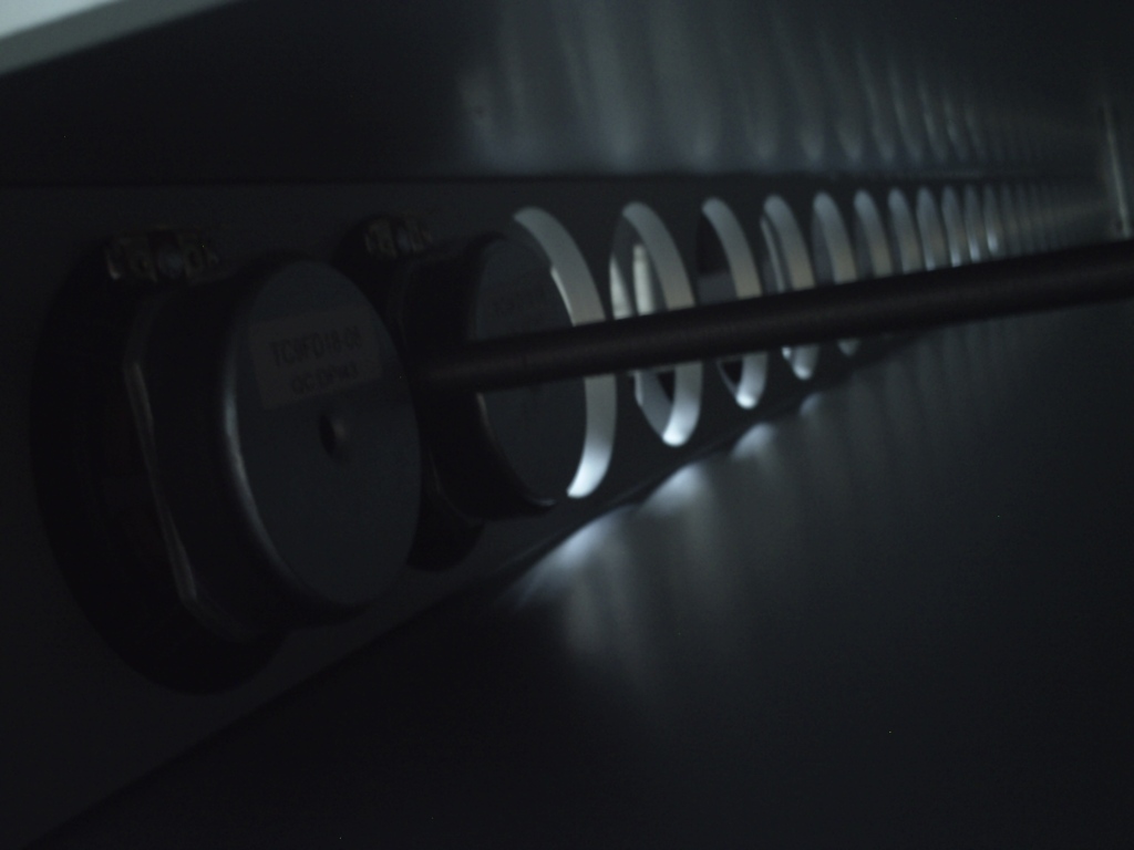

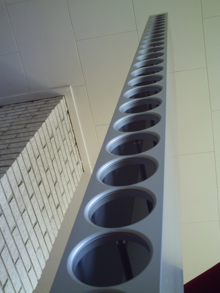

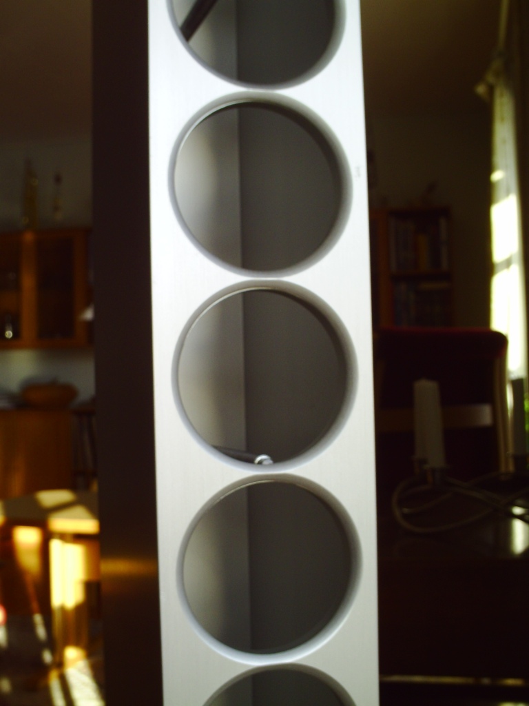

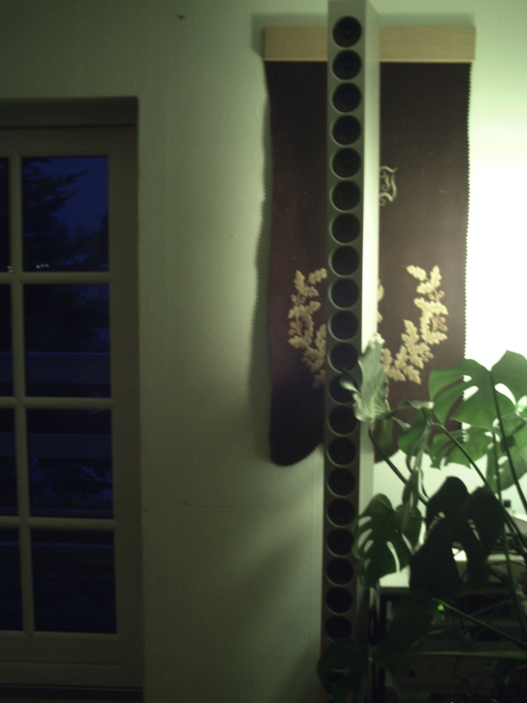

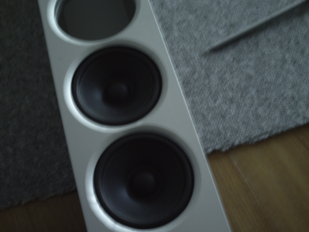

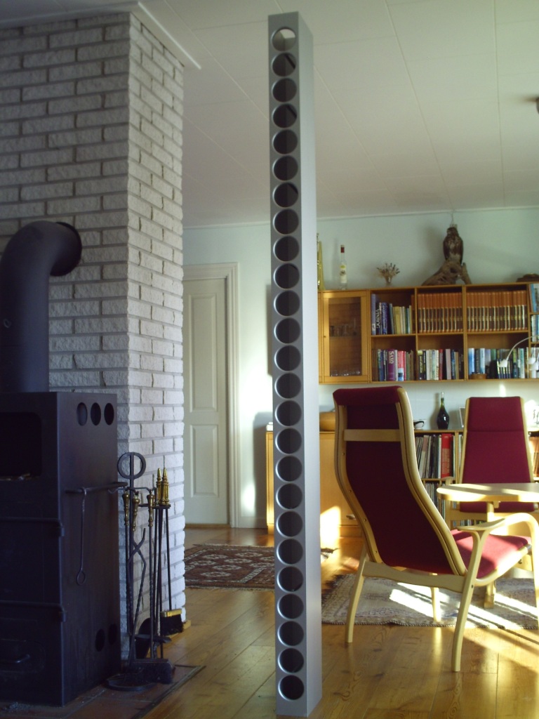

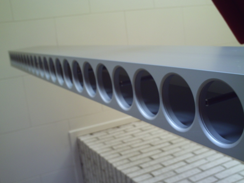

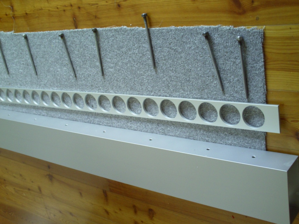

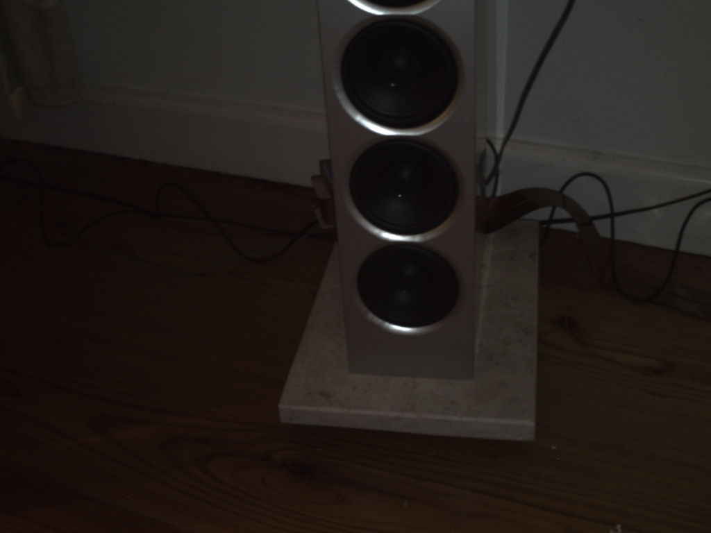

My ALU e closures has come back from the machine shop and been anodizised.
These are for the vifa drivers and will NOT fill teh bill of beeing "stupid cheap"! Not at all.😱
Aluminium working, espascially when prototypng, is very expensive..
Here are some pictures.
They should be self explainable, but ask away if in doubt.😛

Koldbe
Wowwee! No, aluminum large enough for that baffle must have cost a fortune. I have a few rounds and flat plates of 6061 and they weren't cheap at all. Gorgeous enclosure and fitment though. What driver edge treatment did you use and why?
Thanks,
Wow! 😱 😎
Very nice anodized aluminum enclosures! I've been messing with scrap wood to figure out how to cut bezels and learned my Roto Zip only goes down to 83mm holes and I need 76mm. 😡
So I'm back to the hole saw and attempting to figure out how to bevel the holes to prevent diffraction. The weather has turned nasty so I have time to think this one out.
The CNC aluminum bezels would look great but might be a little out of my price range. :h_ache:

Thanks. I cannot divide into smaller compartments, because the drivers has to be pushed in from top or buttom. I have mounted self adhesive damping aspahlt ( the kind you use in cars) on the inside side and back walls to dampen the resonances in the alu. And I plan to make a wood piece in the hole length , with holes in , a little larger than the inside width, so it will be in tension (not the right word) between the walls to further damp the sides.

Why not use a router to make the bezel?
You can get special router bits for just that purpose.
That was what I used.
I even made the holes with the router, but the holesaw will be fine.

Can't wait to hear/read what it sounds like. I understand your problem with the kind of mounting you have. I do like it though, the drivers beeing mounted from the rear.
I think you allready had everything anodised. Otherwise I'd suggest beveling the inner mounting fixture as well to let the speakers breathe at the back side.
Did you use self damping asphalt? If you havent put it in yet consider using the butyl type damping materials. It is superior to the asphalt in more than one way.

Wesayso:
You are right, the mountring plate ougth to have a bevel as well, but it is only 6 mm thick so it is not a big issue , I think.
Greg:
I only asked the alu- workshop to bevel the holes so there would be no sharp edges. The material is only 4 mm so there is no horn/waveguide function here.

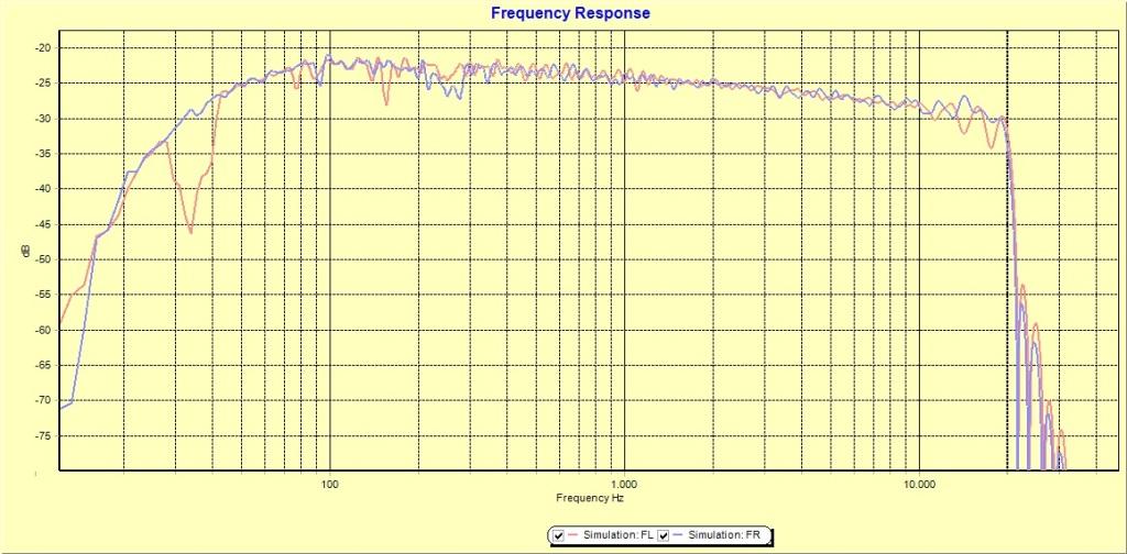

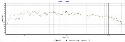

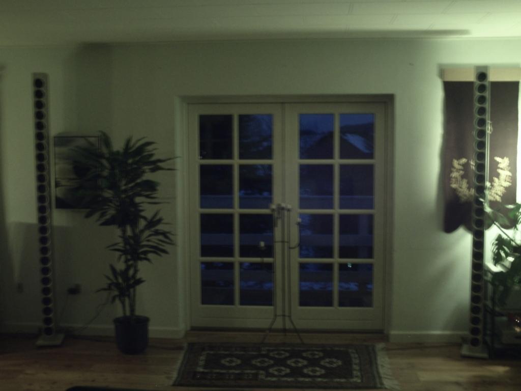

Hi Again
The aura sound NS3 are now put to work in the basment Theatre and they are doing a superb job there. <for the money they are very good sounding and certanly fills the bill of being a "Stupid Cheap Line array".
But...
The Vifa is quite another story!
They are truely High End stuff.

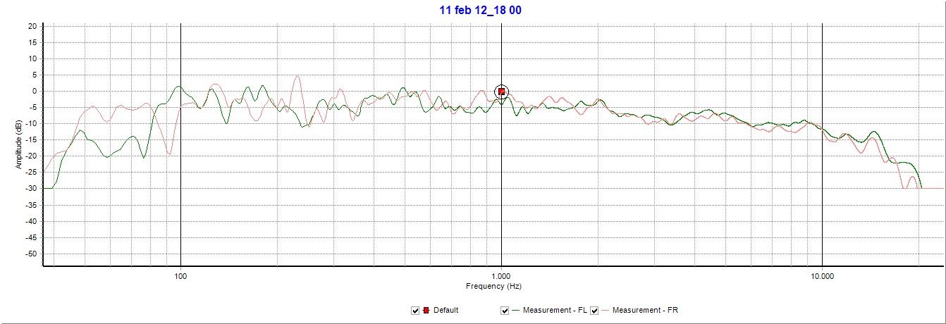

The two graphs below are measured in the listening position 3 m away.
The Vifa graph is the raw uncorrected response and Vifa2 is after Audiolense has done its magic.
They make a very good soundstage, have terrific transient response, are tonally neutral an above all they are very musical sounding speakers.
I have been in this game for many years, starting out in 1975 with Quad els57 with RTR 15 spheric tweeters and KEF b139 TL sub. electronic XO with tube amps for ELS and Dynaco stereo 400 as sub. amp.
I have , among others, owned Tympany 1D, Audiostatic ELS, as importer i Denmark of ProAc a lot of their speakers a DIY fullranhe true ribbon speaker and heard numerus other systems.
And these Vifa lines is up among the best and I believe , with the right sub (I am thinking 2 or 4 18" Infinit Baffle) and perhaps a ribbon super tweeter (2 m long) , that they will surpass tem all!!
Bold words yes, but tey are so good IMHO!!!
Koldby
