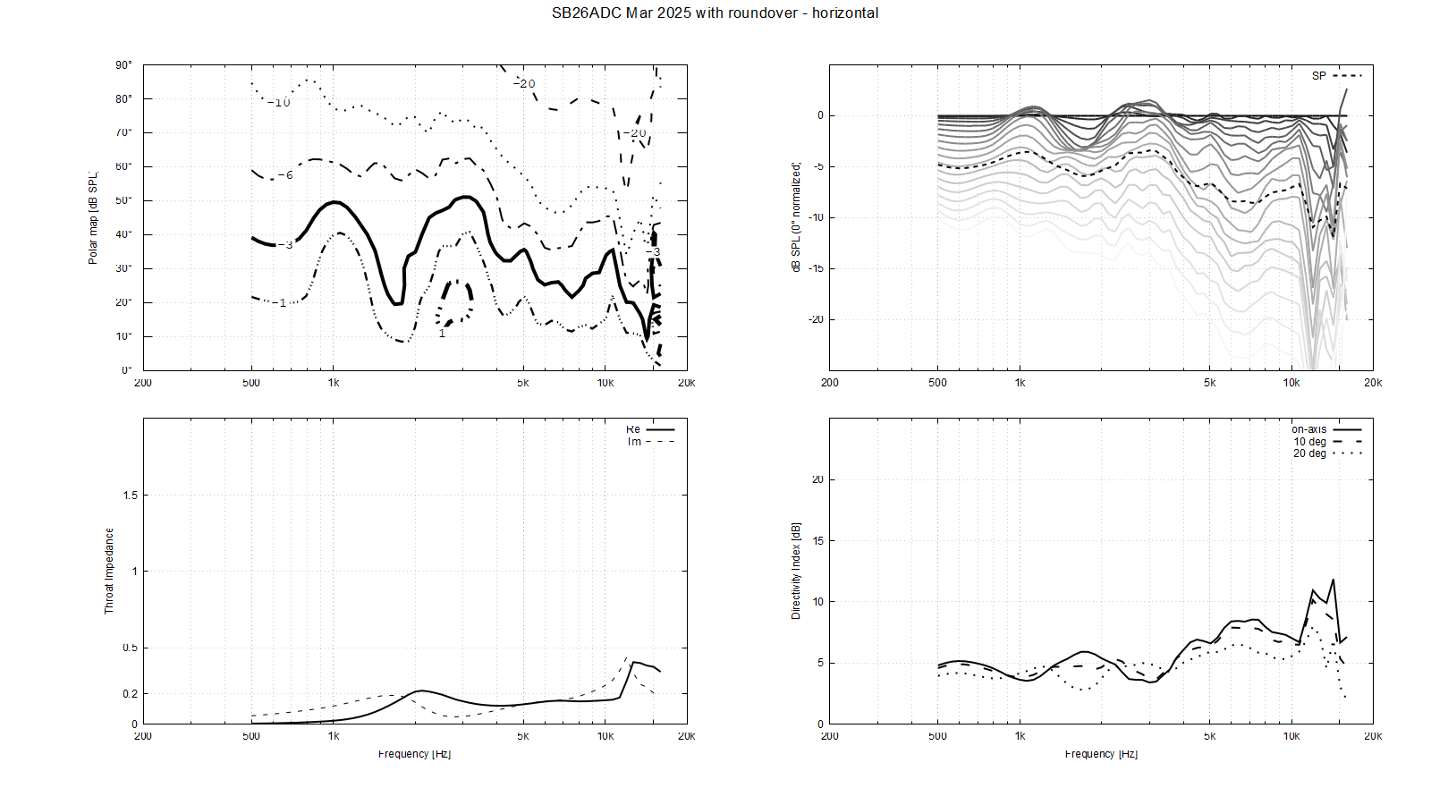

So I thought it might be fun to post some weird ATH waveguides, basically to evaluate what would happen if you made something strange.
Over the years, I've struggled to make a waveguide with a diffraction slot that actually works; most of my experiments with ATH and IRL haven't really panned out. Diffraction slots have a LOT of issues.
Then again, I found that triangular waveguides work shockingly well, even though I've never seen anyone actually build one IRL.

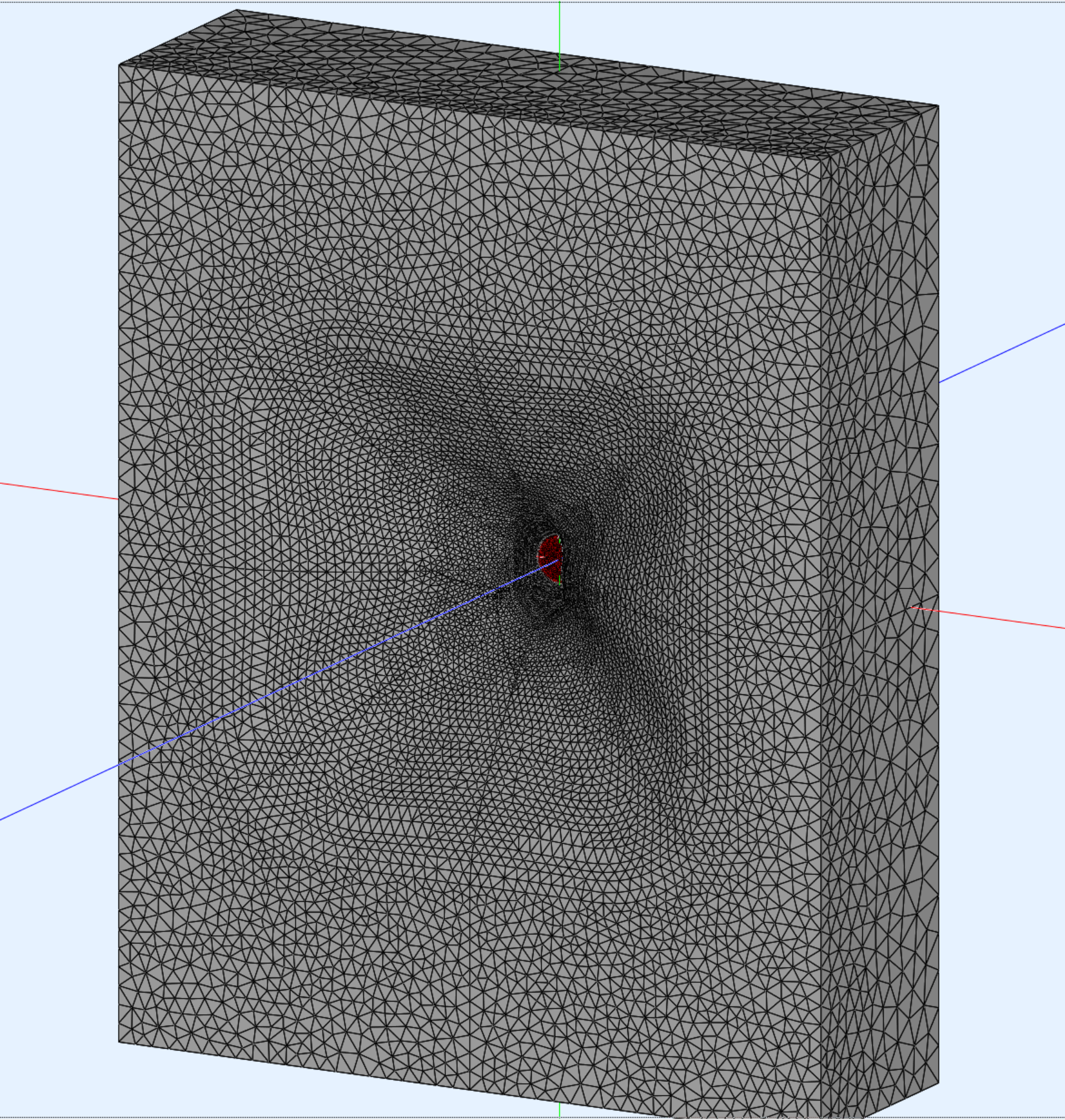

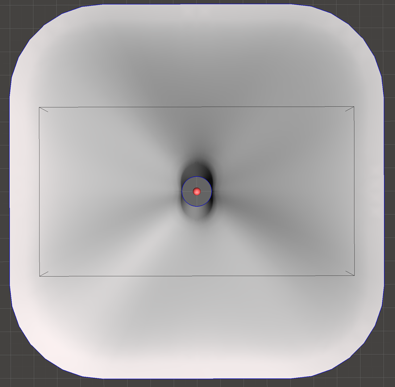

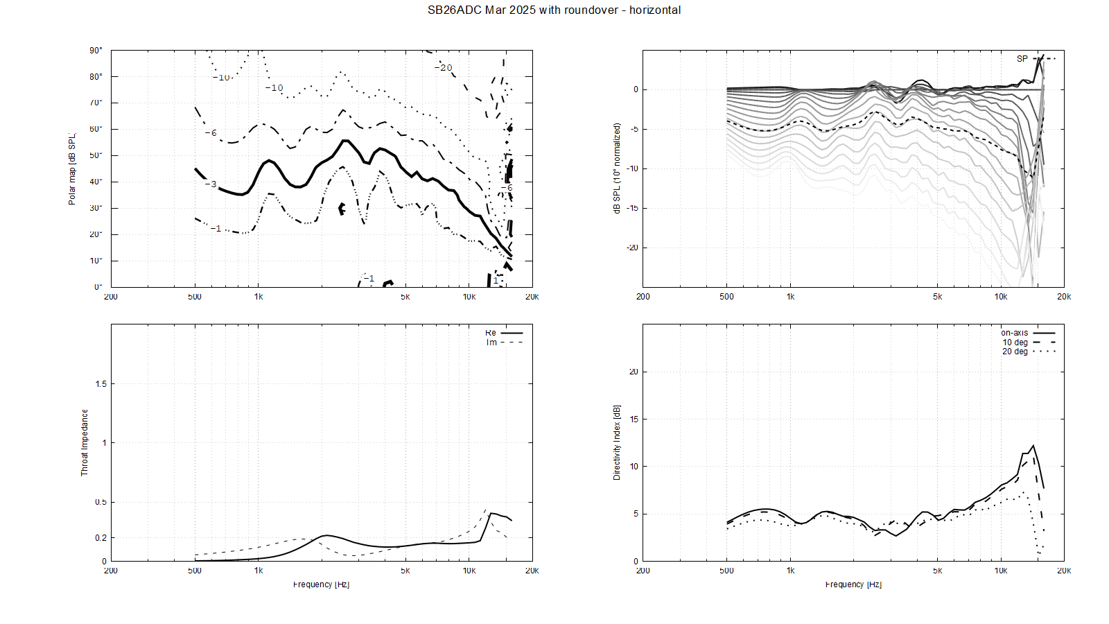

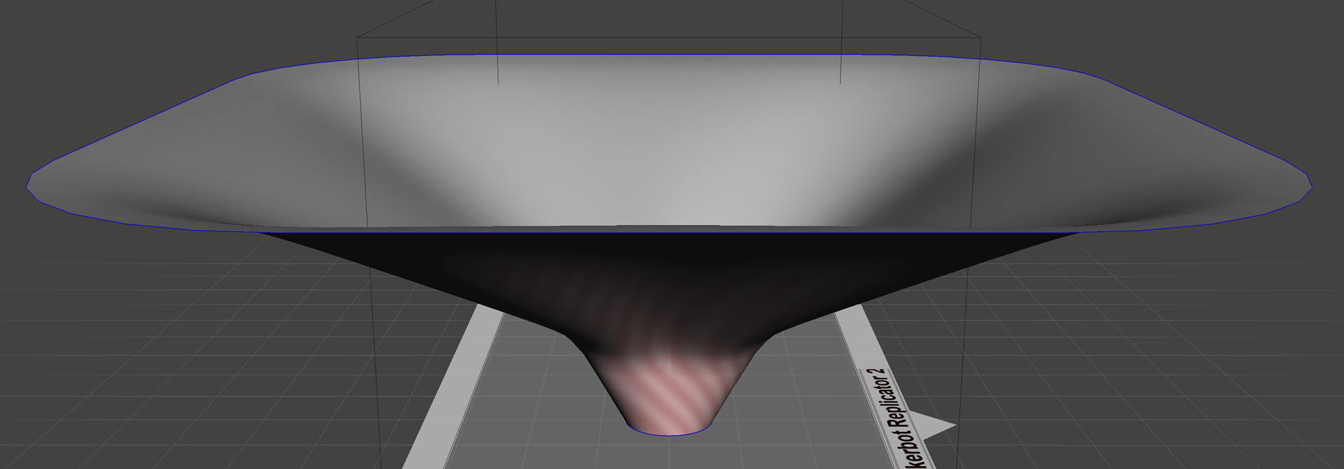

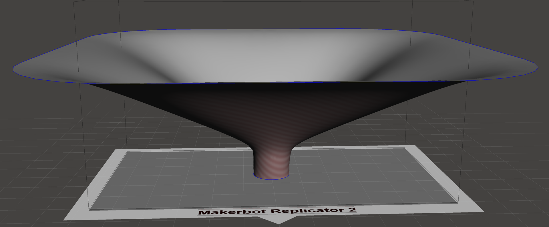

Here's a waveguide I made with a diffraction slot. Normalized horizontal and vertical polars are attached. I've also attached a pic of what the enclosure looks like.
; SB26ADC Mar 2025 Waveguide with diffraction slot
; Ath version 4.9
Source.Contours = {
zoff -1
point p1 2.58 0 2
point p2 0 13 0.5
point p3 1 14 0.5
point p4 0 15 0.5
point p5 0 16 1
cpoint c1 -33.94 0
cpoint c2 0 14
arc p1 c1 p2 1.0
arc p2 c2 p3 0.75
arc p3 c2 p4 0.25
line p4 p5 0
line p5 WG0 0
Source.Velocity = 2
Mesh.ZMapPoints = 0.3,0.2,0.7,0.9
Throat.Diameter = 32 ; [mm]
Throat.Angle = 30 * sin(p)^2
;Slot.Length = 25.4 * cos(p)^2
Slot.Length = 25.4
;Throat.Profile = 1
Length = 114.3 ; [mm]
Coverage.Angle = 55 + 10 * sin(2*p)^2
Term.s = 0.7
;Term.s = 0.25 + 1.0 * sin(p)^4
Term.n = 4
; Term.n = 2.5 + 2.5 * sin(2*p)^2
Term.q = 0.995
Morph.TargetShape = 1
Morph.TargetWidth = 355.6
Morph.TargetHeight = 355.6
Morph.FixedPart = 0.25
Morph.Rate = 3
Morph.CornerRadius = 88.9 ; [mm]
Morph.AllowShrinkage = 1
; Mesh Setting
; ABEC
Mesh.CornerSegments = 8
Mesh.ThroatResolution = 1
Mesh.MouthResolution = 8
Mesh.Subdomainslices=
;Mesh.InterfaceOffset = 5.0
Mesh.Enclosure = {
Spacing = 64, 128, 64, 128
Depth = 150
;EdgeRadius = 38.1
;EdgeType = 1
FrontResolution = 12,12,12,12
BackResolution = 24,24,24,24
Mesh.Quadrants = 1
Mesh.LengthSegments = 24
Mesh.AngularSegments = 72
Mesh.SubdomainSlices =
; ABEC Project Setting
ABEC.SimType = 2
ABEC.f1 = 500; [Hz]
ABEC.f2 = 16000 ; [Hz]
ABEC.NumFrequencies = 61
ABEC.MeshFrequency = 1000 ; [Hz]
ABEC.Polars:SPL_Horizontal = {
MapAngleRange = 0,90,19
Distance = 3 ; [m]
ABEC.Polars:SPL_Vertical = {
Distance = 3 ; [m]
Inclination = 90
Output.STL = 1
Output.ABECProject = 1
Report = {
Title = "SB26ADC Mar 2025 Waveguide with diffraction slot - horizontal"
PolarData = "SPL_Horizontal"
NormAngle = 0
Width = 1600
Height = 900
MaxAngle = 90

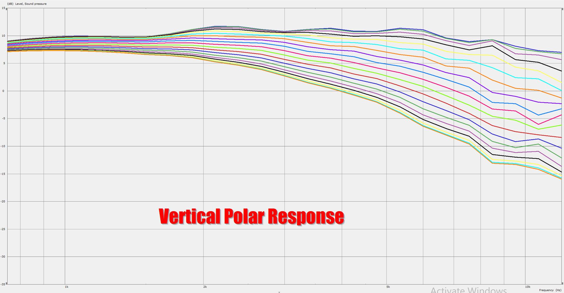

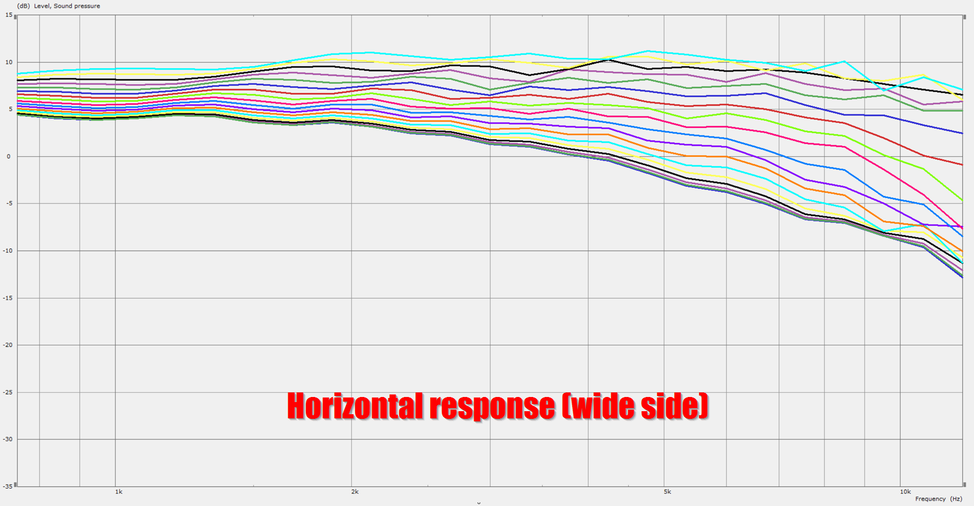

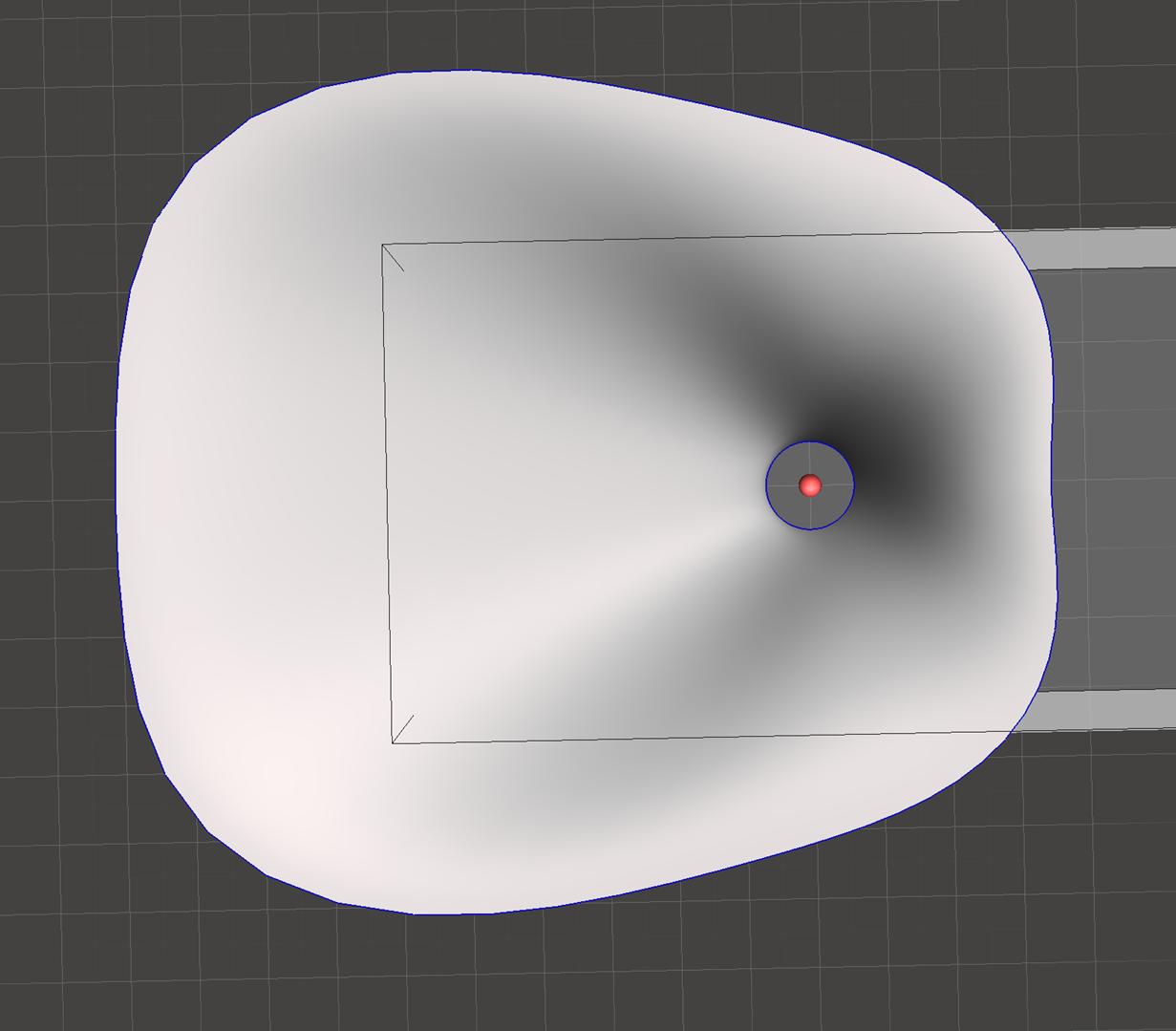

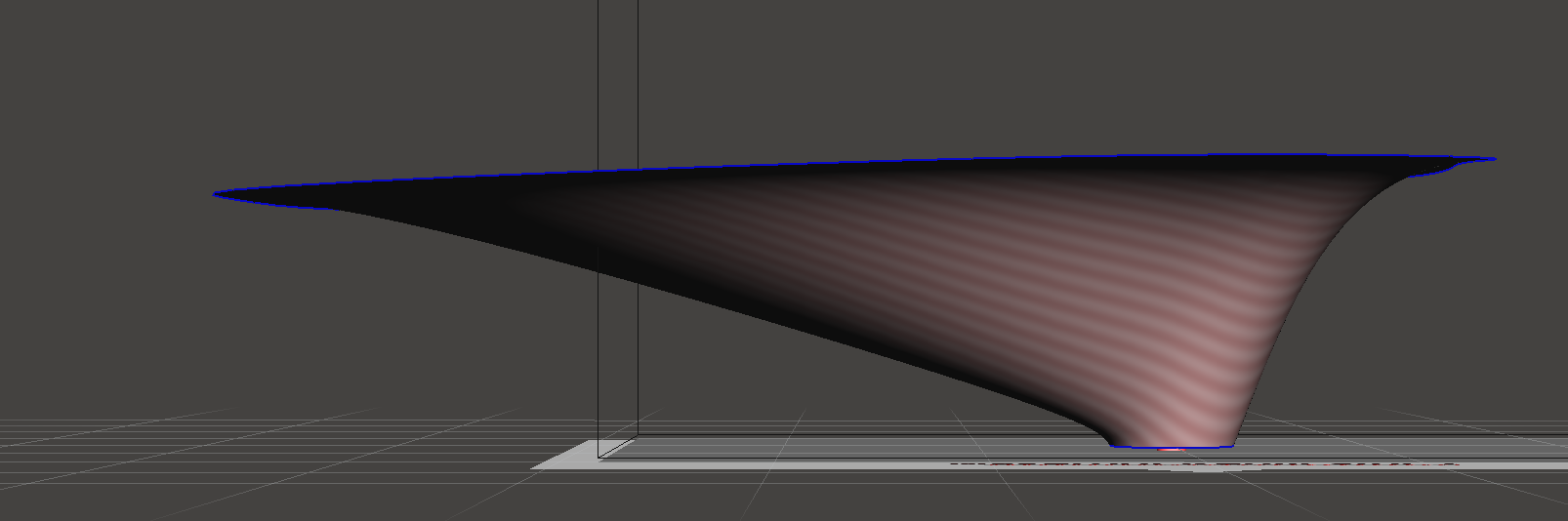

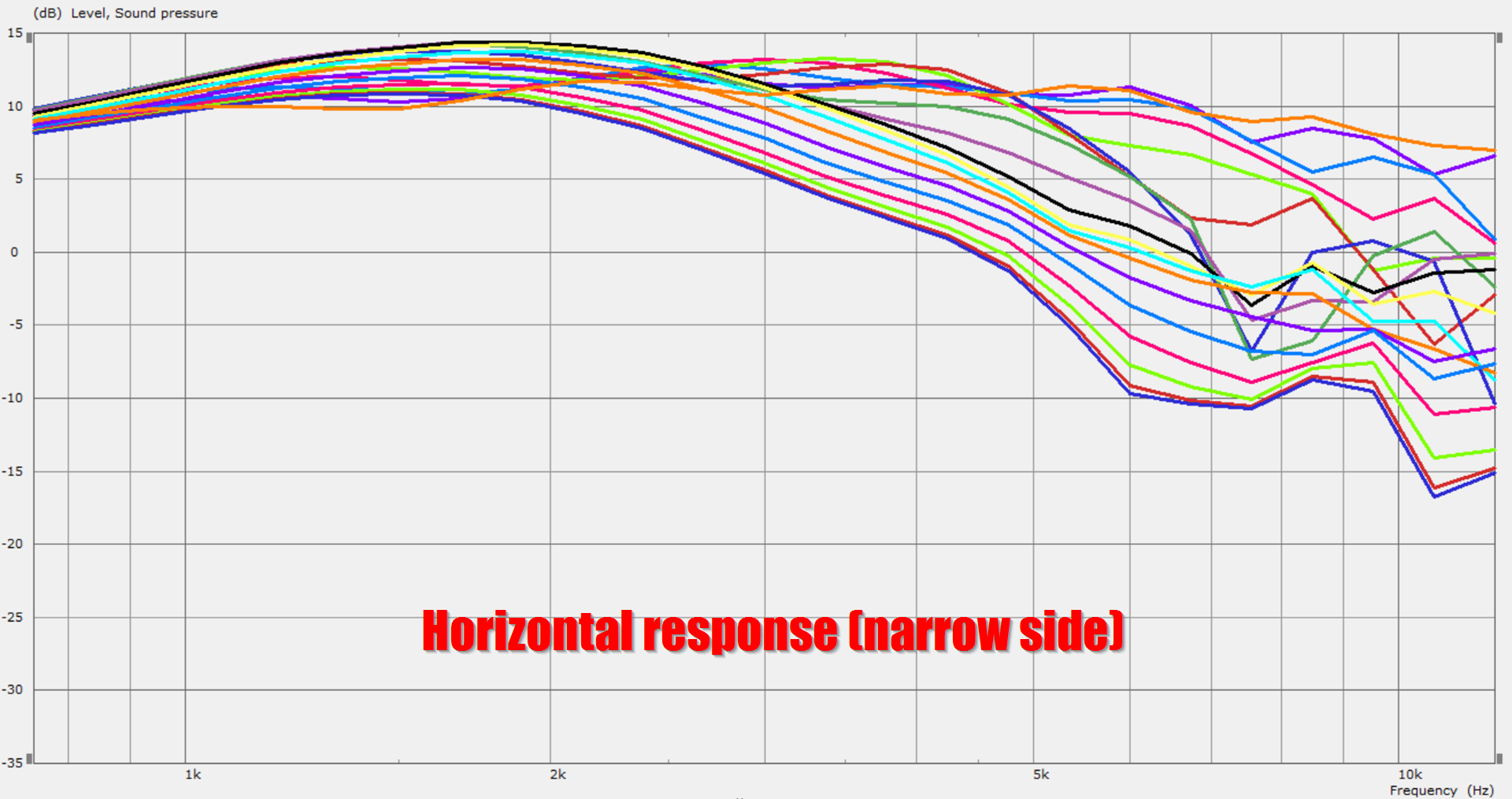

Here's how to make a waveguide that's "offset."
What I mean by this, is that it's louder on one axis than the other.
This can be useful for situations like:
1) underdash horns in a car, where you need a baffle that's flat but you need to direct the sound off-axis
2) home speakers where you can't rotate them. For instance, in-wall speakers and speakers that are too big/heavy to orient towards the listener. Or maybe that just looks bad.
3) If you rotate the waveguide by 90 degrees, you can use the directivity of the waveguide to reduce radiation into the floor

Attached are the horizontal sims to the left and to the right. Note that the waveguide is louder on one axis than the other.
