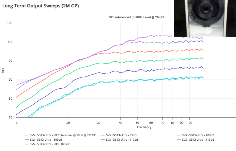

https://data-bass.com/systems/5bd0c4ea20120c00040a9bed
Josh Ricci has tested literally tons of subwoofers, other than the non-linear effects the speakers show due to excursion limitations, there do not seem to be any "saturation" effects that would be attributed to absorption non-linearity.
If you could tease any out, they would be inconsequential by comparison to the loudspeaker non-linearities, and transmission of interior reflected sound through the cone.

In the chart above, levels of 110dB at two meters would equate to 116dB at one meter, interior SPL would be in the 160dB range.

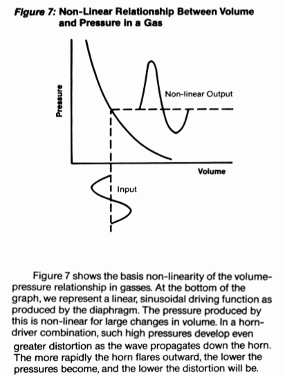

Air actually becomes non-linear at those levels, but the response outside the subwoofer cabinet does not reflect that problem.
In high frequency horns, the diaphragm and throat SPL may go well into the non-linear range, and result in waveform distortion, though the frequency response stays relatively consistent with SPL increase.

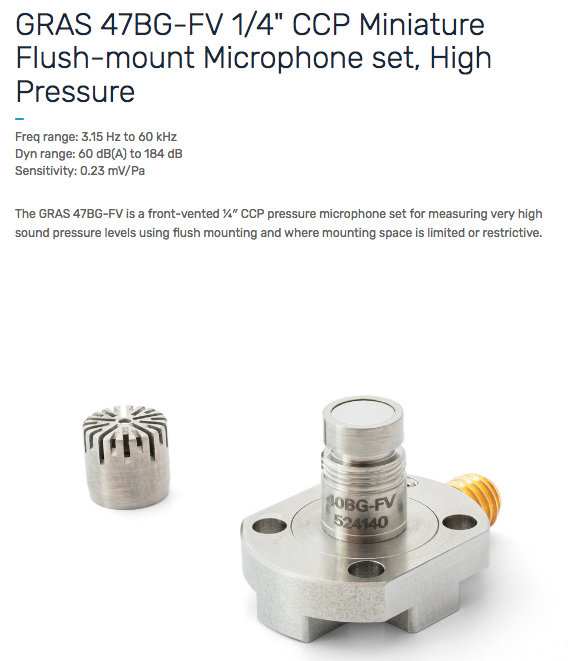

Mics that can handle 170dB SPL without (much..) distortion are quite expensive.
This GRAS 47BG-FV has a dynamic range of 60dB(A) to 184dB, though does not list it's distortion level..
