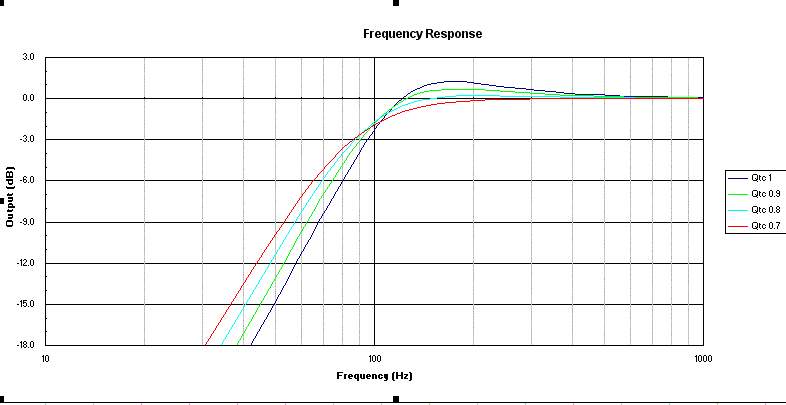

Adding stuffing effectivly makes the enclosure seem bigger to the driver, this results in a lower Qtc, meaning the response will be 'smoother' and more drawn out. Typically i have found i can get between 25% and 30% extra effective volume from stuffing.

Heres a pic of interest, its actually for a midrange cone, but the same trends still apply

On the graph the red line indicates the frequency response one would get with a larger box (i.e. by adding stuffing to an enclosure)
The dark blue line indicates the response of a smaller box, and the other lines are somewhere between the two
Notice that the red line shows higher output at lower frequencies, this is due to the extended, smoother 'curved bit.' As you add more stuffing/make the box bigger this curved bit extends more and more, and also becomes more smooth, giving you greater output at lower frequencies.....
However there is a catch (a few others too actually) Adding too much stuffing can have the opposite effect, making the enclosure smaller
I strongly suggest u do as much research on the topic as possible before you do anything, that link i gave earlier is a good starting point. (Toying with the sealed.xls file avalible from that site might help clear things up a little)
