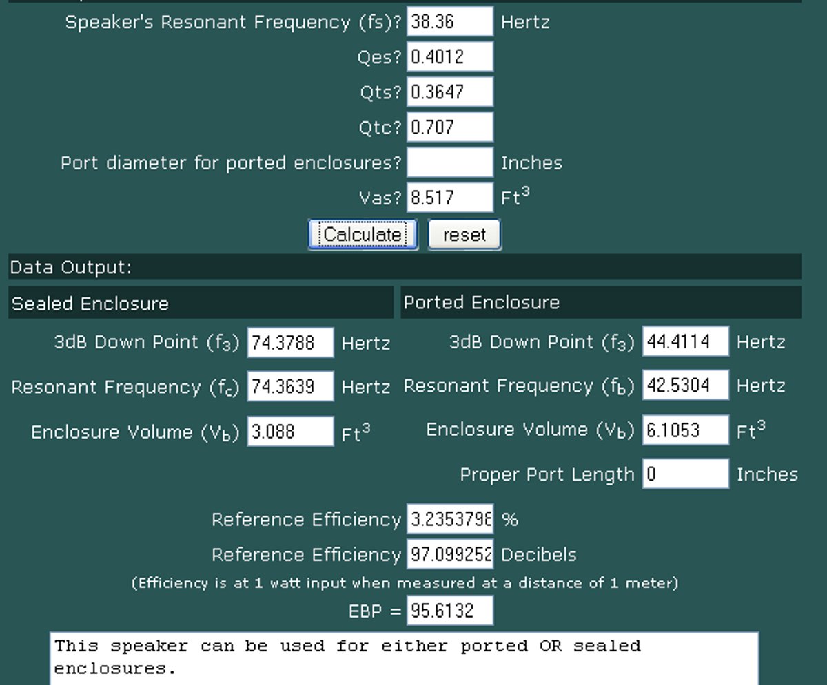

I'm in the process of revamping a pair of old speakers that have both undersized boxes and inadequate damping ( 2" of FG along the backwall).
It's an uber-compact system, with a 15" woofer in a small 1.5 cuft sealed box
The results from an online calculator (using WT3 data from the free woofer, and a preferred .707 Qtc) called for a 3.0 cuft sealed box, without stuffing.
Speaker Box Calculations
Since I'll be re-using the boxes (Qtc .98), a Qtc of .707 will be difficult if not impossible.
So far, to deaden some resonances, I've lined the sides and backwall with some self-adhesive vinyl roof flashing.

For increasing the apparent volume and lowering the Qtc, I've ordered some BL cotton, which I'll test and report back on here. I really don't want to use FG if I can help it, but in this situation I might just have to if the cotton is insufficient.

You should order new drivers suitable to the box. You are not going to get more than the equivalent of 10%.

You might want to consider an aperiodic enclosure type for your loudspeaker. It can be useful if your goal is to lower the effective Qtc of the system.

I just had dinner with my attorneys and they said I should never settle for small amounts. Didn't your test result in an undersized box going from Qtc 1.11 down to 0.77 via the use of FG ? WTF, my attorneys might be contacting you 😀

Yes that's one of my goals.
