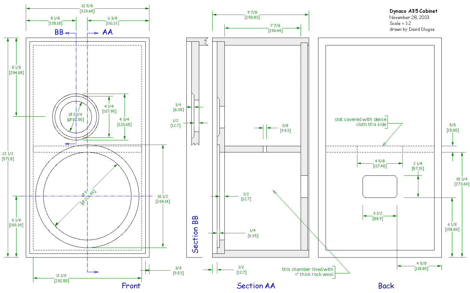

A question that comes to mind: can an aperiodic vent be made by drilling small holes in the woodwork? I've placed a solid wooden plate over the former bass reflex port.
Then, I could easily make the aperiodic vent by drilling very small holes.. Any thoughts?

Yes, you definitely can, many examples in the past.
Do a search here at DIYAudio for "aperiodic" and you'll find a lot of info, some from Planet10, some from others.
To be most effective an aperiodic vent's Sd should be as a minimum 1/3 to 1/2 the Sd of the driver.
Have a look at some of the files below and also the links suggested by puppet.
What do you mean with the Sd, are you refering to the surface area?
