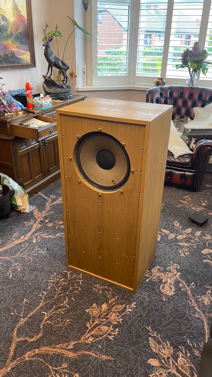

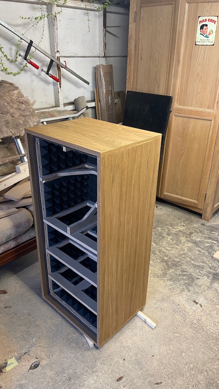

I’m going round in circles so looking for some direct advice.
I’ve built 160L sealed cabinets for 15” Tannoy Monitor Golds. Initially they have simply been lined with butyl rubber sound deadening and open cell acoustic foam, but the measured bass response is a little all over the place, some of which is caused by the room but some I feel may be caused by the lack of stuffing.

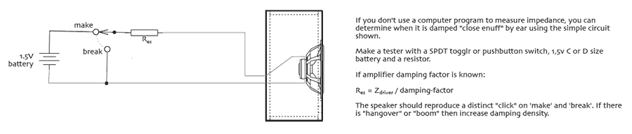

160 liter is a big cabinet, so even with the foam lining the walls, there is a lot of empty air in there... you could definitely have some acoustic resonances (standing wave).
Rock wool is a low cost but very effective damping material. Shredded denim is another very good material. I would fill the cabinet 50% with either rock wool or shredded denim, and see if things improve. A 50% fill should not affect the bass response (Qtc), but it should significantly reduce any standing wave resonances, assuming that is an issue for you. If you notice no change, then standing wave resonances were not the cause of your bass response problems. If you notice a nice improvement, you can experiment with more or less of the fill material.

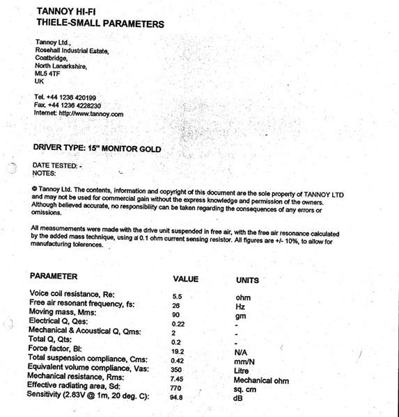

Yeah, is ~60 L too big for a max flat (0.707 Qtc) sealed based on the attached published specs unless driven with a high output impedance, so currently at a presumed over-damped ~0.457 Qtc based on this math, ergo ideally shrink net volume (Vb).I’ve built 160L sealed cabinets for 15” Tannoy Monitor Golds...... I feel may be caused by the lack of stuffing.

Regardless, either way, increasing damping is going in the wrong direction, instead you want to quell its eigenmodes, so historically heavily damped one side, top, back and only add more if it sounds 'hollow' and/or 'rings', which can be tested using the pioneer's simple 'click' test.
clarification: about 2-3” away from walls/driver magnet/ port but filling the rest of the space except about 1” from port entrance and the area near the baffle/driver2. Suspend the rock wool in the cabinet - not letting it near the walls or driver,
Also, bass reflex/shelf and sealed around walls/driver/port will make the biggest difference.
As GM says, adding damping material increases the apparent volume of the cabinet, thereby lowering the Q even further. That driver in that size box definitely needs porting. It’s a wonderful driver combo so go back to the books and determine the right size port.
well, yes, but that does not really start to happen until the cabinet is completely full of stuffing. On a sealed box, the stuffing must be compressed in order to start the process of increasing apparent volume.As GM says, adding damping material increases the apparent volume of the cabinet, thereby lowering the Q even further.
With a typical 40 liter box, if you line the walls with 4 inch of insulation, you have effectively filled the enclosure to 50% capacity with stuffing. With the OP's 160 liter box, lining the walls with 4" is almost insignificant. That is why I suggested he fill to 50%.
He complained the measured bass was "all over the place", not that it was weak. Of course it is somewhat weak, anytime a woofer with Qts of 0.22 is put in a sealed box the bass is going to be weak. I assume he will EQ it to be more flat, or as he says, add a BR port later. But for now, he wants to address the bass which is "all over the place", which to me suggests he has a standing wave resonance issue.
So I stand by my advice. Fill the box with 50% fill of something affordable like rock wool. For $15 he can see if this helps his problem.

OK, a 4" dia. x 6.62" vent tunes it to ~Fs based on just lined as I suggested and handles all 50 W rating at acceptable vent mach; don't know about with stuffing since never ported a basic BR, though cab looks to be at least 36" i.d. tall, so best to put the vent down low and maybe need to shorten it a bit.

You for sure NEED dampening in the cabinet. A closed volume makes it way easier cause you can just stuff it with e.g. sheep wool or similar material. Important is to get material in the middle of the volume to get rid of the main reosnance! (and that's one of the problems of ported - when you do that you loose your efficiency. So some resonances are left)
To really nail this you need to measure nearfield response of the woofer and/or impedance. You see cabinet resonances there, dampen until they are gone.

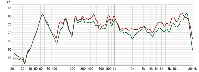

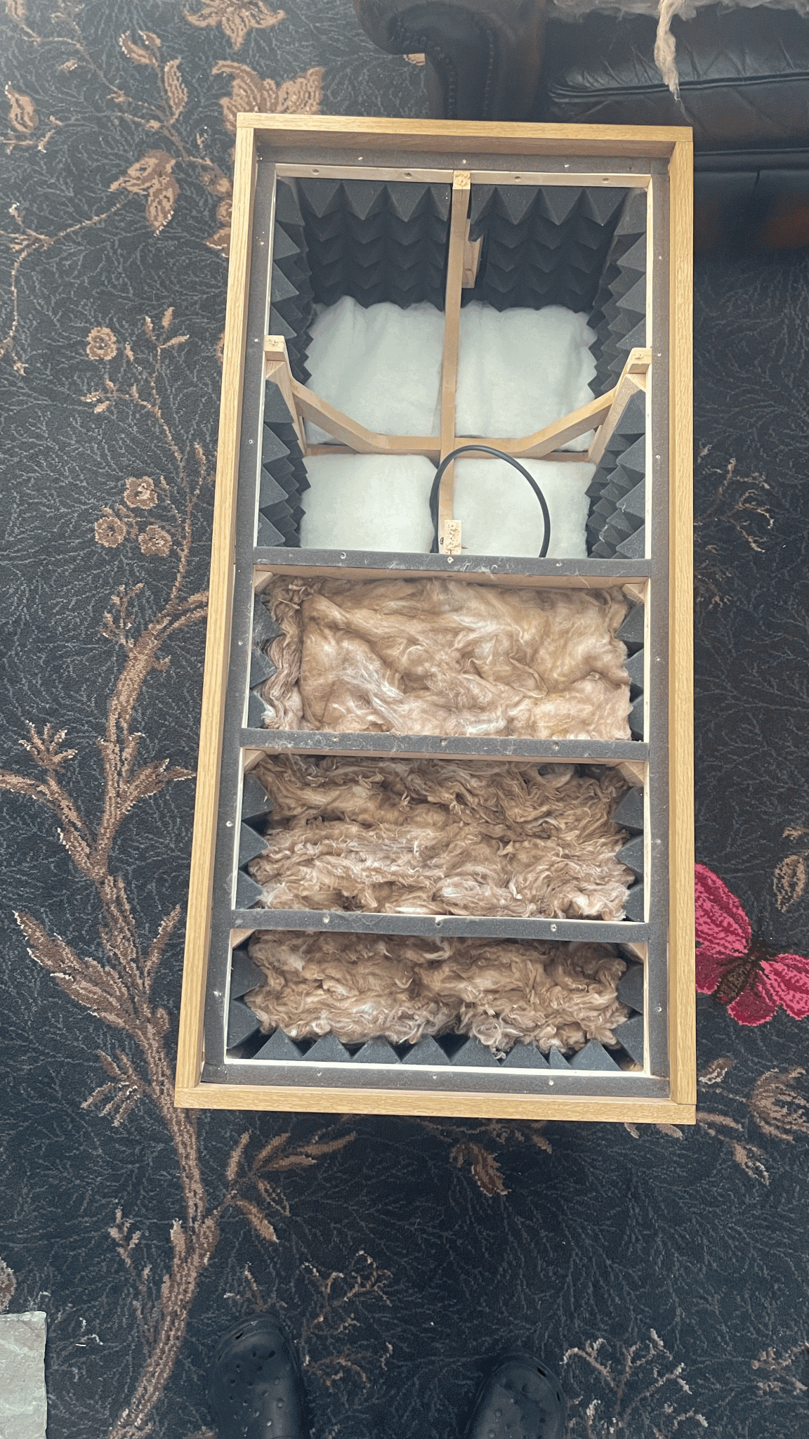

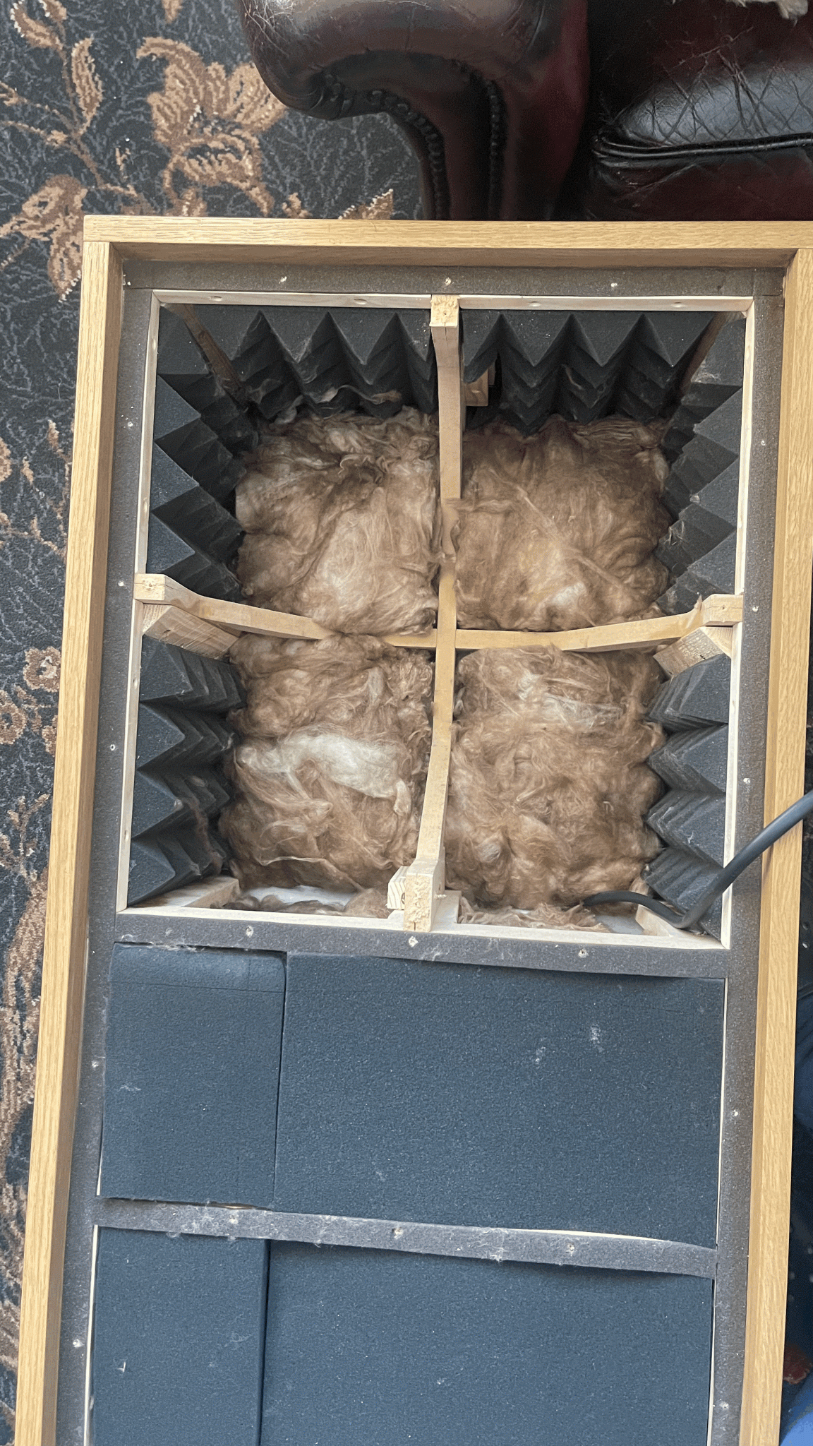

Ok, I just did some playing around and stuffed 1 cabinet and measured at 1m using REW:
Green is un-stuffed.
Red is stuffed like this:
You can clearly see the room modes up to 200hz, I may add a little more behind the driver and go again.
