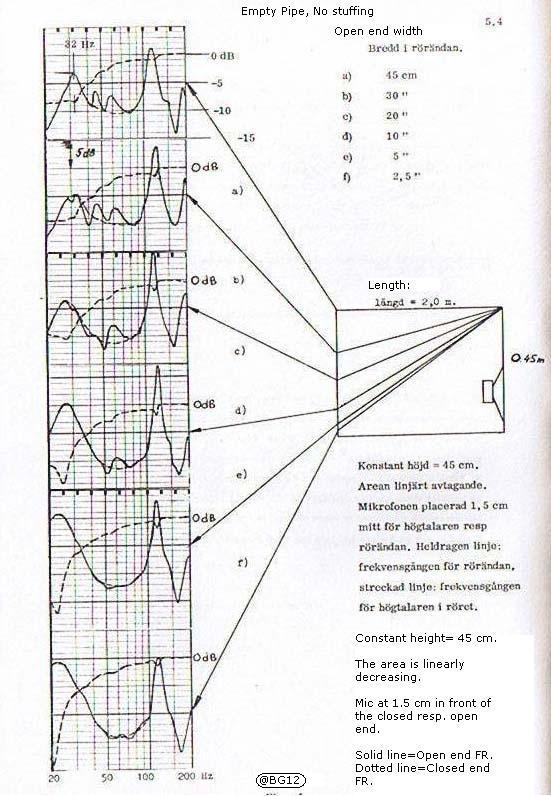

Anyone know what happens when you stuff a tapped horn, ala transmission line? I have no simulation program (doubt that would tell me anyway) so I am asking if anyone has done this and if so what was the result? Just curious. Thanks

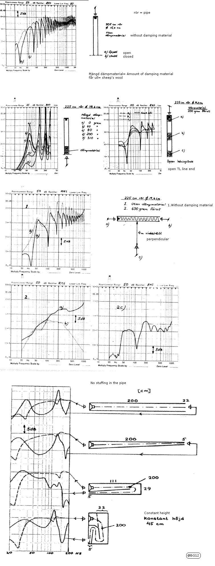

I have posted numerous TL/ T-TQWT(~an inverted TH) simulations and of course built a lot of them(>a hundred) in more than 45 years.I'm away for a day or two but if you have a more specific question : I will answer a.s.a.p.
