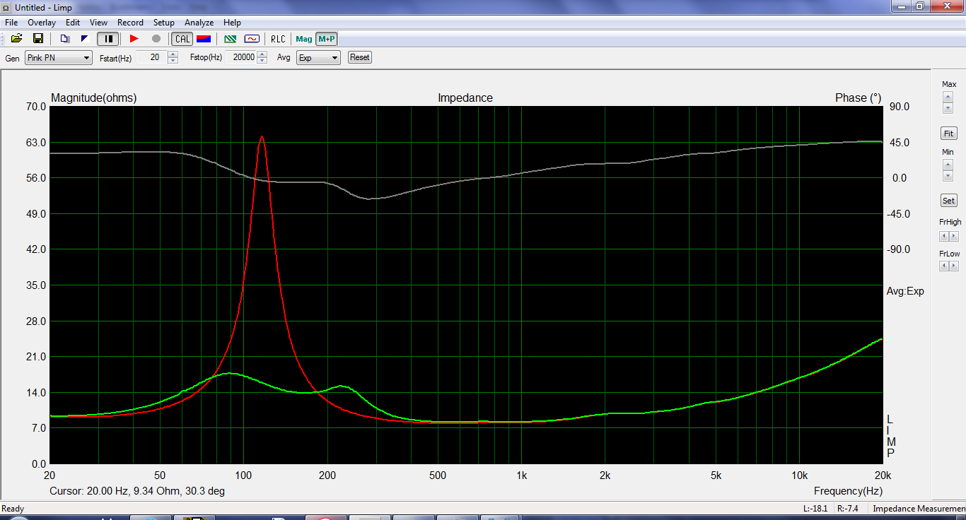

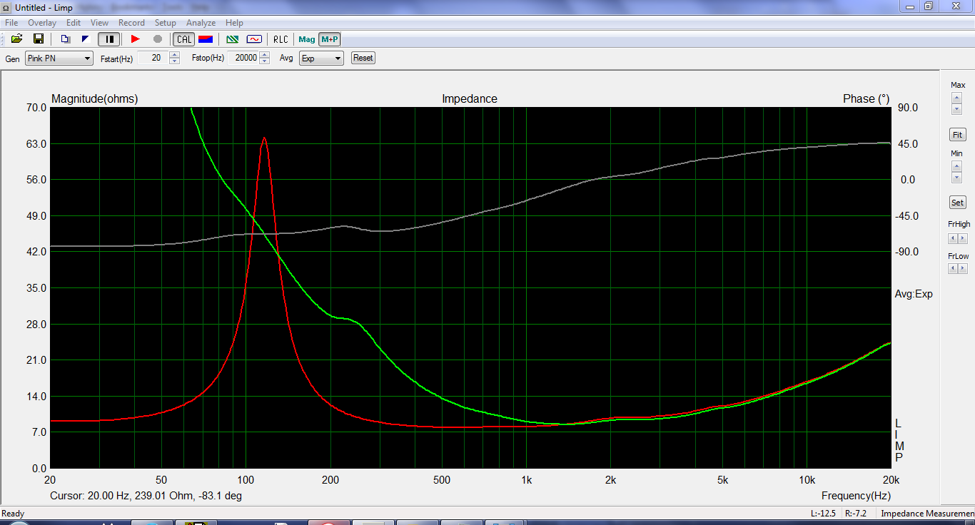

As a semi-offshoot of this thread, I did some quick testing on using stuffed "TL" tubes for drivers meant to be high-passed above a midbass.
Test mule was FF85WK, a rather likely suspect for such an application. I first decided to test it's free-air T/S parameters in LIMP. Here is the result for one driver only:

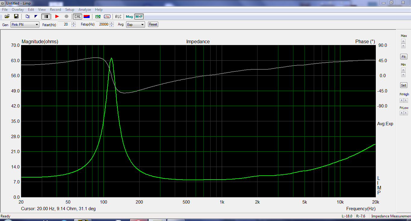

Loudspeaker parameters:
Fs = 115.89 Hz
Re = 7.50 ohms[dc]
Le = 154.52 uH
L2 = 144.24 uH
R2 = 4.41 ohms
Qt = 0.60
Qes = 0.68
Qms = 5.10
Mms = 1.98 grams
Rms = 0.292124 kg/s
Cms = 0.000946 m/N
Vas = 1.04 liters
Sd= 27.99 cm^2
Bl = 4.063108 Tm
ETA = 0.24 %
Lp(2.83V/1m) = 86.16 dB
Added Mass Method:
Added mass = 10.00 grams
Diameter= 5.97 cm
Holy crap! How close this is to factory data! 😱 Qms is a tad higher but most of the rest is quite close. Feels satisfying to get these kinds of results once in a while. 🙂

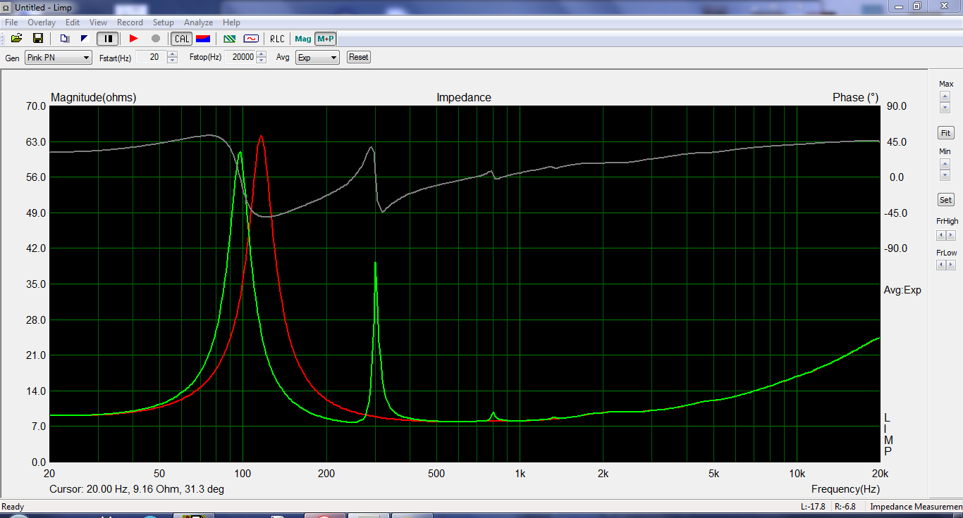

For a tube, I had some unused Precision Port mid-secions laying around. 3" internal diameter, 12" long. Fits right over the plastic bezel on FF85WK, with a bit of blu-tak to seal things up good. Here's the empty tube:
Tunes about where it should. Let's try a bit of polyfill in there, loosely packed in most of the length:

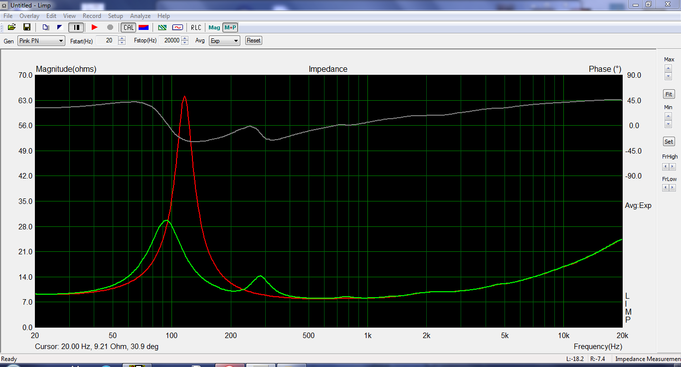

Now let's pack it real good in there: 🙂
Good improvement! On my first try, I had flatter Z and some fuzz on the trace. I figured the polyfill tried to expand and mechanically hindered cone motion. I packed the same amount (24g) of polyfill into a wool sock and could now control the depth to avoid the issue.
Perhaps a 3" tube is a bit small to load on the back of FF85WK in a real application, it would not even leave room for a good chamfer. It's what I had handy and still learned something from it. Hope it can be of use to others, so I'm sharing this here. 12" is also a bit long for my application at least, so a tapper would help as suggested by P10, or perhaps even a bit of mass-loading on a shorter straight tube?

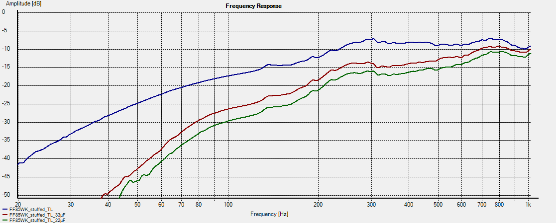

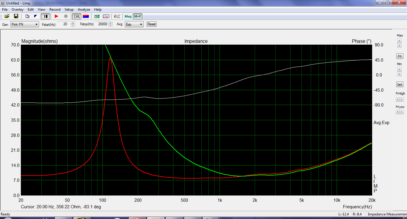

Impedance with stuffed TL, 24g of polyfill and...
22µF series capacitor:
33µF series capacitor:
Resulting near-cone response (back of the cone):
Blue: no Xover
Red: 33µF capacitor
Green: 22µF capacitor
There still appears to be a tad of interaction with the impedance peak above 200Hz, but nothing seemingly too serious.

Regarding the first post's plots for "naked tube" --> "light stuffing" --> "heavy stuffing", we can see that, in addition to damping of the impedance, the tuning minima shifts down respectively from ~250Hz to ~200Hz to ~175Hz. Would this be the supposed, effective "slowing down" of the the speed of sound in a resistive material?
Correct, though it's my understanding that it doesn't slow down, it just takes more time to traverse the pipe since the stuffing makes it acoustically longer. Overall, it looks like the pipe is still much too short percentage wise and depending on the performance goals, anywhere from not small enough to nearly an order of magnitude too small a net Vb.

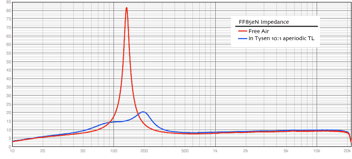

Good IG81. Here is the impedance we gotwith Tysen (FF85k in short 10:1 line)
dave
I caught that one in the Tysen thread. Looks like I got ~ballpark tuning and Z magnitude with my stuffed straight line.
