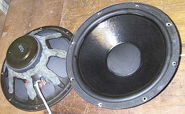

One more "big" benefit of puzzlecoat -- it makes the driver cone shiny (even the matte stuff, but to a lessor extent).
The pic is some 12" Philips (note: the ductseal on the basket i do not consider optional -- i have yet to find a speaker that doesn't benefit from it (althou i have seen some where it would be difficulat to apply (ie the PHY-HP))).
Two things i didn't mention in my previous post... 3 coats front & back on a woofer is enuff to lower Fs & sensitivity, And another treatment i've seen but not tried is the application of a layer of metal foil (aluminum in the example i've seen -- but i've talked to an artist friend who says there are quite a few other possibilities -- gold leaf anyone?).
