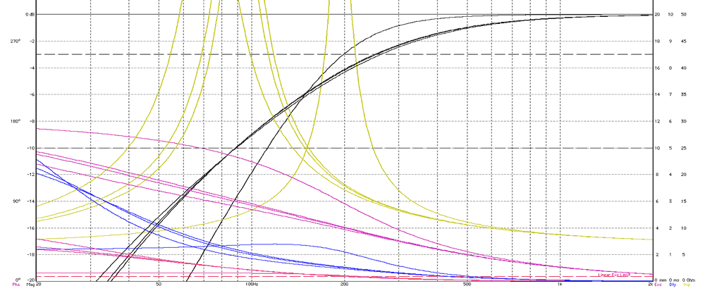

The cabinets are for an ADS L400 and the inside dimensions are 16 1/2 x 8 1/2 x 7. There is a 6" woofer hole to insert any number of pieces of 2x4 lumber to reduce the interior dimensions and stiffen the cab. I'm pulling the table saw out tomorrow and cut up some pieces if I really need to, but the L400 box is actually quite nice. I could also just cut out the front baffle (where drivers are mounted) entirely and leave a lip to mount a new front baffle from the inside reducing the 7" depth to 5.65" and get about 13L.
If you remove the baffle i'm guessing the attached could be folded into that box.

And at least an internal divider to define the line... you will be folding the design i posted.
dave
No. I'm going to go ahead and build it as drawn, though if you can fold it into a shorter height, that would be ideal. I can probably drum something up in Autocad, but you seem to like doing this type of stuff...

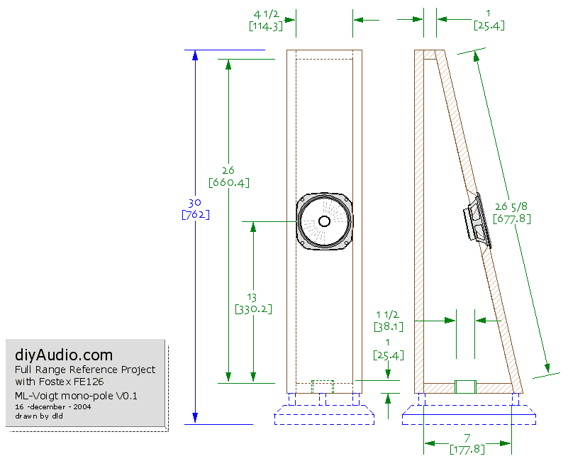

There's the Voigt pipes, that I'm building.
http://www.diyaudio.com/forums/atta...-reference-project-diyref-fe126e-ml-voigt.gif
Nice and small, I heard them at a meet, and it was fantastic.
Does it matter where the driver is mounted along the pipe? Can I mount it just north of the "80 degree" note so as to not have to notch the interior divider?
If the designer has done his homework, then you will have to place the driver as designed. Otherwise you will have a lot of trouble with the third harmonic.
Bob
As Bob has already mentioned, but worth emphasizing. Yes it matters where the driver is placed along the pipe. Its placement mostly kills the 1st objectionable pipe harmonic, allowing less damping and subsequently more bass.
