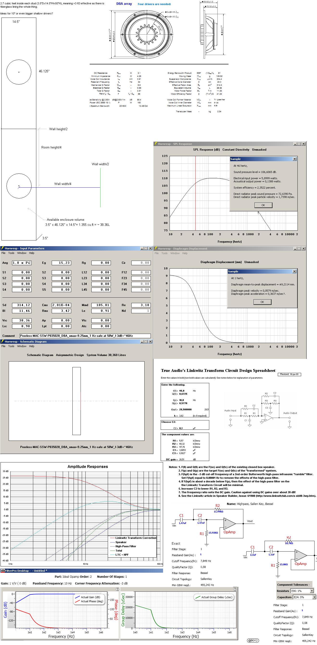

FYI: A DBA using 4 of the Peerless-MAC-SSW-P835028 drivers and a suitable LT and HPF to set the lower FR boundary:
b
Ah, thanks, now that's interesting. But I should have specified that the woofers need to go at the bottom of the 3 stud cavities because the TV is above that. What happens in that case, if there are 3 of those each in the 3+ cubic feet?
