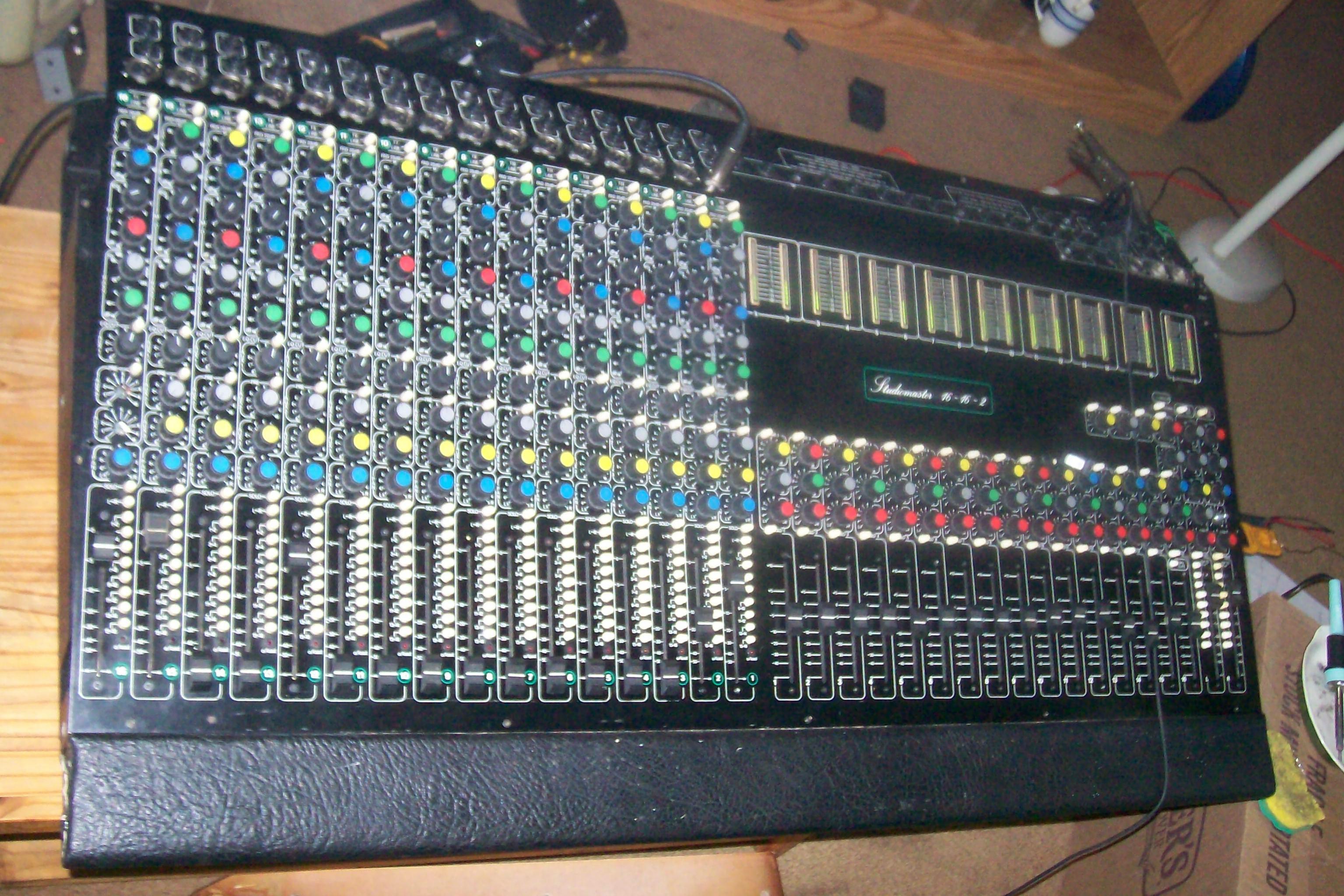

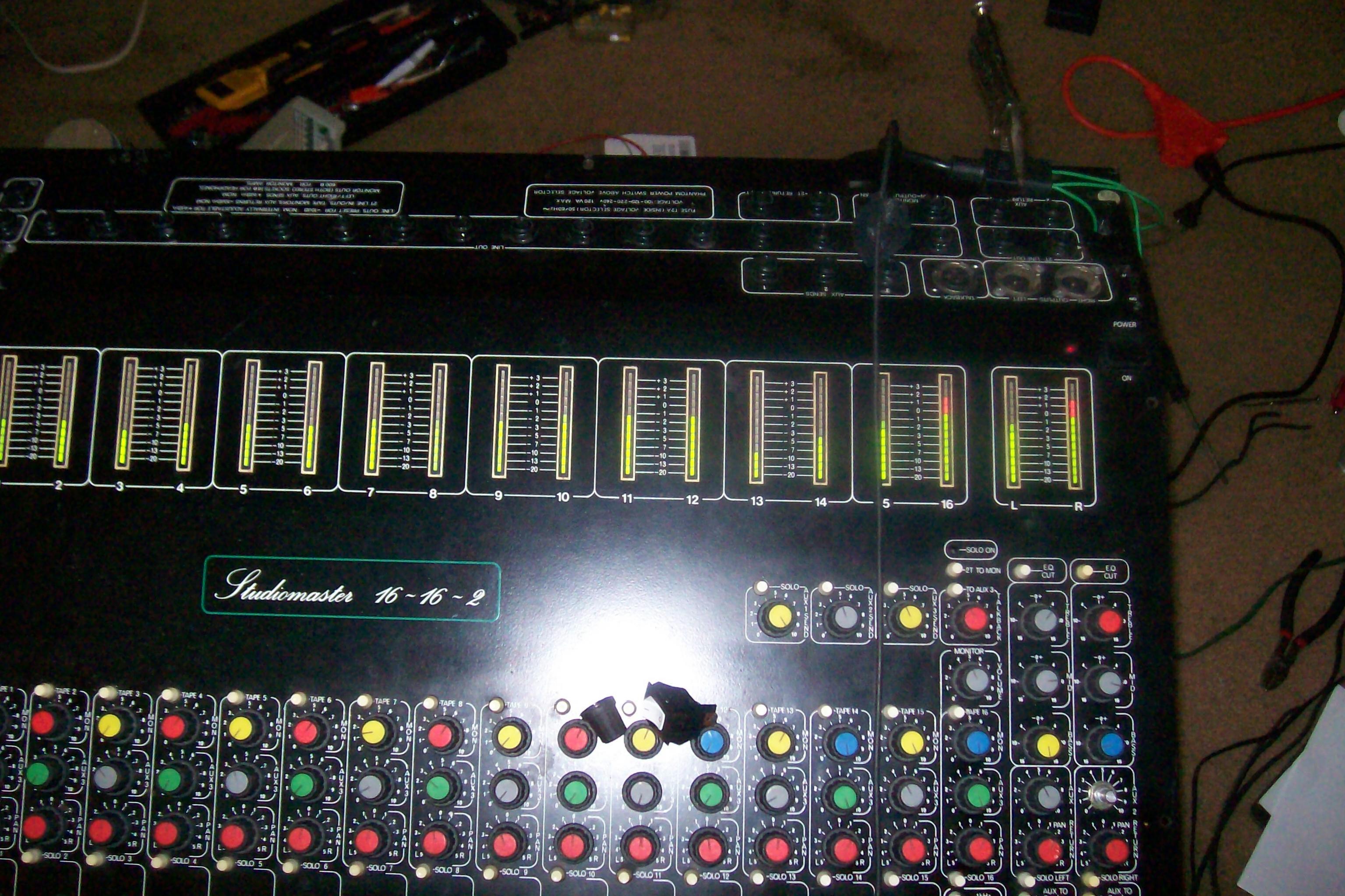

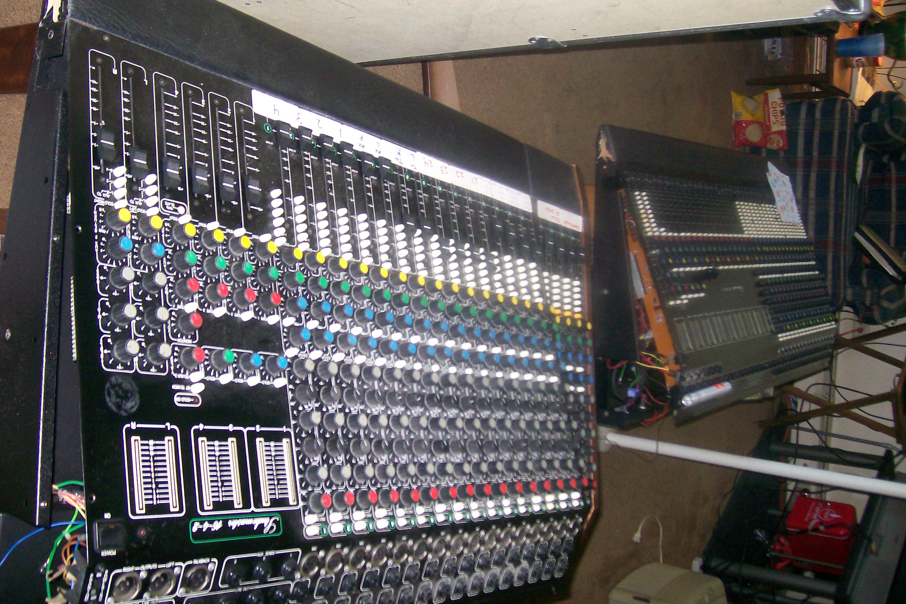

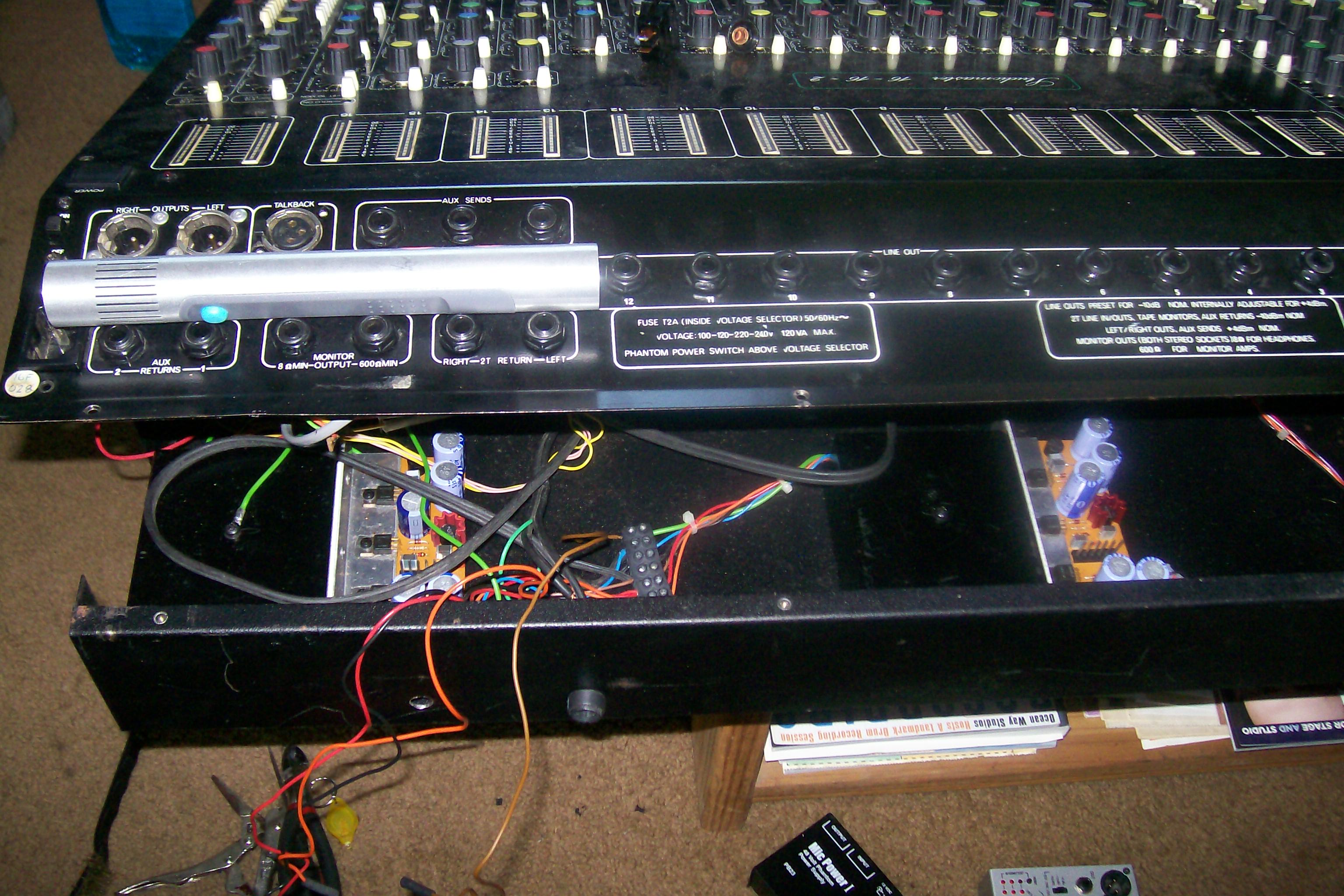

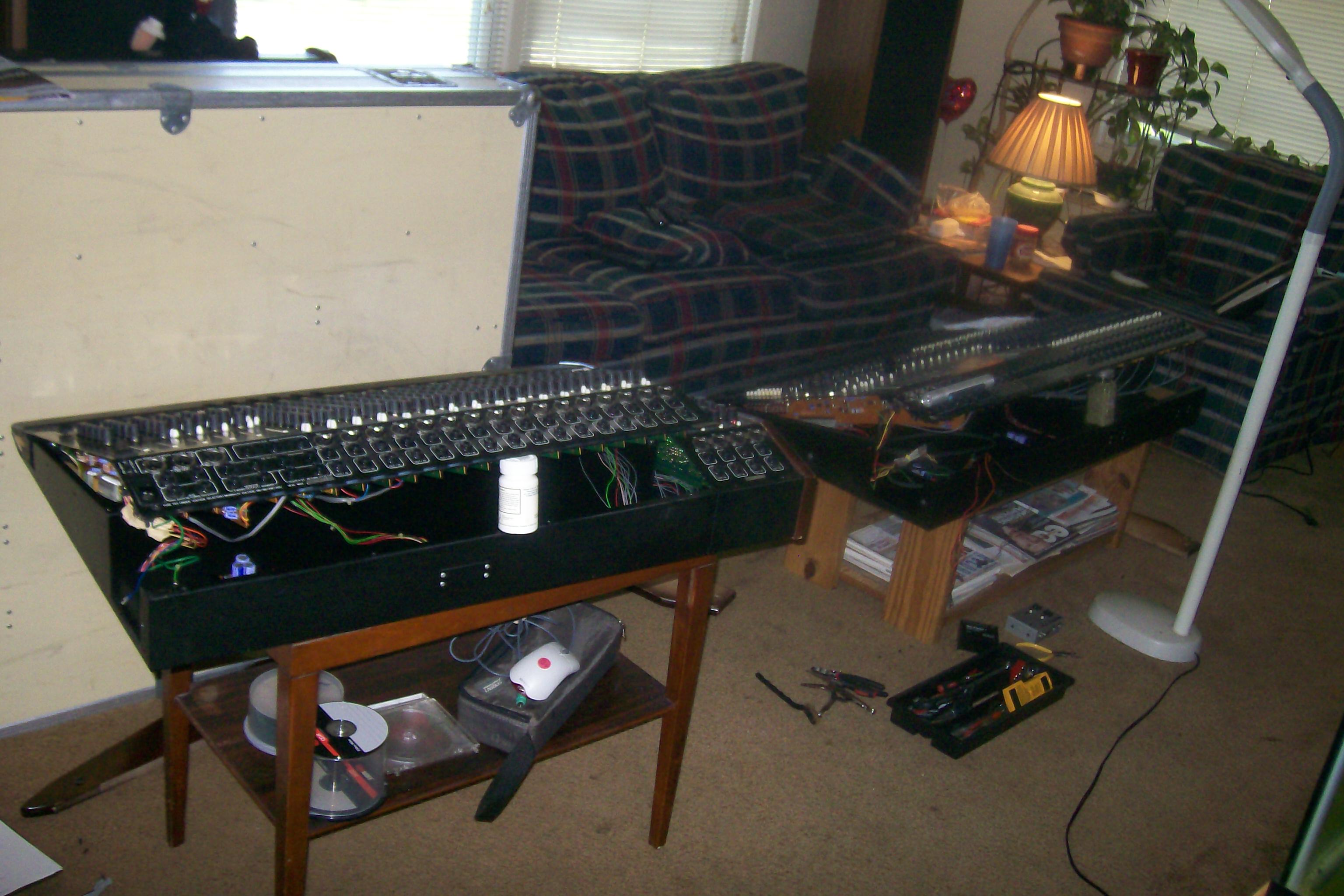

Well I'm including some pics so maybe someone has mercy on me (lol). They are of both my Studiomaster 16-4-2 (working) and the new Studiomaster 16-16-2 (not working) Arrrrrr....

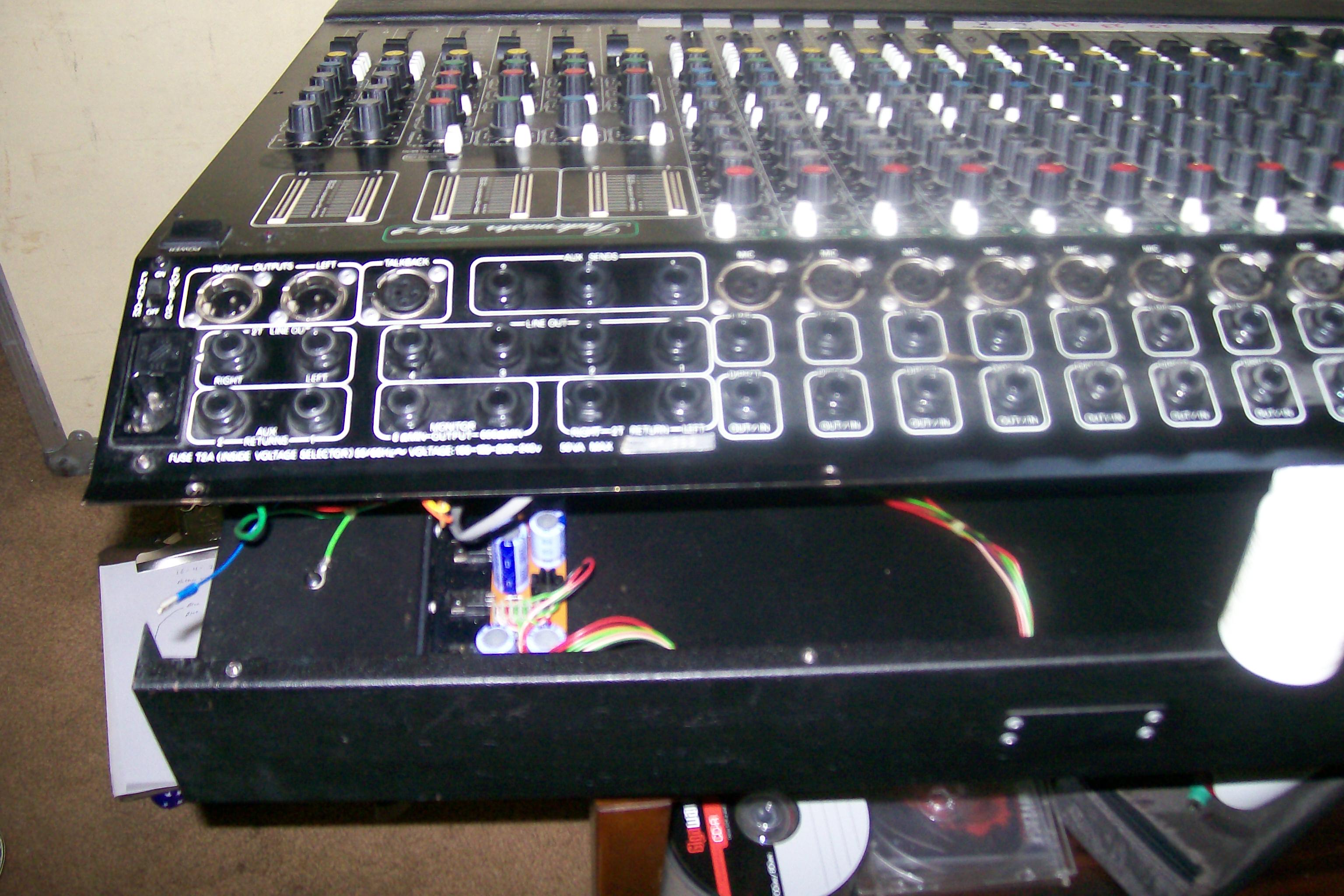

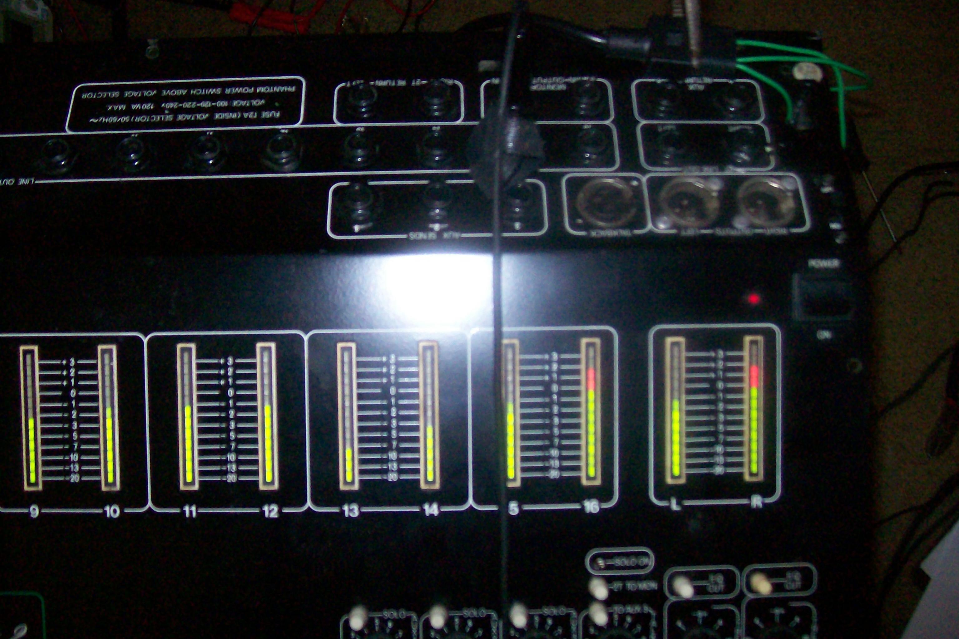

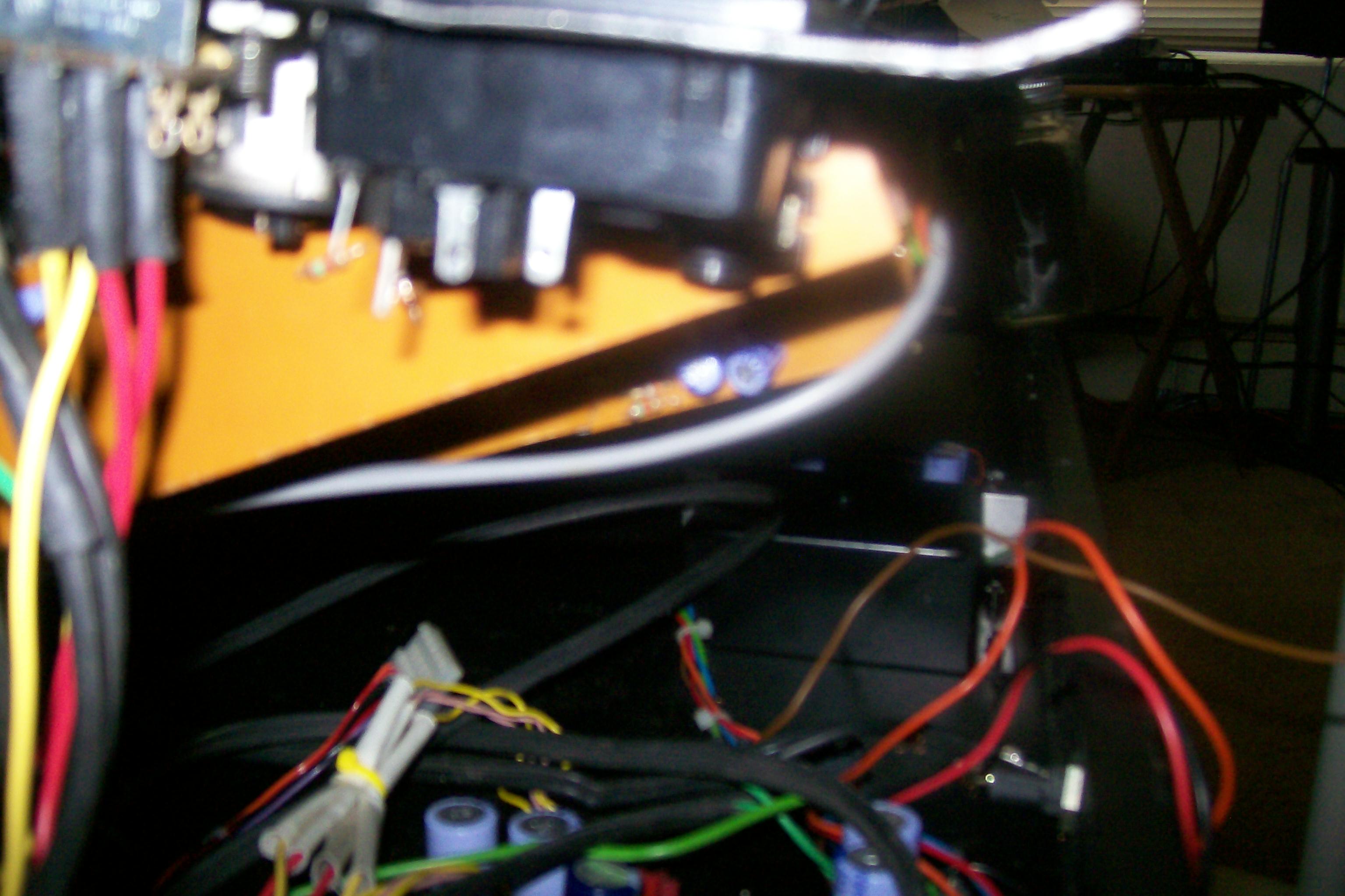

Got it working W/one board disconnected

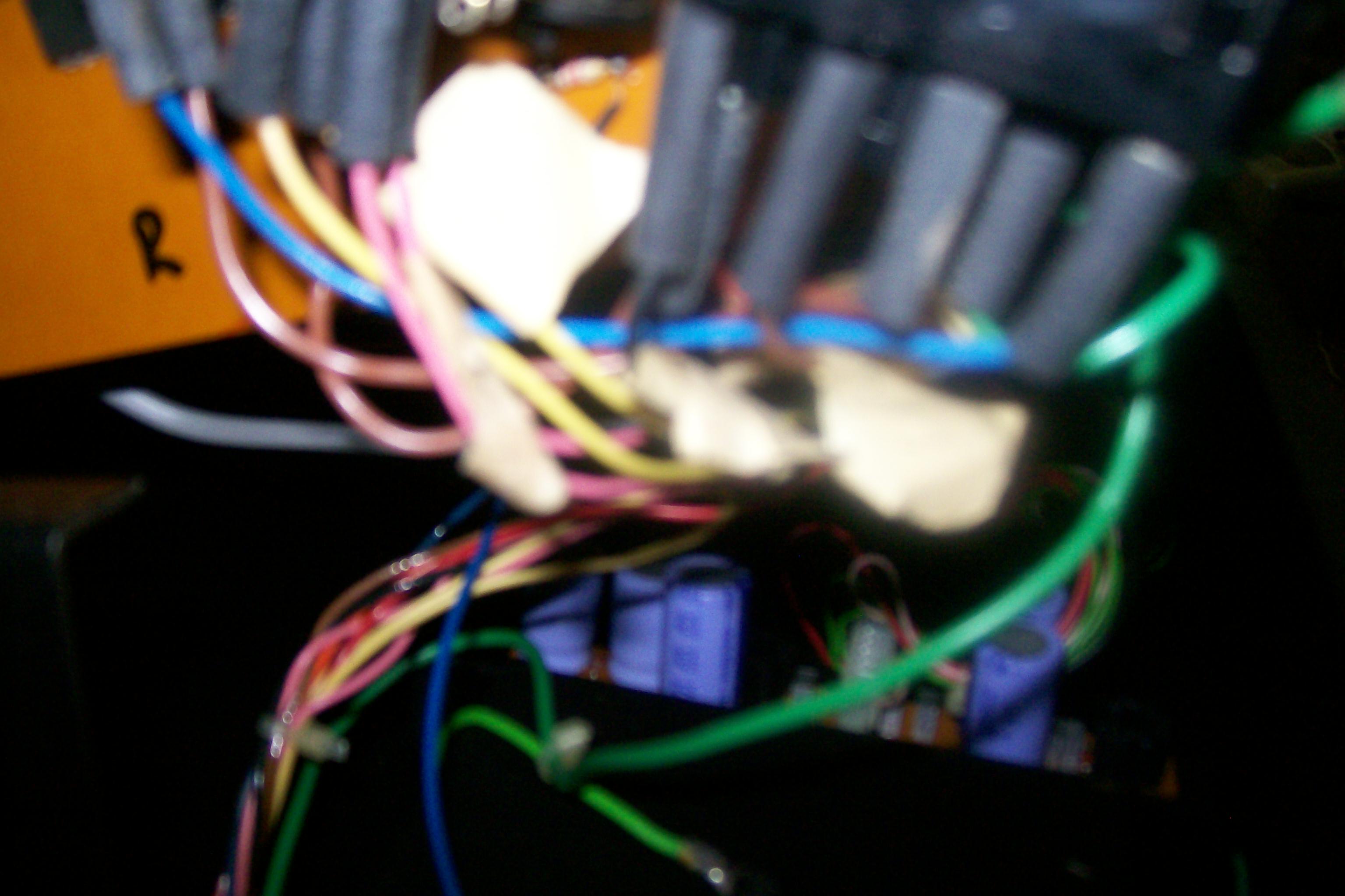

Well folks i got the Monster working, using my 16-4-2 and the schematic from a simular studiomaster boards p/s. Check out the pictures of the power cable vice-gripped to the board (Too Funny). BTW i don't recommend anyone doing this its very dangerous, and was only for the test.After i power the board up, the real problem appeared, channel #6 has a fried (burnt & cracked) Portugal TLO72 CP 319XB chip. So i disconnected board#6, and powered up the unit again, and after being on and testing all the channels for about 20 minutes. Its working again.
So now i will need to replace the TLO72, and start checking all the other parts on the board.My guess is a couple of bad caps and or ressistors.

Ok so board #6 is fixed #15 fader was installed backwards (Fixed). And now all the L.E.D's are disconnected, and let me tee you folks, there a pain to get to. Ive included a pic of board #6 befor the fix. Digikey part#296-1775-5-ND. Enjoy...
