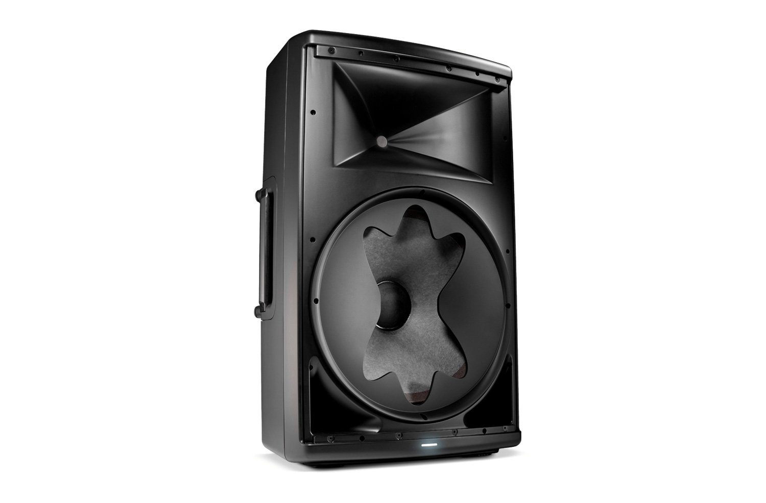

A frontplate with aperture like JBL EON is different from "slot loading" I guess? Where's the turning point? https://jblpro.com/products/eon615
Well, I'd regard this still as kind of slot-loading, as it has an effect on the woofers directivity and is intended to do so. I did not simulate this one, but I think the curvature of the 'slot' deals with the cavity resonances, i.e. minimizes them because of the curved shape of the 'slot'.
I'm sure the 'Karlson-slot' will broaden the directivity of the woofer as well.
Though these are not real slots in terms of a rectangular form, they still do the same in terms of modulting woofer directvity.
Yeah I bet that the shape of the slot in that JBL is varied to kind of distribute any i'll effects, for example cavity resonances. This would make the graphs little bit smoother looking, just like offsetting drivers to mellow out baffle diffraction related interference. I think they added the slot to have better match around crossover directivity wise both horizontal and vertical. Obviously, if this was some magic pill we would have slots on most speakers. It's fun try and think why they did that there and not with other products? anyone?🙂 Perhaps too subtle effect before trade-offs and not worth it.

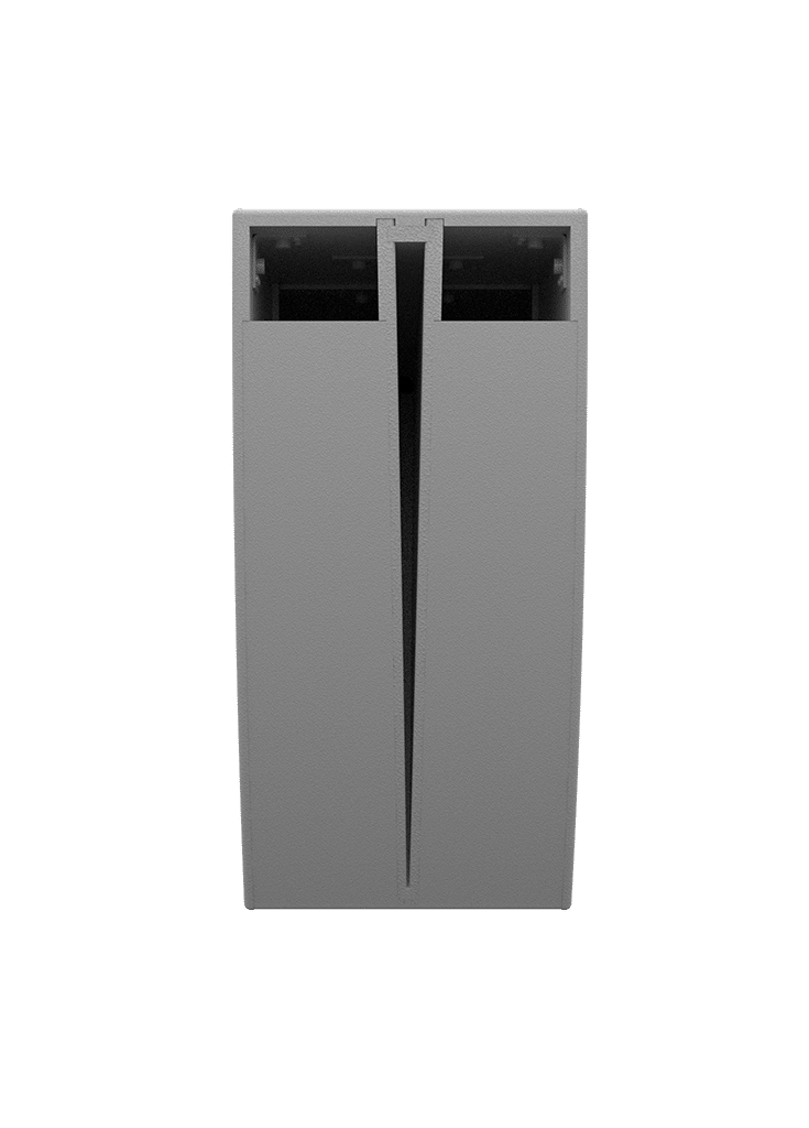

here's an unusual slot loaded design, made to mount on the wall up against the ceiling.
https://www.danleysoundlabs.com/products/sf1/
A good example where simple VituixCAD simulation falls apart 😀 Horizontal directivity is likely close, but vertical likely doesn't as it ignores the whole long waveguide that is inside the real device, transducer is smaller than the aperture in vertical plane. Also any resonances that likely happen, some sound reflects back to throat 🙂

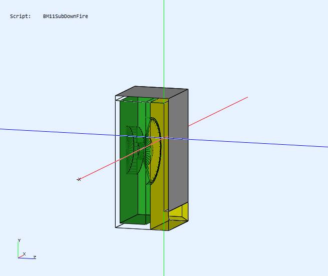

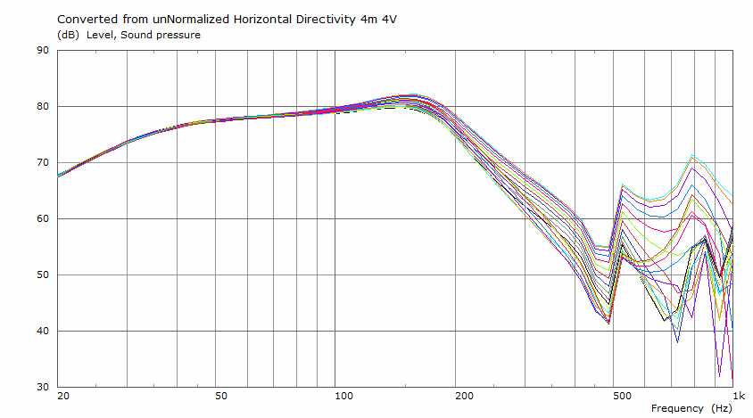

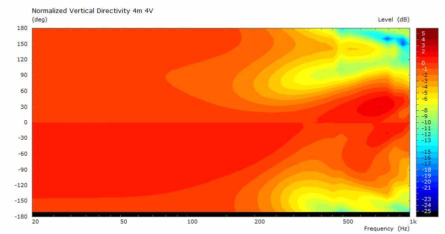

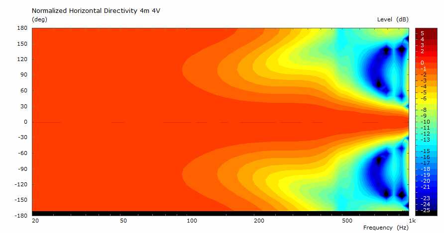

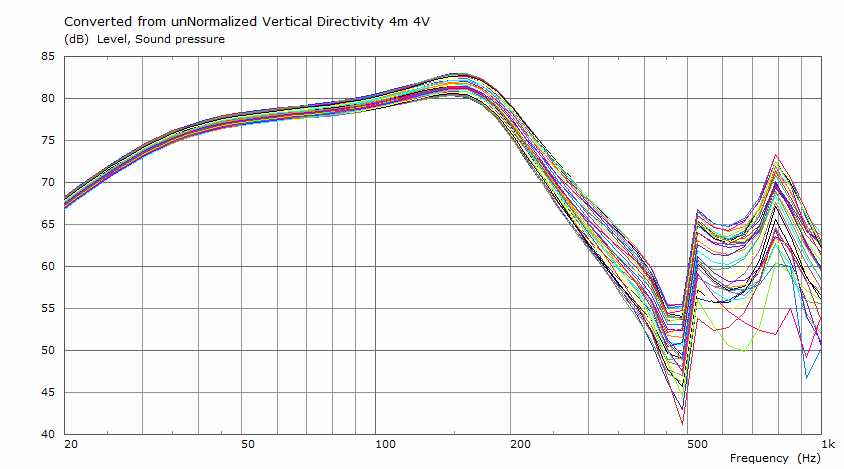

Here are some images of a slot loaded woofer I did some time ago. I was still learning abec and put the slot on the front mainly due to lack of skill with abec but it turned out to be quite good even without moving the driver closer to the slot exit and closing off the back, so I didn't bother
next, the polar maps (normalized)
the curves show its usable at least to 200 Hz
The driver is a Stereo Integrity 11" shallow mount subwoofer. Intended usage is to lay flat under an OB woofer and play through an end slot out the front.

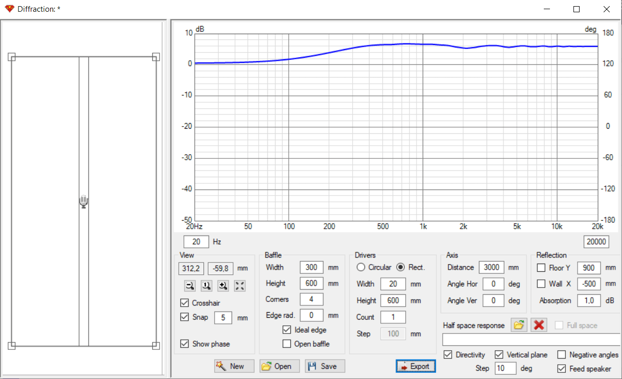

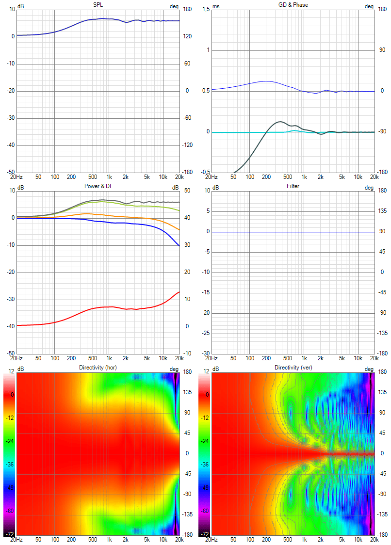

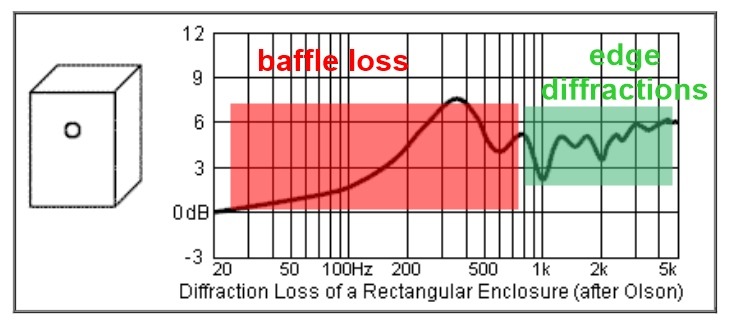

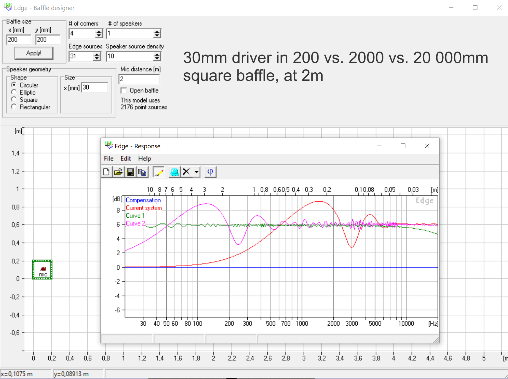

Loading or loss is semantics... baffle step is good example. If we agree that infinite baffle is the norm, all smaller baffles show 6dB loss of spl down low and 2-3dB step/loading just below first diffraction nulling. Slot loading is similar as well as horn loading - extra spl at certain range and loss above and below it (compared to infinite baffle) - bandpass filtering
Acoustic low pass could be used to benefit, perhaps could help with c-c spacing as in MEH and perhaps something else 🙂

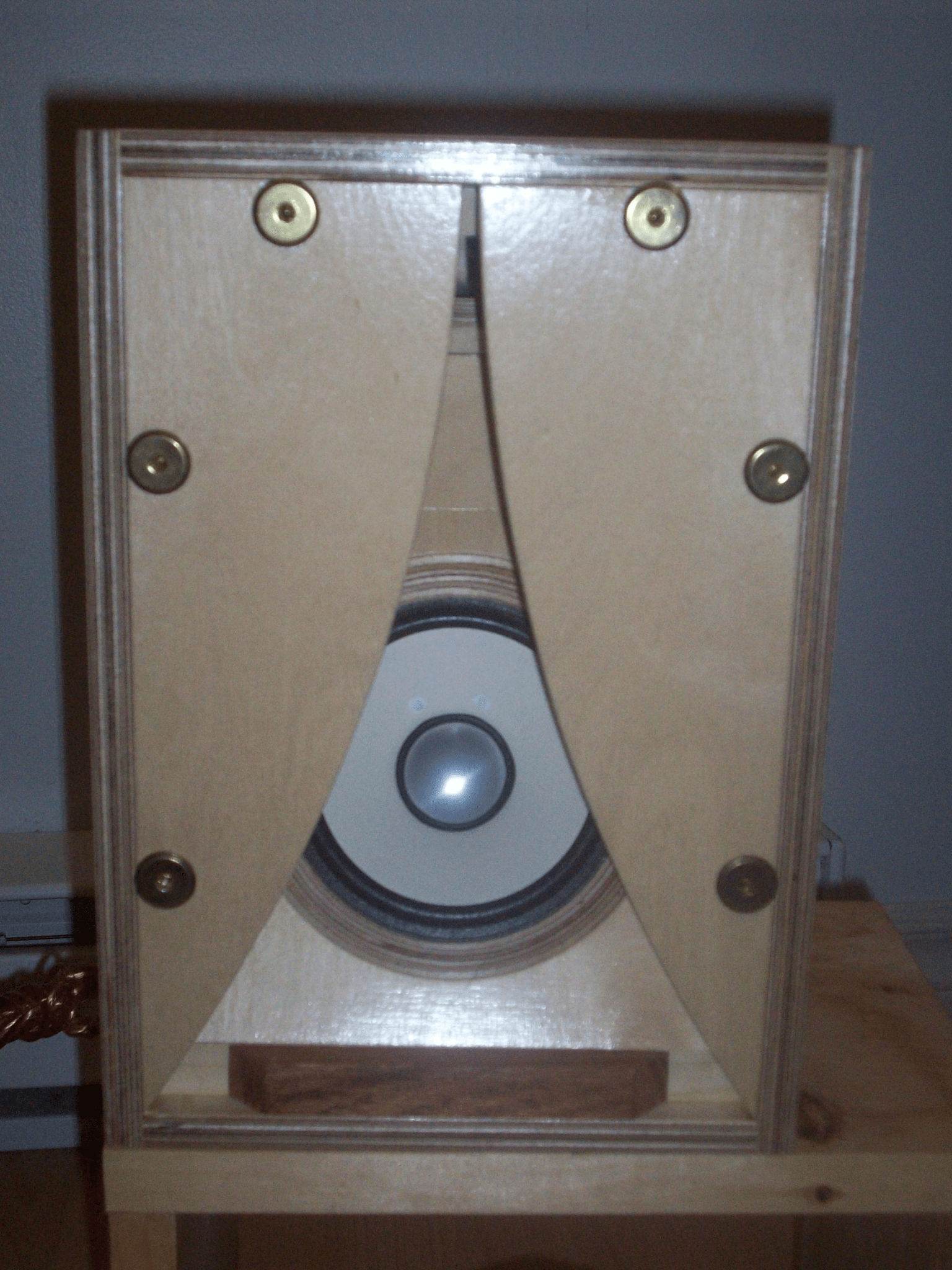

This is with the 10NW64's in some angled recylcled boxes.
Reactions: camplo
^ hi, nice example. Here is how to look at this stuff by eye, thinking with wavelength, and make simple quick simulation in brain so to speak 🙂
As the slot in the woofer box is similar in size with the waveguide, they are likely best crossed over about at there, at wavelength where both the waveguide and the woofer box have (similar) effect on directivity. Now, looking at features of the slot the depth looks similar in size to the opening, which tells there is gonna be a reflection from apex of the slot delayed by distance from cone center to apex and back. Eyeballing the reflection is about similar distance late as size of the waveguide and the slot opening. All I see is reflection problems start at similar wavelength where crossover likely is at. This would mean the reflection affects sound around crossover frequency even if I do not know absolute sizes or what frequency the crossover would be at. I cannot quickly see what exactly a problem would look like in graphs, and it might not matter audibly that much, but it would be good to check out with measurement and perhaps try to listen whether it matters at all. Then you can evaluate whether the arrangement is worth it considering this possible trade-off (compared to just flat baffle for woofers).

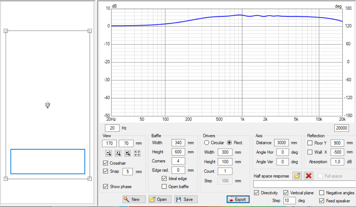

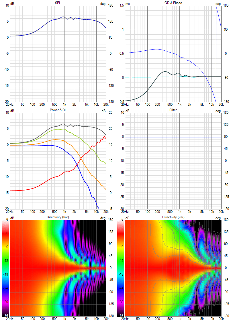

you posted another one my simplification fails 😀 I'll questimate your box is about 34cm wide and perhaps 60cm tall. Slot opening perhaps 10cm high for easy math. These would be wavelengths of roughly 1kHz, 500Hz and 3,4kHz, and features of your simulated response change much lower than that. Low pass happens quite low around 200Hz, I bet due to size of the chamber, and frequency response is chaotic from 500Hz on. Also showing sound going around the box which makes valleys around 130deg off-axis which is all missing from simple vituixCAD diffraction sims that only consider the front edge. None of this can be eye balled or analyzed from vituixCAD simple simulation. Perhaps somewhat into ballpark, as vituixcad shows ~omni response up to about 200Hz, but good example where BEM simulation is clearly needed to be able to really tune it for purpose.
Reactions: camplo
which was my point earlier -you only really need BEM if you want to see how high the slot can be used and want to be able to use it fairly hign. what's needed is a rule of thumb for the limit where simple vituix and HR sims can be trusted. First you have to do an HR sim to check and manage the bandpass effects and then, when converting from axisymmetric to rectangular, make sure slot dimensions aren't an appreciable fraction of a wavelength
BTW IIRC box was about 34 cm wide but only 50 cm deep
Reactions: Juhazi and tmuikku
Considering few examples here on this thread I think VituixCAD simplification is fine with following constrains:
  • transducer is bigger than the aperture
  • chamber has minimal volume, not much bigger than the volume in the cone
  • aperture in front of the transducer
The more a system deviates from these the lower the acoustic low pass, resonances shift lower in pass band, and everything gets more complicated in general. I think these features always drop the top of usable bandwidth lower in frequency and the more the response would deviate from VituixCAD flat ideal transducer mimicing sound exiting aperture. In this sense VCAD simplification always gives maximum usable bandwidth one can hope for, and reality likely demands low pass bit lower.

I was told by Danley folks when they presented it at a trade show, that the inspirational spark behind the design was a CBT.
I would think modeling would have to include the CBT-like curvature, the narrowing vertical slot, the reflex ports, and the mandatory corner mounting/loading.
But then again, I ain't no modeler! 😀

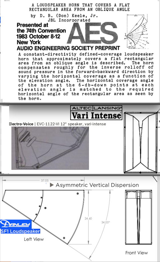

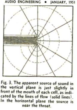

Danley's SF1("Sharc Fin") assymetric vertical dispersion diffraction horn most closely resemble Dave Gunness "Vari-Intense" series of Electro-Voice and Altec horns that were inspired by Keele's 1983 horn that covers a flat rectangular area from an oblique angle:
Danley's assymetric coverage concept is far closer to Keele's 1983 diffraction horn than his CBT line arrays from this century, which don't use diffraction slots on their curved baffle.
Keele's diffraction horns were inspired by Bob Smith's distributed source diffraction horns from around 1951.
Anyway, nothing new since last year, and diffraction slots still work the same as they always did..
