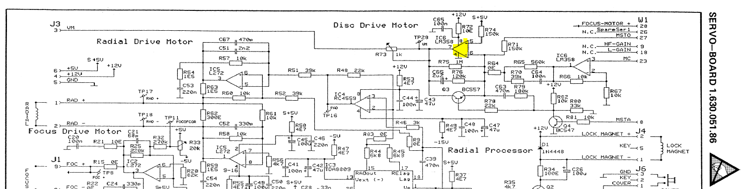

Hi all,
Can anyone suggest a track, as I am running out of ideas searching where is the cause of my old Studer A730's todays issue : as soon as it's powered on, even if lid is open, motor starts spinning backwards at full speed and machine doesn't respond to any order. Swing arm goes full travel outward to disc end, lens tries focusing and laser beam is visible.
Machine fully overhauled 3 years ago (all electrolytics, fresh battery) and it has been playing faultless since. I hadn't used it at all during last 3 or 4 months, but until then it has been working flawlessly.
Some years ago it has been retrofitted by Studer with a CDM-4/16 drive (Neues Laufwerk für A730 Umbaukit MkII 1.630.027.81)
I checked all power supply voltages (+5/-5V, 12V, -15V) and they're all within specifications.
For the time being I'm lost...
Where it is getting voltage now ( driver ) , driver input gets command to that direction ,or driver failed .

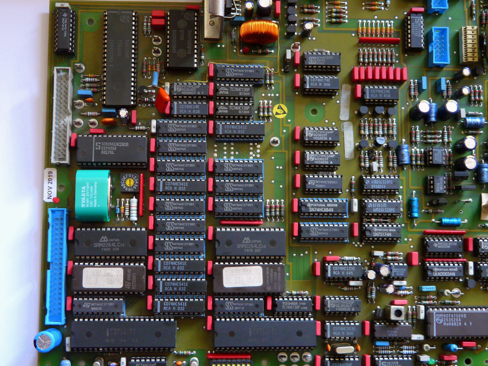

After a month and a half of struggling with the A730 and searching everywhere, doing a lot of testing and signal analysis in the the darkest corners of the circuit I finally found the part responsible for the issue : one of the two Studer EPROMs (IC33) was corrupted.
I figured this out after repeatdly reading its contents with my EPROM programmer : checksum was systematically different from one reading to another, which isn't expected at all. After replacing IC33, machine started right away and is back in business. It now works as designed, that is to say beautifully.
I now have to understand what could have caused data corruption in that SGS M27128 NMOS 128K eprom since it was the the most unlikely situation 😳
As a reminder, machine had been standing unused for about 3 months before I powered up and failure happened immediately. All power rails were the cleanest one can imagine, all capacitors were brand new, there was no power surge that day, thus baffling me.

My A730's IC3 and IC33 eproms are labelled May and June 1990. That's over 30 years...
maybe it was exposed to sunlight while repairing.
Impossible, it would take days, not to say years to erase it with daylight's UVs. Plus the fact that light doesn't pass trough metallized plastic, and that failure happened BEFORE I cracked the player open and found the corrupted firmware. I rather think time took its toll, making physical damage to the silicon dioxide somewhere in the chip. Anyway, I presume it's an ultra-rare phenomenon and that Studer never imagined their CD player would still be used 35 years after it left the factory.
