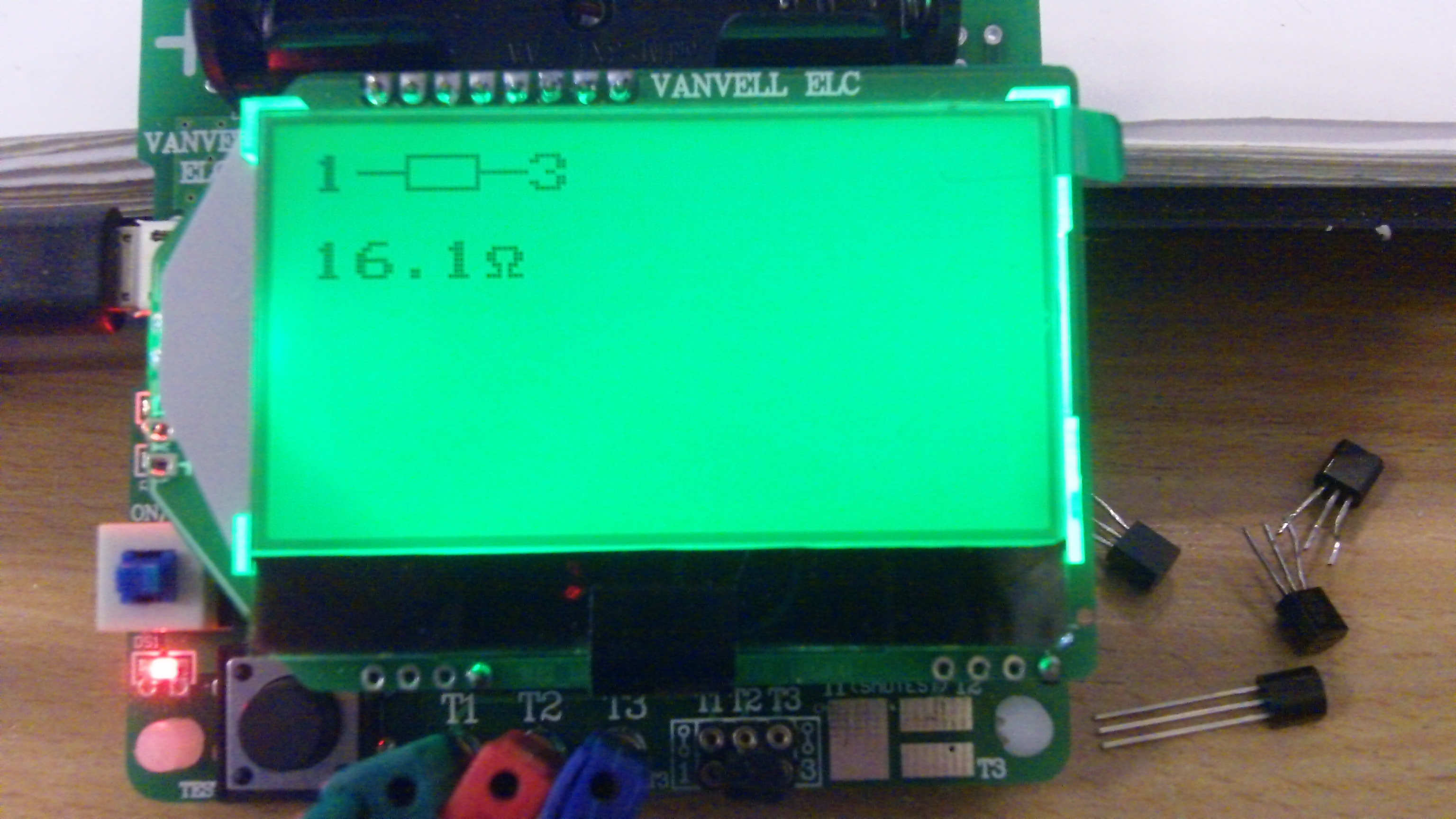

The emitter current share resistors in V1.0 are paralleled pairs of 2W 0R68 and had all "silently" failed open circuit (no sooty skid marks!) is this a metal film failure characteristic?
The only evidence of explosion was a few TO92 with "plasma ejection holes" and charcoaled 1/4W resistors. Removing the PCB from heat sink revealed a few vaporised tracks.
I was hopefully expectant of success after searching and replacing all shorted transistors and diodes and open circuit resistors and missing PCB traces repaired but all to no avail. Both channels refuse to come back to life. I have "come a gutsa" and I am stuck.

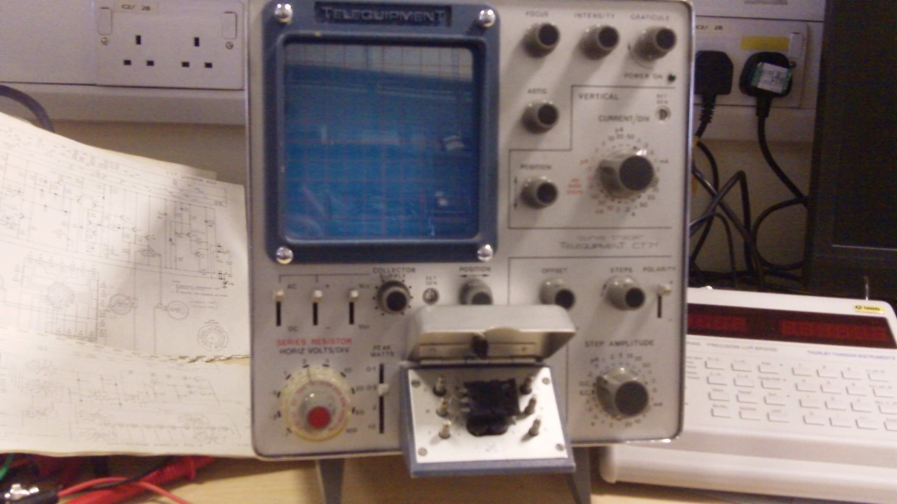

Though new, I have had T21 and T22 back out and on an ancient Telequipment curve tracer to check they still look OK, they did.
Curve tracers are interesting for designing new products. They probably measure at 2 v, correct me if I'm wrong. What is interesting about used transistors, after the double diode test, is : what voltage can they resist? I've found that used amp transistors that measure okay at the 2 v of my DVM, leak with the base open at 12 v. I put a 47 k series 12 v wall transformer, series C to E of transistor under test, series ma or later ua scale of DVM. base is left open. Transistor flows 250 ua or so, it is broken down. Transistor flows 2 ua or less, it is not damaged. Reverse polarity c-e for pnp transistor.
Techs in 3rd world countries do this test to every batch of new transistors, often at higher voltage. Leakers were substituted at the vendor or at the border for known good parts. Don't put more than 24 v from hand to hand.
Hi indianajo,
Yes, as you say it’s important to test suspect transistors at more realistic voltages and some curve tracers allow this.
Telequipment CT71:
https://www.diyaudio.com/forums/attachment.php?attachmentid=945330&stc=1&d=1619167664
The collector supply can adjust upwards of 1000V!
The lid on the ‘test fixture’ is safety interlocked to prevent mishap.
The manual has lots of caution notices, ‘care must be taken when increasing the COLLECTOR SUPPLY not to exceed the device dissipation’ etc.

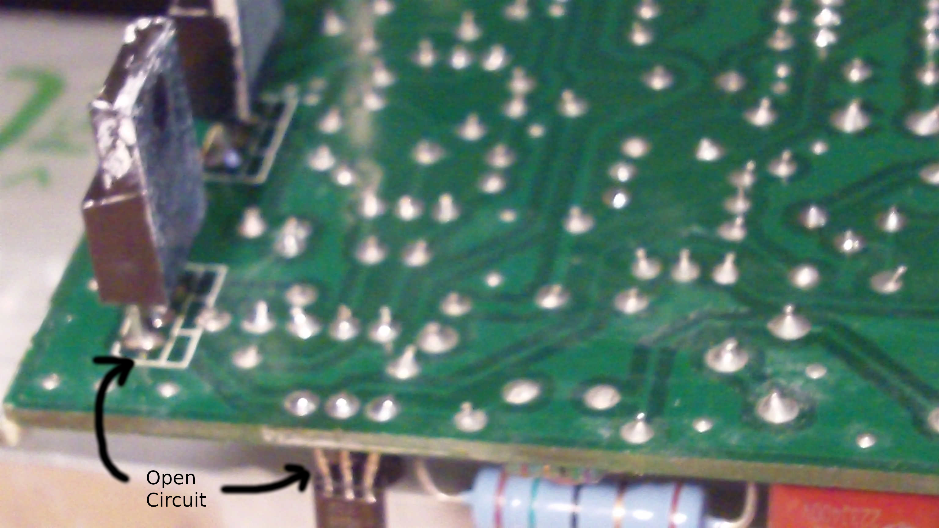

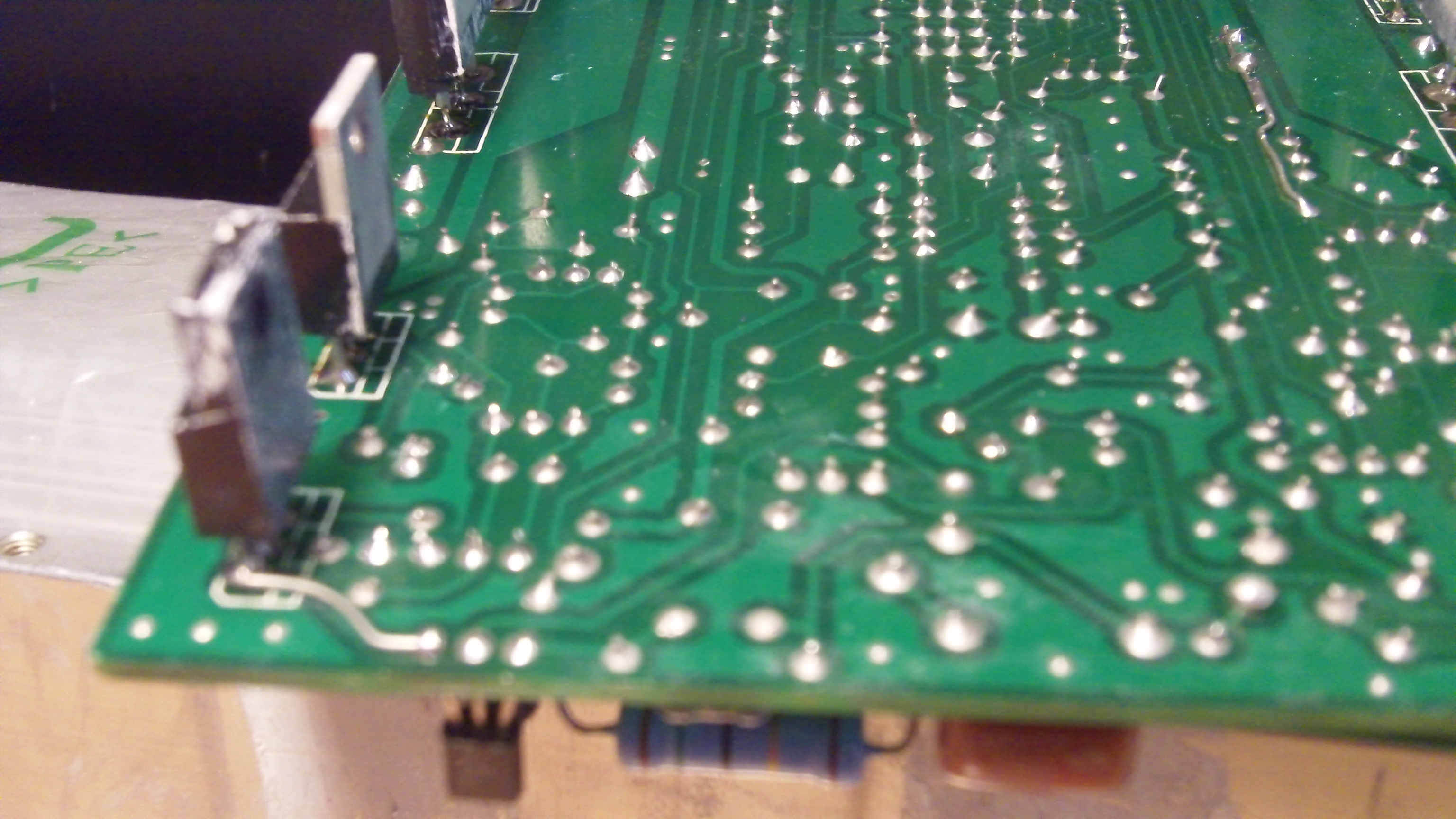

Anyway, some minor progress with the amp, I started to take measurements and the voltage across T15 c to e was only 0.15 and T16 was 1.1.
T15 out
https://www.diyaudio.com/forums/attachment.php?attachmentid=945331&stc=1&d=1619167664
Either I missed it double diode testing or popped it letting the PCB touch the heatsink, I’ve added a better plastic bag insulator and tiny cardboard box to lift the rail switch mosfets clear of the heatsink.
https://www.diyaudio.com/forums/attachment.php?attachmentid=945332&stc=1&d=1619167664
https://www.diyaudio.com/forums/attachment.php?attachmentid=945333&stc=1&d=1619167664
I briefly saw nice big sinewaves varying with input level control across R23 and R24 but by the time I reconnected the scope probe to look at the output pin it had stopped, the current draw on the the PSU meters dropping back from a few hundred milliamps to tens of milliamps. Something intermittent about it, I’ll keep at it.

I learned something about curve tracers. Measuring voltage in circuit is quicker than removing them, if you have a light bulb box in series with the AC to limit the damage.
T17 measures the current on the emitter resistor of T23, a classic vi limiter function. But then it transmits the shutoff to T15, which switches the >100 v rail off to T13. That seems a rather risky duty for a 40 v 200 degC/watt 2n3904. I've found them fragile in other applications. If it wasn't for the lead layout and I was keeping the amp, I'd upgrade to a mje15030 or something. The part is only stressed when it is doing its job. As long as there is no problem with the speaker T15 rides along happily passing current to T13 with no stress.

T13 is a cascode of T11 which will mainly pull current through R41 (200R) from positive rail to control the driver (negative side likewise with T12, T14, ...).
T15 works as a switch and will disable the positive side in case of either mute or over-current condition. Muting is triggered by T9 and T19, while over-current turn-off is triggered by T17.
High thermal stress will be on T13 (cascode) and T21 (driver). This is where you might want to look for problems.

I sometimes resort to removing outputs and feedback driver output back into ltp.
This gives something that can be powered without exploding transistors.
You can then go through each stage checking voltages
I had a Maplin amp that was a pig to fix.
Went round and around and kept coming back to one transistor.
It diode checked ok but voltages on it werent right.
In the end it suddenly hit me that someone had put in a npn instead of a pnp transistor hence it diode checked ok ! Just to help the number had worn off.
I had even checked every component on the pcb.
Faults are hard enough to find sometimes but when someone has been in before you it can become a nightmare with wrong components and/or hacked tracks.

T13 (T12) yes, as you say, the datasheet indicates 20W but not mentioned is the TO220 shape and ‘no isolator required’ all plastic body.

Hopefully T13 (T14) transfer sufficient thermal stress to the heatsink despite being all plastic. If they fail short circuit bad things will most definitely happen.

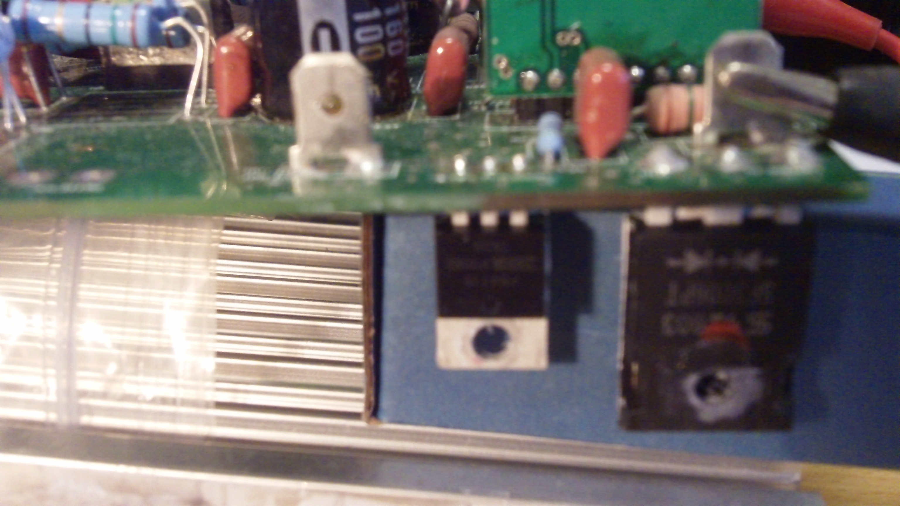

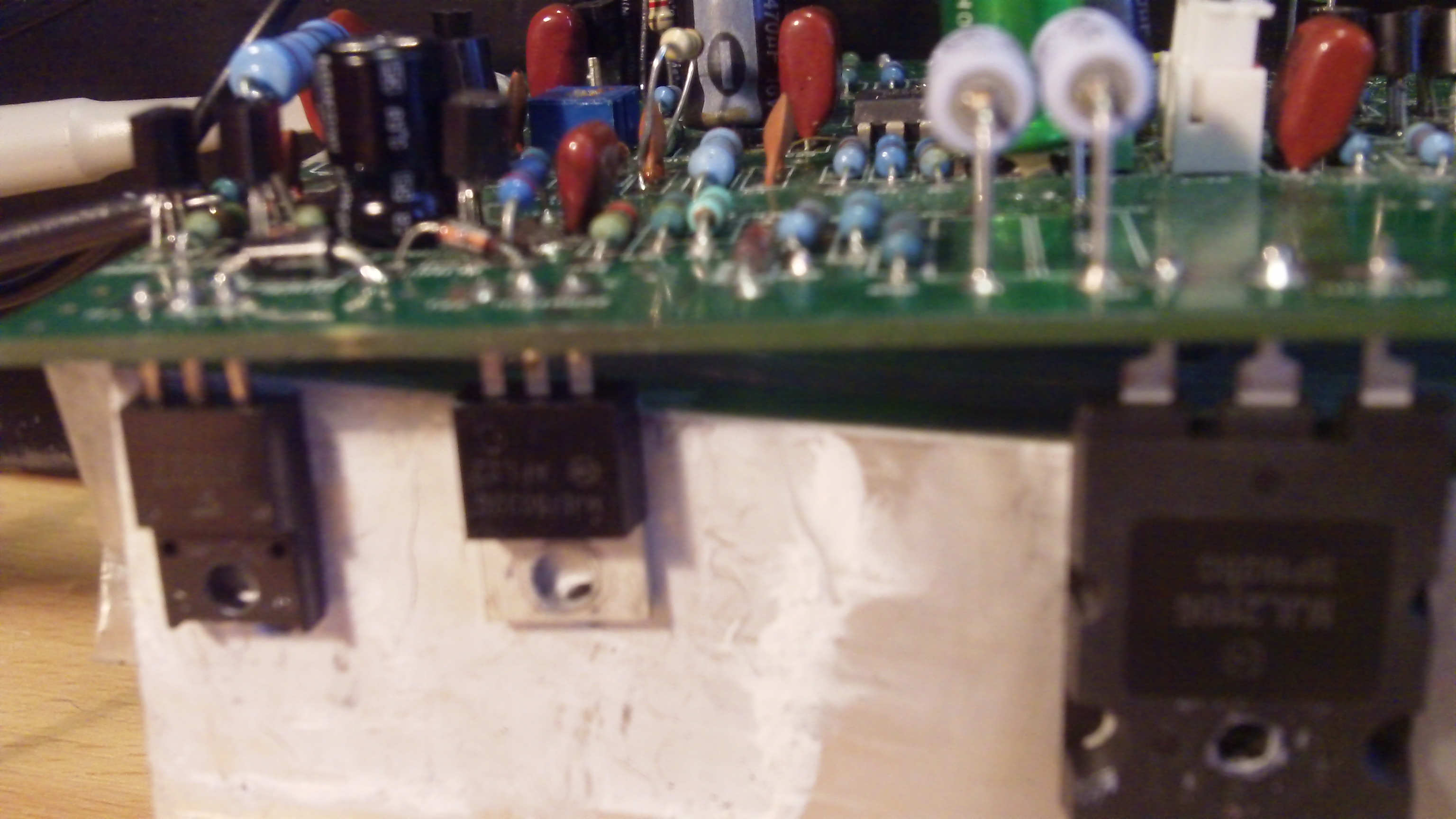

I was so busy replying to posts I forgot a status update.
I think the board I was working on is ready to fit back to the heatsink. There is a heathy looking sine at the output, I had to turn up the current limit to 1A and with only one pair of output transistors fitted and nothing screwed to the heatsink I couldn’t leave it very long, Things soon start to smell hot. Remind me to remove the temporary opamp gain resistor.
I’ve put that channel to one side to try the other. So far no faulty TO92’s found.
I’m back on the first one. I was getting nowhere with channel 2 and the lure of seeing a working channel was too much.
It is all done up on the heatsink with the full complement of output transistors (pun intended), I took the extra resistor off the opamp.
I still have it at +/- 75V, current limited 0.6A, no dummy load yet. There is a good heathy output sine on the scope and, when winding up the level control, the clip indicator lights just as it flat tops to the rails.
But, it had been sitting there for a few minutes when over the fan noise of the signal gen and scope I heard a pop. Well not really a pop more a ‘click’. The output went off and the supply went into limit. Good job I hadn’t put it back on the main amp supply! I turned it off then on, straight into limit, off, pause, back on, same ‘click’ normal service resumed.
I’m thinking the crowbar triac randomly decided to short the output? Or it was made to by the SCR's? I had examined the triacs closely, I’ve seen them split apart after being fired off, but they look pristine and no heat induced colour change on the mounting tab. I’ll take it out and see if there is a reoccurrence of supply limiting. Maybe that’s why in amp V1.5 they replaced the crowbar with a relay? Are crowbar circuits known for bad behaviour?
One disconnects the crowbar triac or SCR until the amp is fully tested including a full load test until it heats up. Then having proved function you can reinstall the triac or SCR. Full load test requires load resistors; don't subject a speaker to a faulty +-140? v amp.
Actually when my 650 w/ch amp failed, it both took out the triac, and the diac that triggers the short. Had I not tested the diac the new triac would have never protected anything. SBS breaks down at 7 v in either direction,in my amp.

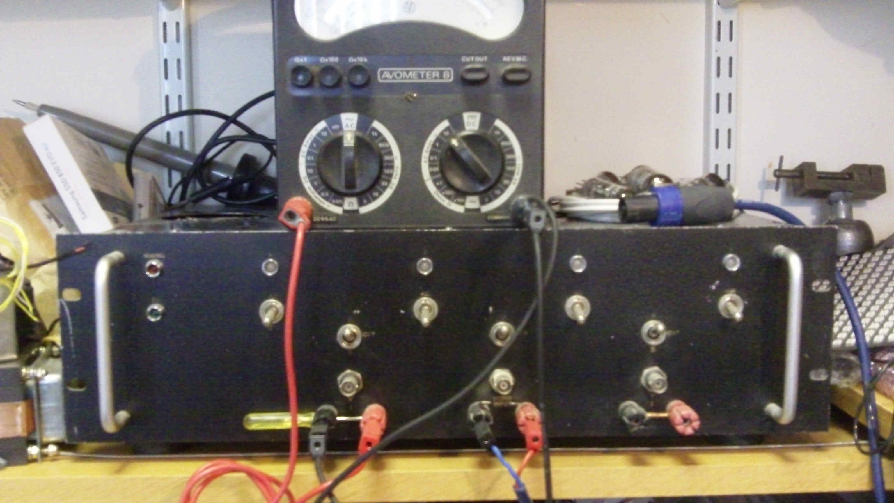

I suppose a test speaker could be AC coupled with a big home made bipolar cap from two electrolytic caps back to back?
I made a load resistor bank years ago for dummy load testing. It has four fan cooled cells each with four 200W resistors. The switches series/parallel pairs of cells and again to give single or dual channel operation. With all R’s in series and connected across 230V mains it has in the past doubled as extra workshop heating.
https://www.diyaudio.com/forums/attachment.php?attachmentid=946957&stc=1&d=1619615143
https://www.diyaudio.com/forums/attachment.php?attachmentid=946958&stc=1&d=1619615143
Anyway, traic removed, 4R dummy load, AVO reads just over 1A when the bench supply limits at 1A. The 1Khz test frequency is emanating from the PSU. I can just about keep the back of my finger pressed to an output transistor. After about 10 minutes the thermocouple that came with the DVM, is measuring 65C (150F) but I’m going to stop it as no fan on the heatsink, it’s still just on the bench.
How long do you soak test a repaired amp before declaring ‘it’s fixed’?
