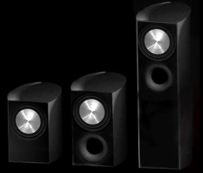

New DIY sub in progress - Stryke AV12. Here is what I would like it to look like:
(please ignore the oversized vent - yes I know it is too big to fit in that box!
ATM I have a 70L test box and have so far experimented with sealed (including a 40L version) and vented with a 4" vent. It is controlled with a subwoofer processor kit from Jaycar with a 2nd order low pass filter, one band parametric eq and a rumble filter.

Hi Paul,
The link to the pic appears to be broken, It's not coming up for me anyway.

Geocities don't allow direct linking, copy/paste the link.

Wicked looking subs Paul, I'm glad it's you and not me that's striving to get there though (lets just say I'm woodworkingly challenged)! Ive taken the liberty of uploading the pic :)
Tony.
edit: Now that's weird as soon as I added the pic the original came up. So I have taken it out again, save some bandwidth :)
Hmmmm maybe it's cached. I'll put it back in............
I'm not sure why the pic wouldn't work!!! Strange ... hard to know cos on my system it works hmmmm....

Yes it is a construction challenge. That will no doubt be another thread later on! ... I have a good idea of how I want to build it. I will construct a matrix of bracing with horizontal sheets setting up the curve. 3mm sheets of MDF will be bent around the curve formed by the bracing frame and glued together. This will give me a stylish and neat curve (I won't rely on planing or other arbitrary methods of getting a curve - I have had previous experience with that kind of tedium!!!)
I'm also considering applying two techniques of making an inert box:
1. lining the panels with a half inch layer of oil based modelling clay to dampen panel vibrations
2. constrained layer damping - a box within a box connected via silicon rubber or similar adhesive
Resolving construction challenges is the easy part at the moment!
