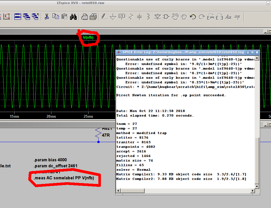

I was setting out to look at PSRR in my Rotel 850 sim.
My initial plan was to simply measure the output with various supply rails.
I was then going to move on to automate this as per
LTspice: Using .MEAS and .STEP Commands to Calculate Efficiency | Analog Devices
But I have fallen at the first hurdle. I added a simple .meas directive to the simulation, via the .meas editor.
But I get no result in the log file.
(I also note a LOT of warnings from the model file)

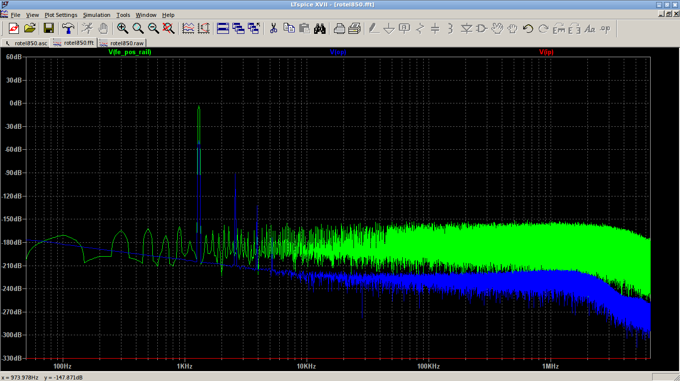

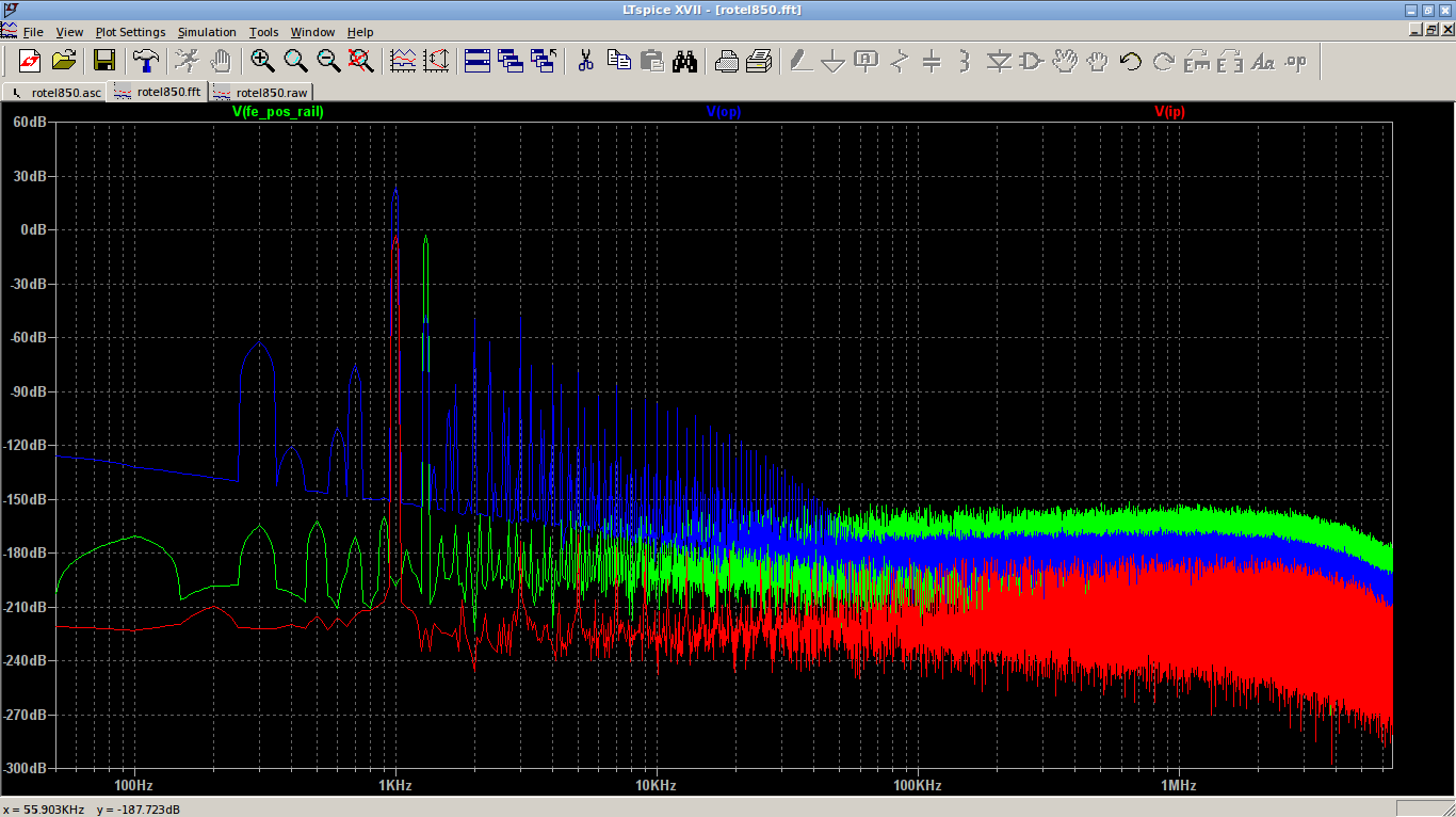

Well, I finally managed to set up what I think is an OK test.
I arranged that I could (optionally) inject 1V of ripple onto either the front end OR output driver stages of the Rotel 850, with or without a signal.
The drivers stage has massive PSRR, so I concentrated on the front end (which is where high grade power amplifiers commonly have some exotic smoothing/regulation).
1V of signal looks like this - some harmonic distortion, but waddya' expect from a mid range amp?
(anything below 120dB and above 100kHz is probably an FFT artefact)
BugBear
