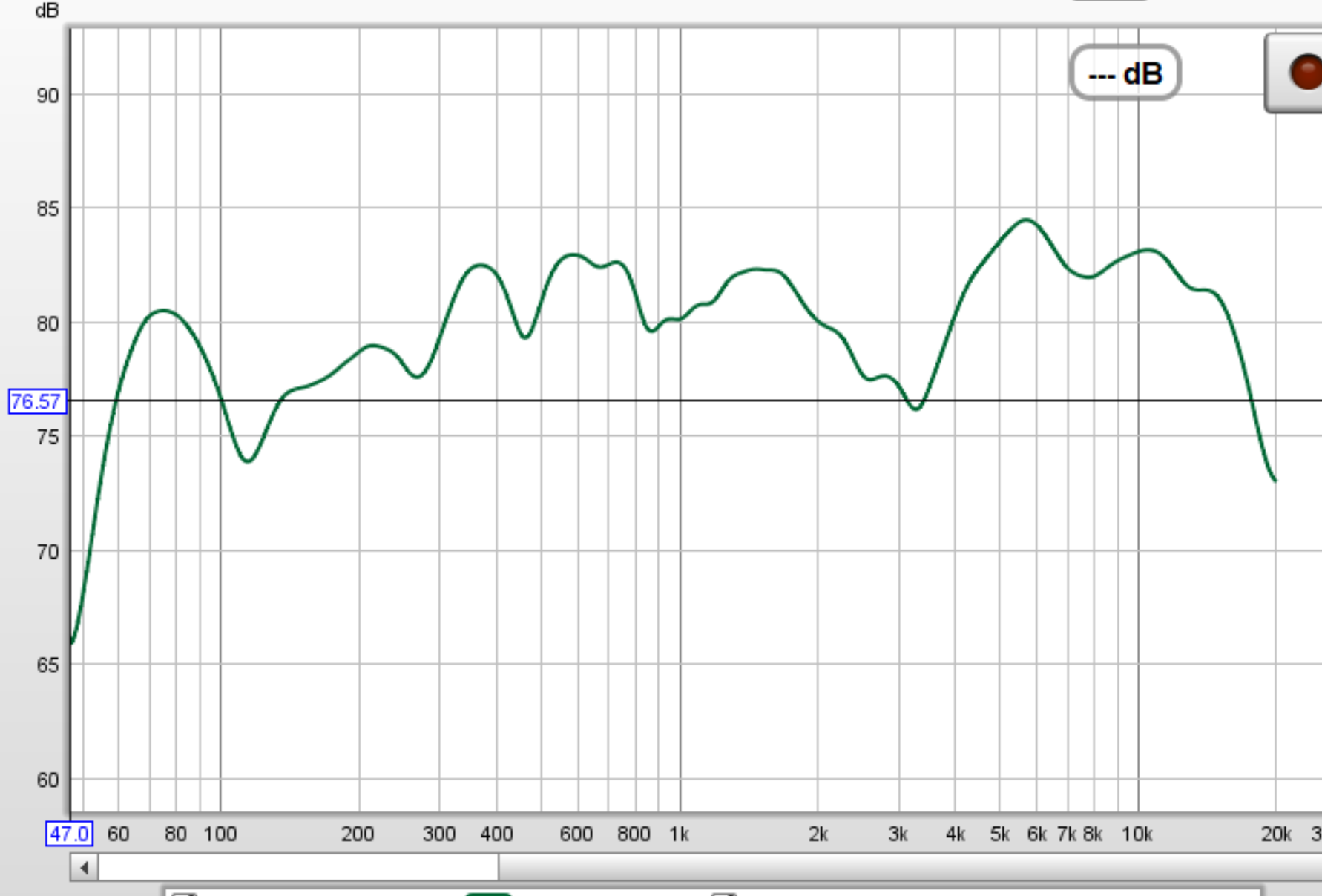

Hi! I'm was using rew, I'm not entirely sure how to get measurements off of synrta, here's my rta graph though. This is without any DSP.
If you are xovering at 3kHz, you need to revise your xover. There is a huge null there that could be misaligned or out of phase. You also should tilt your woofer down a bit with a larger lowpass coil value and increase the tweeter padding resistance.
You also need to tune higher your bass alignment to fill that in which might require less tilt on the woofer xover.
Once you try these things, you should be closer to where you might not need the EQ as badly.

I'm crossing at around 1600 hz actually. What do you mean by tilting the woofer down? I'm actually running it bi amped so turning down the gain on the tweeter's amp should have the same effect as padding right? Also I'm not certain as to how accurate the graph is. That's my main issue, and I don't know why it's not accurate. Even when I eq it to +- 2 db, it sounds completely wrong, I have no idea why. I'm pretty sure I have the umik 1 and the speaker set up right, but a nearly flat measurement sounds completely wrong. Is there anything that can be causing this?

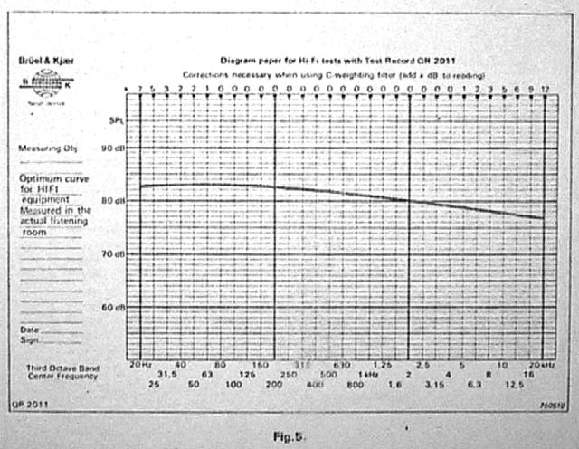

Try EQ to make your response closer to the BK curve for a starting point.
Actually when I eq it, it looks closer to that curve than truly flat. I really feel like the problem is the accuracy of my measurements. For example, I can boost the 40-60 hertz range by 12 db and it would show up as only a 3 db boost on the graph. Obviously this is inaccurate because I can hear the 12 db boost with my ears, far from 3 db. My spl meter also confirms the boost. I've had the same issue with boosting for example 3.5 khz. If I boost it by 10 db it only shows a 2 db gain, when in reality it sounds definitely much more like 10 because I can hear the peak. So I have no idea why my measurements are so far off.

I'm seeing a HUGE SUCKOUT at 3kHz. That's why I thought maybe 3k was the xover, and maybe the tweeter polarity needed reversed. Have you tried to reverse the tweeter polarity yet and remeasured?
Another possibility is that the woofer breakup is at 3kHz, and either not suppressed well, or creating a suckout in the tweeter response due to it's higher magnitude. This type of result can be quite common if not compensated.
Tilt is referred to as the flatness of your curve. To me, the woofer looks tilted up in the RTA you have shown, or maybe that the tuning of the woofer is too low causing the low peak and midbass suckout. This could also be floor-bounce, without knowing your measurement methods.
Have you measured any ground-plane measurements? This might work to your advantage as it gives you a gain in the bass, and you have to tune the low-end down to flatten it out.

Thank you, I explained in more detail how I'm measuring in the op, but basically I'm putting it on a desk, taking it outside, setting the mic up to ear level a few feet away and measuring. I haven't tried reversing the polarity, so maybe I'll give that a shot. I'm rolling the woofer off at 1600 hz at 48 db/octave, so I think break up shouldn't be audible? Regardless I'm not sure why it looks like that at 3 khz. It doesn't sound like it really drops off that much... I haven't tried ground plane measurements actually, but for a portable player won't that be a worse idea because of the changing environment? The woofer is also not tilted up, however, I'm measuring the speakers at tweeter level, so the microphone is placed above the woofer. Is this counterproductive?

The measurements are outside actually but my enclosure is strange, so I don't know if that would have a similar effect has room modes. The tweeter enclosure is "levitated" one inch above the woofer enclosure, so there is a 1 inch gap. I'm not sure if this would have an effect though.
I do not mean the speaker or woofer is tilted up, I mean the 'frequency response' of the woofer in your measurement is tilted up spectrally when compared to flat average response. It does not look like a level ruled line as an average, but one with a rising line from left to right.
