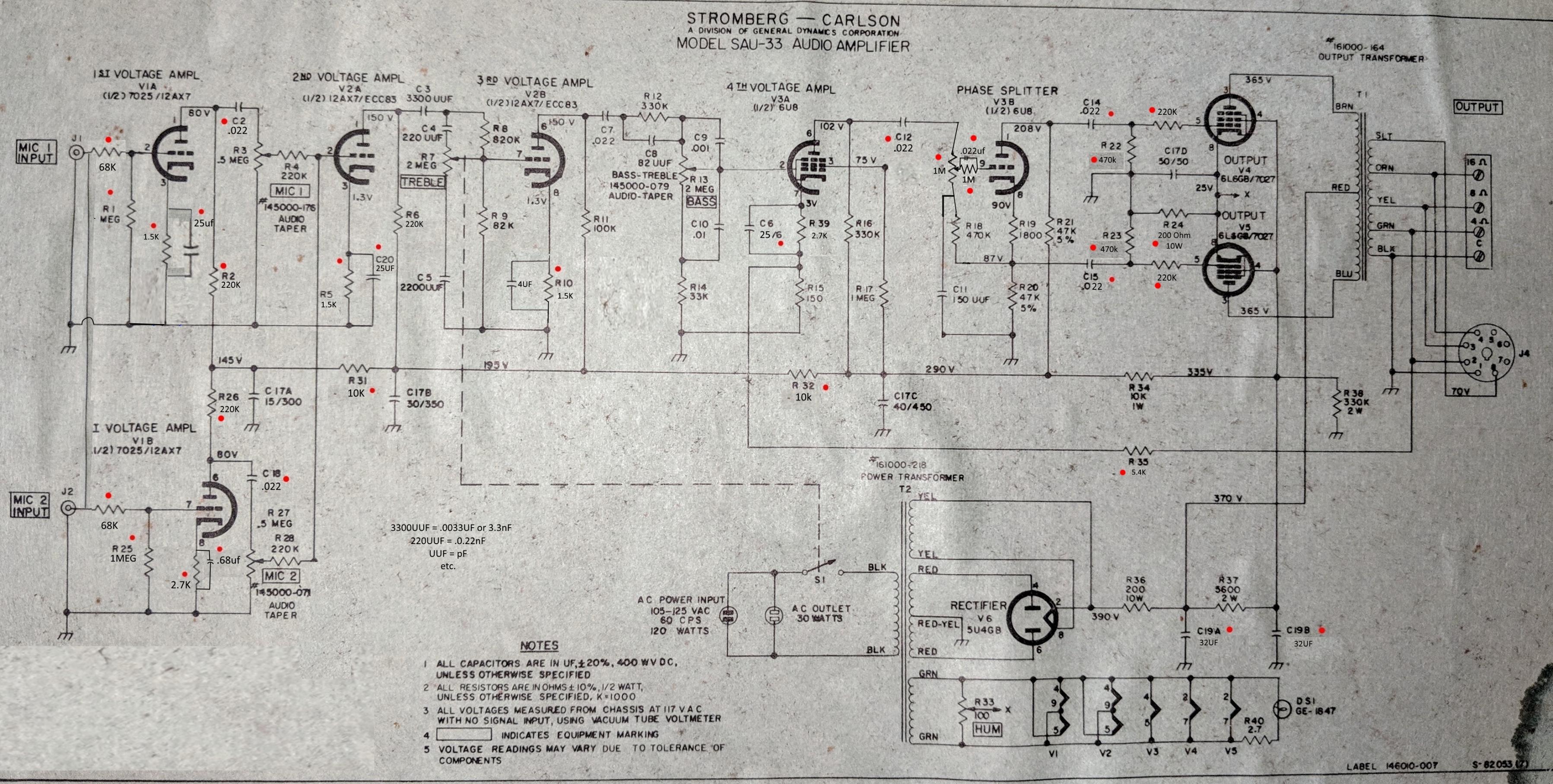

So this has been a project I've been working on for a couple of months now, with the excellent help of some nice folks over at a different audio forum. I'm in possession of two of these amps and I've been working my way through the first one and finalizing my schematic before working on the 2nd amplifier. I'm pretty close to wrapping it all up, but there are some finer points that I really need some help with.
Attached is a before/after schematic. One completely stock, and the modified schematic which shows all my changes marked by a red dot.
The infinite possibilities in preamp design are a little overwhelming, and I find myself constantly questioning certain decisions regarding cathode, plate resistors, and bypass caps etc.
Here is a current list of planned changes: 1. Reevaluate bypass cap values. V1A & V2Ato 1.5uF(?). How to bypass caps interact later down the chain? Does is make sense to have larger bypass caps earlier in the chain and smaller ones later, or vice versa?
2. Similarly, reevaluate plate/cathode resistor values. V1A & V2A cathode to 2.7k? I had previously switched V2A's plate to 220k. How is 1.5k/100k different to 3.3k/220k from a practical, audible perspective?
3. I already increased R35 from 2.7k to 5.4k. What are typical negative feedback values? I have also read at Rob Robinette that running a 100-500pf capacitor around R35 can help me reduce ice pick highs, which are currently a bit of an issue. How does this work? What kind of roll-off should I expect from say, a 500pf cap there? Should I be looking at increasing R35 more dramatically?
4. I feel like I really need to do something with the bass and treble controls... they are not exactly practical for a guitar in their current form. The pots (2M) need to stay the same, or else I'll be drilling new holes for a power switch, and additional pots elsewhere. They are a stacked 2M/2M/switch pot. Any good practical mods to the capacitor values that will make these more useful?
5. I was going to put a bright cap on V1B a la Marshall Plexi. But I still need to tame my ice pick treble first. .005 is the standard value for a cap. I'm, assuming that should be just fine?
6&7. Is there any harm in increasing the value of C11 to say 500pf? Could that help tame treble? I have a .022 cap on my master volume in order to retain bias, what is the effect of changing this value between .01 and .05? I've had two different recommendations on that number.

68k is used with Fender's nifty voltage divider. 33k gives a bit more highs. If you use cathode bypass with extended range up front it can reduce hum. But if you plan on overdriving the next stage a reduced capacitor value makes sense. Fended values are 1.5k/100k, Ampeg 2.2k/220k (I think, cleaner I have been told), if you want earlier clipping try Marshall's 820R/100k 2.7k/100k. Depends on what you are trying to achieve.
C11, use ears after all mods done. Could just leave the 0.047uF's in for now and evaluate when completed. Tonestack calculator, use James tab for an idea on cap values. TSC C20, C6, 50uF, just leave it in, the added low bypass won't hurt as compared to 25uF. 0.022uF on cathodyne input negates the 1.0M when you have the master turned uo, just when you may need the grid stopper. I think this is dumb.
R22,23 looks like you wanted to change from 470k, possibly wanted 220k? That is what I would do. Grid stoppers of 220k on the 6L6's looks mighty high in value. You may loose some highs.
R24, dropping from 250R to 200R, leave it where it is, why do you want to run class A? Put stoppers on each output screen, 470R or 1k. Even Fender went to them eventually. R12/C8, might want to try jumpering across these two, don't see this being of value. Nothing set in stone, I would evaluate as a complete amp.
What are you referring to here? The only 33k I can see is R14.
I'm not sure if you noticed, but I took some inspiration from a Marshall Plexi with jumpered channels and similar preamp values. I did have V2A running 820/100K at one point. I may go back. Regardless, better to have smaller values later in the chain? V2A and possibly V2B were definitely getting changed to smaller values in my next parts order.
Fended values are 1.5k/100k, Ampeg 2.2k/220k (I think, cleaner I have been told), if you want earlier clipping try Marshall's 820R/100k 2.7k/100k. Depends on what you are trying to achieve. C11, use ears after all mods done.
I originally went 820R on V1A and 2.7k on V1B but then I realized I have 220K plates from the factory, so jumped V1A back up a notch. Same goes for V2A. Any reason NOT to have 820R/220K? I assume it'll just clip to all hell and not sound very good.

The 68k resistor value was selected by Fender for their two hole input. You don't have a 33k but rather than a 68k on your inputs. When the 68k's are paralleled up in use you get a 33k, just saying 68k is not a magic value.

Again, it depends on what kind of amp you want to build, clean or dirty. As long as you have enough unclipped gain to make it through the amp to drive the output tubes fully. C11 is not normal in amps, might be in for stability reasons due to the layout.

38k will be fine for the treble. I would simulate the bass with it also and short out the resistor-capacitor in front of it.

With the pot in the position it is in you do not need isolation from the splitter circuit. If you had the wiper going to the grid and the bottom leg of the pot going to ground then you would have had to have the cap on the wiper.

The 470k value does not drain the electrons well enough if you plan on clipping the output to a great extent. It will work but the actual bias voltage on the grids can drift. The value of the grid resistor and the bias current through the tubes are related. 70% is not a magic number, as far as I can figure they used that as a target and the datasheet recommends a resistor value to use. People have bent the recommended values over the years. If you find the amp is eating output tubes in practice this would be a place to look at, if not don't worry about it. Oh wait, just realized it is a cathode bias, they spec a higher value, the 470k might be ok. On the grid stoppers, if it sounds good it is good.

The lower the resistor value the higher the bias current and the lower your headroom.

The amp will not be as stiff, it will sag a little on full output. It is a trade off to protect the screens from melting when the output section is overdriven.

The resistor reduces the signal level, the capacitor bleeds some treble around it. Without the need to have the increased treble that the cap provides the resistor is just a waste of signal level. Since you have icepick I would think scrapping the two would be a good idea.
Replace R1 & R25 with 1M0.
Fit a 2k2 with a 2u2 16v cap in parallel between pin 3 and ground and again for pin 8 and ground both on V1.
Remove R29 and discard R30 etc.
Place a 220R pot in place of R15. Place a100pF cap in parallel with R35.
That will then become a presence control, giving you that Marshall sound.
Parallel R36 with 47R 5W W/W. To give more headroom. Leave the output valve bias as it is.
If you intend to drive the ouput stage to clipping, fit a reverse bias 1N4007 diode between the final anode and ground on both 6L6s. That will save the valves from arcing internally.

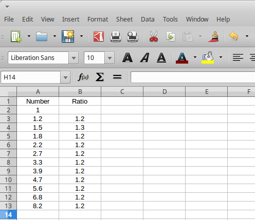

why do we have 220 ohm resistors rather than 200 or 250 ohm resistors? Why a 47k resistor rather than a 50k?
There is actually logic to it; the idea was to have successive resistance values roughly 20% apart, i.e. they are a geometric series with a common ratio of 1.2. In the era of +/- 10% resistors, this kept successive values from overlapping, even if both were at the extremes of their tolerance.
If you divide each successive value in the E12 series by the value just below it, the ratio between them, rounded to one decimal place, is 1.2 in every case except one: the value "1.5" should really have been 1.4. (See attached screenshot of a Libre Office Calc spreadsheet I threw together.)
It's not perfect (the ratio between many adjacent values is 1.22, others as low as 1.19), but it's not totally ridiculous, either. There is a reason for the imperfections: if you used an exact common ratio of 1.2, you don't get values that fit neatly into a decade - there is no power of 1.2 that gives you 10! So whoever created the original series tweaked some of the values just enough so you could repeat them as decade multiples.
There's nothing wrong with the 1 - 2 - 5 sequence at all (it works very well for money). The trouble is that it's hard to expand to include more values. Once you get to better than +/- 50% tolerance, 1 - 2 - 5 becomes inadequate. Then where do you go?
