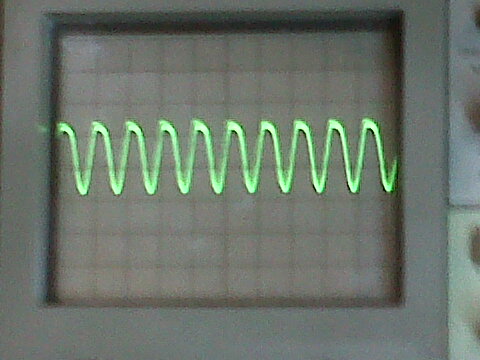

It's working and sounds great, if you keep the volume under 3. Above that it starts to distort, much sooner than it should.

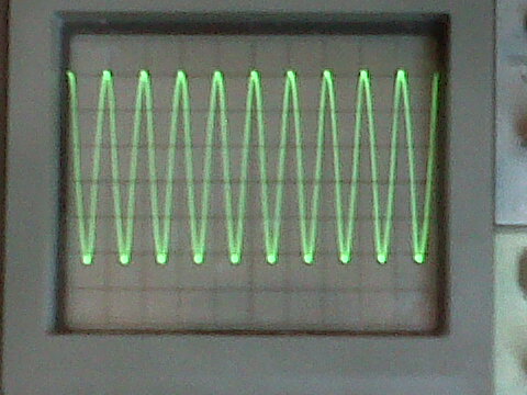

I pulled out the o-scope and hooked it up with a sine wave input. Through the input tube (6SN7) all is good, nice symmetrical amplified signal.
The distortion shows up at the input of the mixing tube (6J5). The two input channels are tied together with 1M resistors, tied together, with the junction fed to the mixer tube.
On the input side of the 1M resistor, I see a nice symmetrical sine wave. On the output side of the resistor, I see a clipped signal.
And there I am, out of my depth. I don't see how the signal is becoming asymmetrical across the resistor.
