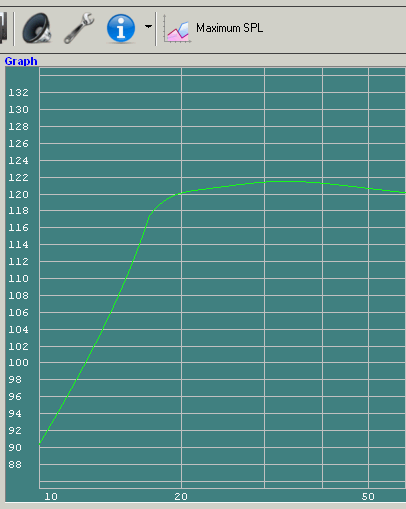

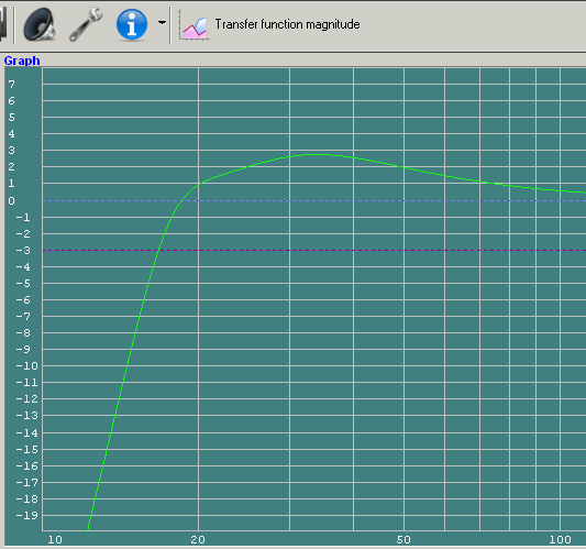

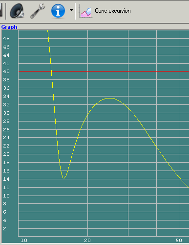

Can you please post port dimesions.. i recently experienced extreme port noise with one 4 inch tube in wilson eith to go for six inch or dual or triple 4 inch ports.
Can we safely use bends with pipes for length fitting.
For a Working volume of 11.64ft^3, three 4" flared ports 33" long would tune to 15.6Hz.
For that driver and three ports you need a box that has internal volume of 12.7ft^3 to get the working volume of 11.64ft^3
When using bends use the largest radius bend you can find.
