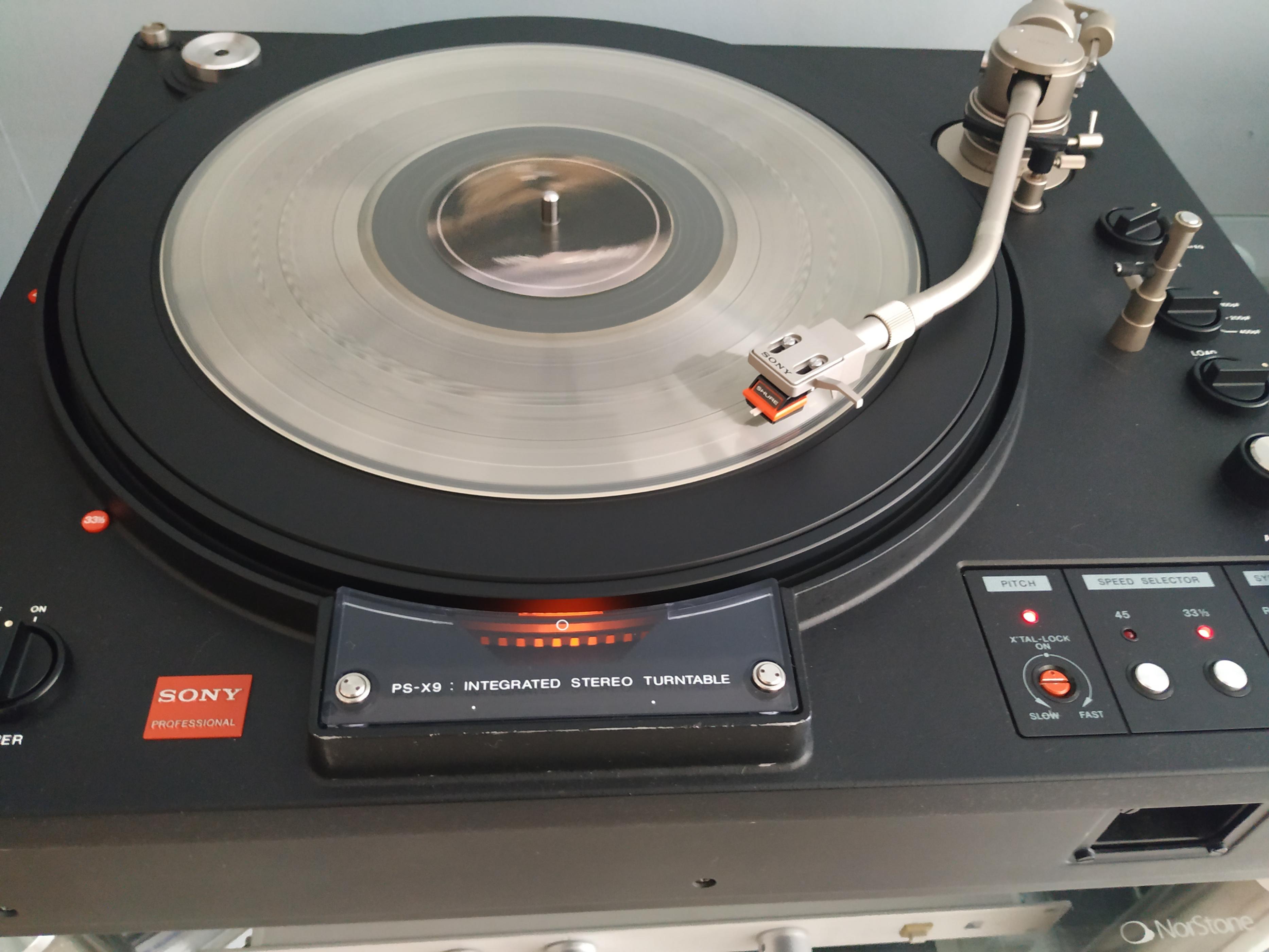

I have already had some help from members in the past for which I am grateful, however I am still stuck 🙁.
After resoldering the power supply and NEON power supply, and measuring the voltages, Q701 (2SC1431) doesn't have the right values (resp. B=36v, E=53v, C=240v). According tot the service manual it should be 155v, 157v, 220v. I suppose that's the reason Q413 doesn't measure right either.
Does anyone have an idea what might be wrong? 😱
Just discovered that the R706 resistor (33kOhm) is open (can see black mark on body). All the other resistors to this point in the power supply measure fine. Should I just replace this one or all the others as well as a safety precaution?
You're right, but kind of difficult for me to trace down. The situation is that a couple of years ago a repair service center in the Netherlands repaired my TT after some transistors started to smoke and it stopped working. It took them more than a year to repair the damage (2 transistors were burnt and the PCB traces around it were damaged). I assumed that they would do a full recap as the bill was a 1000 EU, but this wasn't the case. At one stage the strobe light stopped working (and the platter turns backwards a bit when I pressed stop). I decided this time to do a full recap to avoid future problems. I had hoped this would solve the strobe problem, but alas. Anyway, after help on this forum I decided to further investigate and came upon this burnt resistor. The other resistors in the power supplies all measure fine. I hope by replacing it, this will solve the low voltage on the transistors that follow.
Long story... 🙂 Of course there is a risk that one of the other components caused the resistor to fail.
Solved! Was the burnt resistor (mistook the burn mark for a band). 😱
That will teach me to always measure and not assume metal oxide resistors to last forever.
