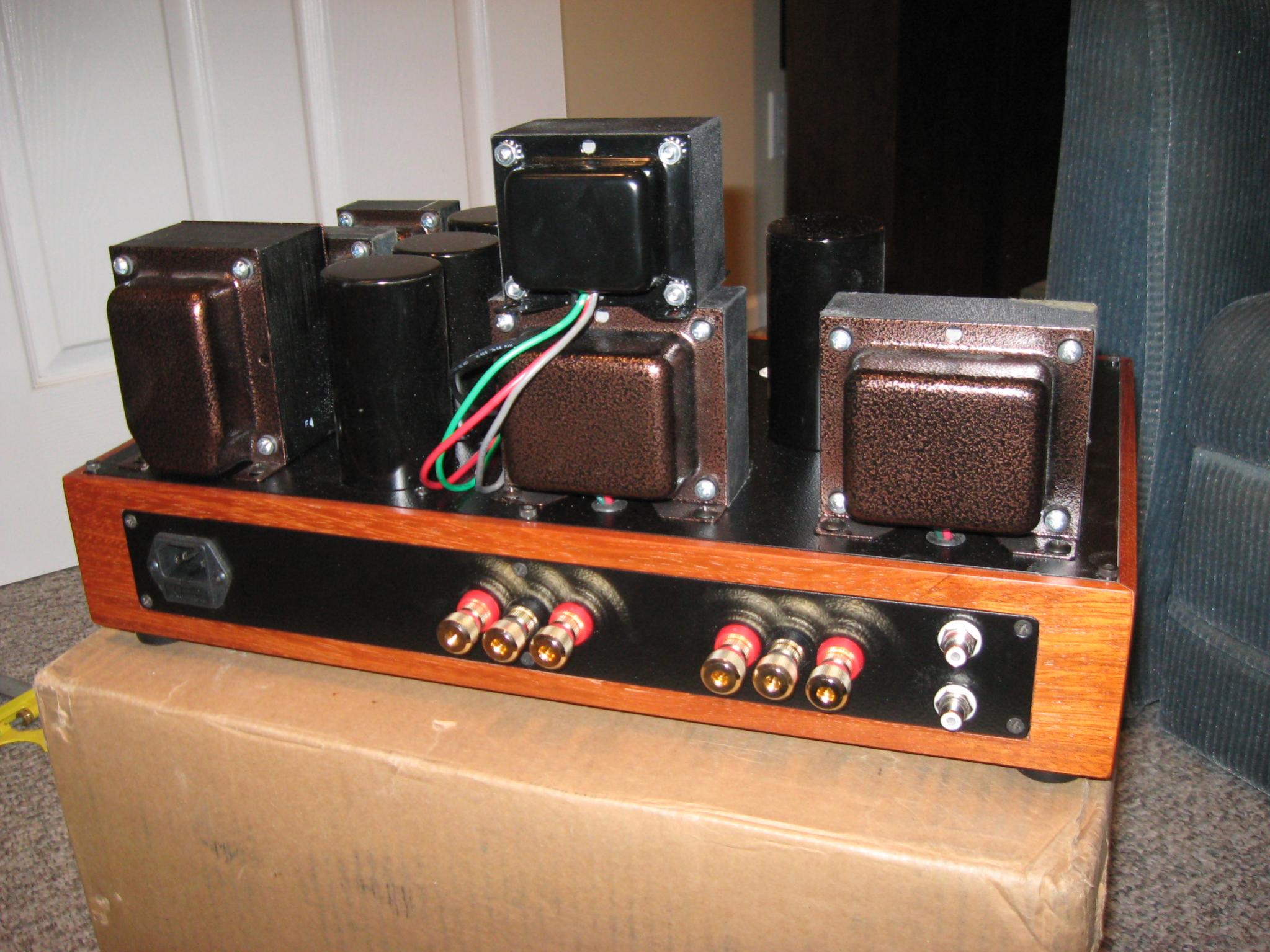

I do like that color better than the blue they use now. I am going with a Chrysler Dark Cherry Red Pearl Coat. I hope it's worth the money I am paying for the rattle can.
Funny home the peep's that don't like Edcor Blue do not live in the States. Personally, i like the color

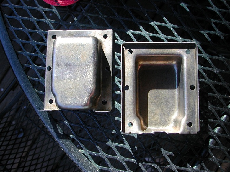

A transformer won't be "oily" like a new (or old) brake rotor.
Dishwasher, even glass-spray and clean paper towels, should get it off. Rinse, look how it "sheets off" or not. Put in a warm airy place to dry thoroughly.
The thread is "powder coat". If you got powder-coat, this is PLASTIC. Polystyrene or similar. Normal steel-car spray may not stick well. (May come off real easy...) I'd look to Testor's model-car paints.
If you are sure you got painted endbells, wash then sand with fine-fine grit. However getting in all the curves is impossible. And I know guys who just hit it (dirty) with Rust-o-leum and it looks great in pictures, does not fall off in road-tours. I used a Mercury-spec rattle-can for all sorts of markings after my Mercury fell apart.

The shiny light blue shown above is fine, but what about something from plain:
to, say :

I have recycled the end bells from power transformers removed from scrapped HP audio oscillators.
I visited a surplus shop where about 50 of these were sitting outside in the Florida rain waiting for a trip to the metal scrapper to be melted. I paid the metal value and took them all. I stripped them for the tubes, hardware and transformers, then left the remains for the recycler.
Some of the transformers were pretty rusty, some were reasonably clean, but even the rusty ones worked.....not a single transformer was dead even one that had water inside it. I kept the clean ones and took the rusty ones apart mostly for experiments and the end bells. They fit some open frame OPT's that I have.
I also removed the end bells from the HP transformers that I decided to reuse and repainted them. The laminations were repainted flat grey....do not sand the laminations, you will usually cause more damage, just paint over the rust with a paint made for rust, POR-15 if you can find it, otherwise Rustoleum.
I simply sand blasted the bells, concentrating on the rust. Sometimes the existing paint was completely removed, sometimes there were rust free patches left, especially in the corners.
I then cleaned them with lacquer thinner, working it into all the corners with a brush, and left them outside in the sun to dry. After a few minutes I brought them inside to reach room temp, then took them back outside and sprayed them with Krylon or Rustoleum gloss black spray paint made for use on "clean bare metal." I have had some of these in use for over 10 years now in guitar amps and they are still shiny.
