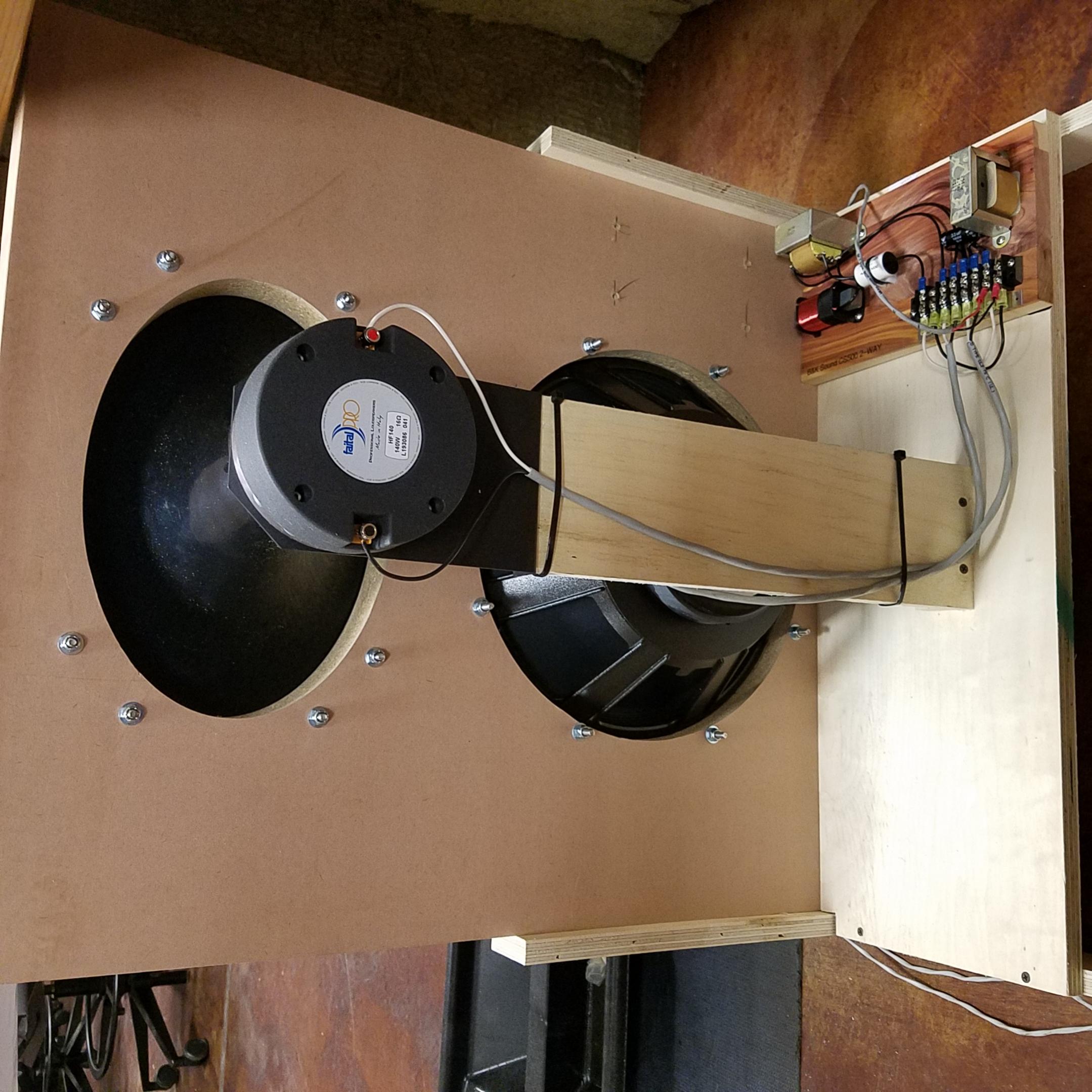

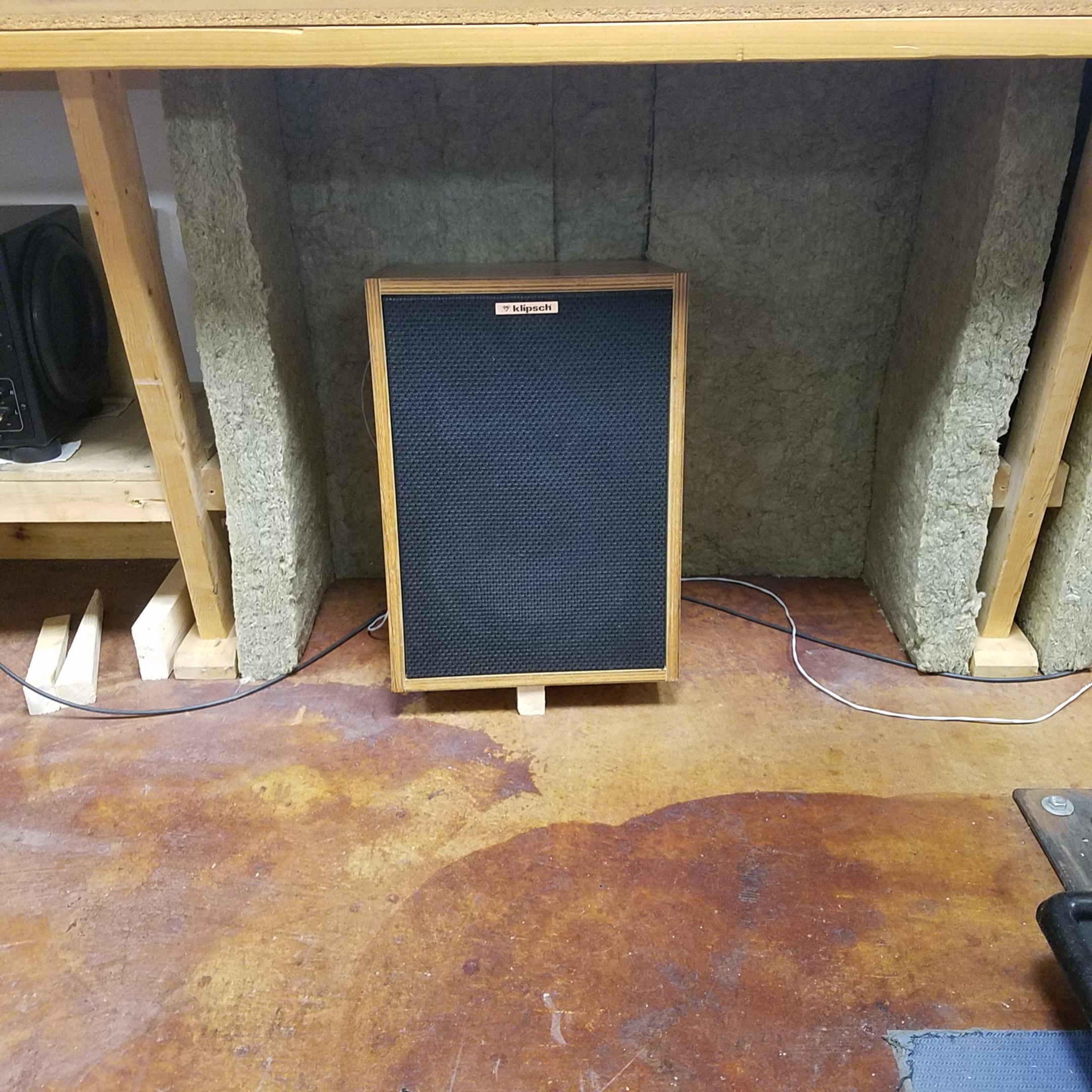

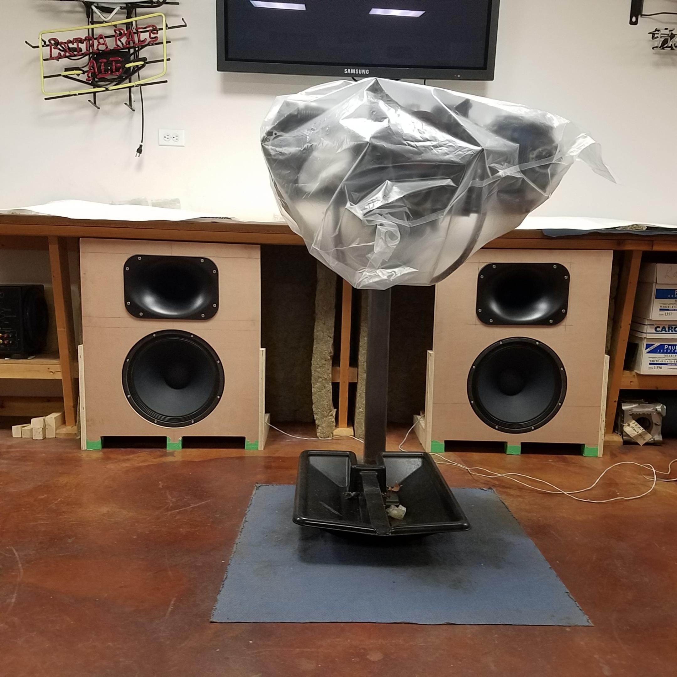

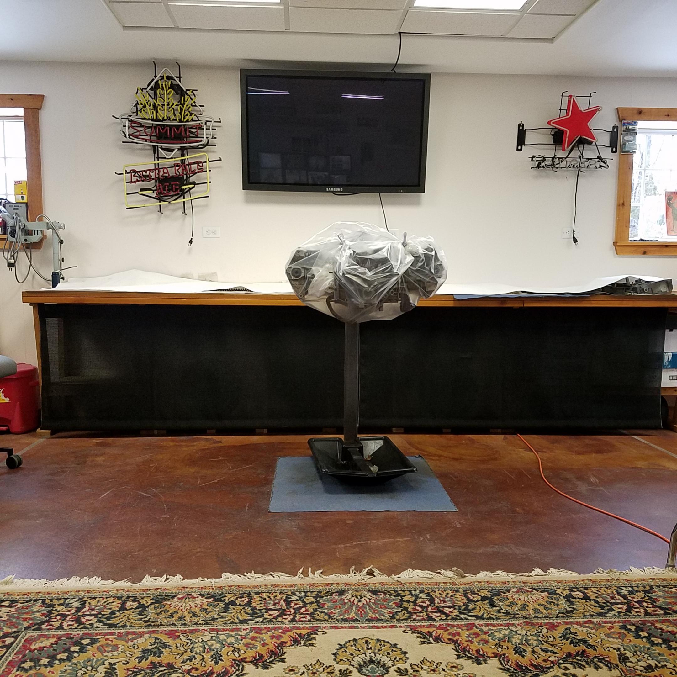

I built these to fit in the under counter space. I used a Crites Conscalla Type D package. Lined the inside of the opening with 3" rock wool and covered the front with hanging speaker grill cloth. They sound very nice to me with good bass response. The motor boards do not vibrate much.
