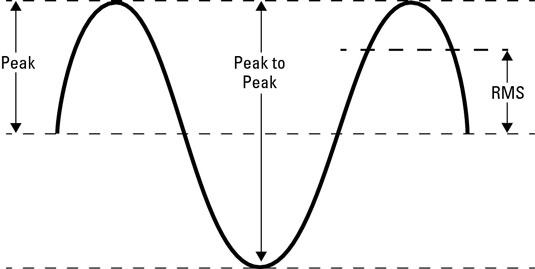

Connecting the audio generator directly to the oscilloscope with a .25 VAC signal and setting the o-scope to 1cm per volt, I see a magnitude of .7 VAC with the aid of the fine tune adjustment. Does this make sense? Again, I'm just getting familiar with this equipment
If you mean 0.7V peak to peak, yes. Vp-p = 2 x Vpeak
