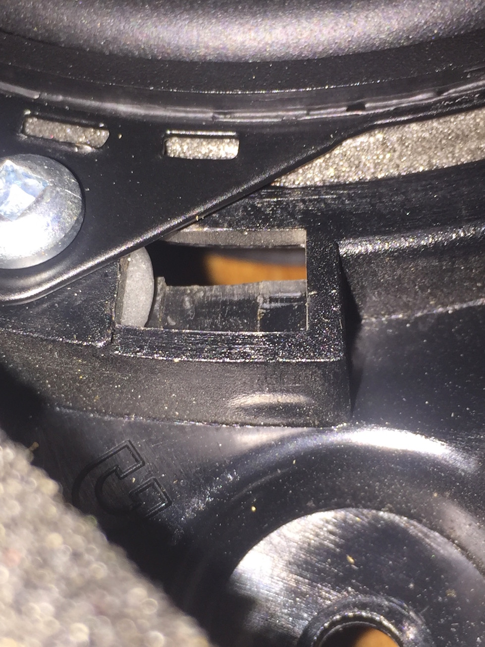

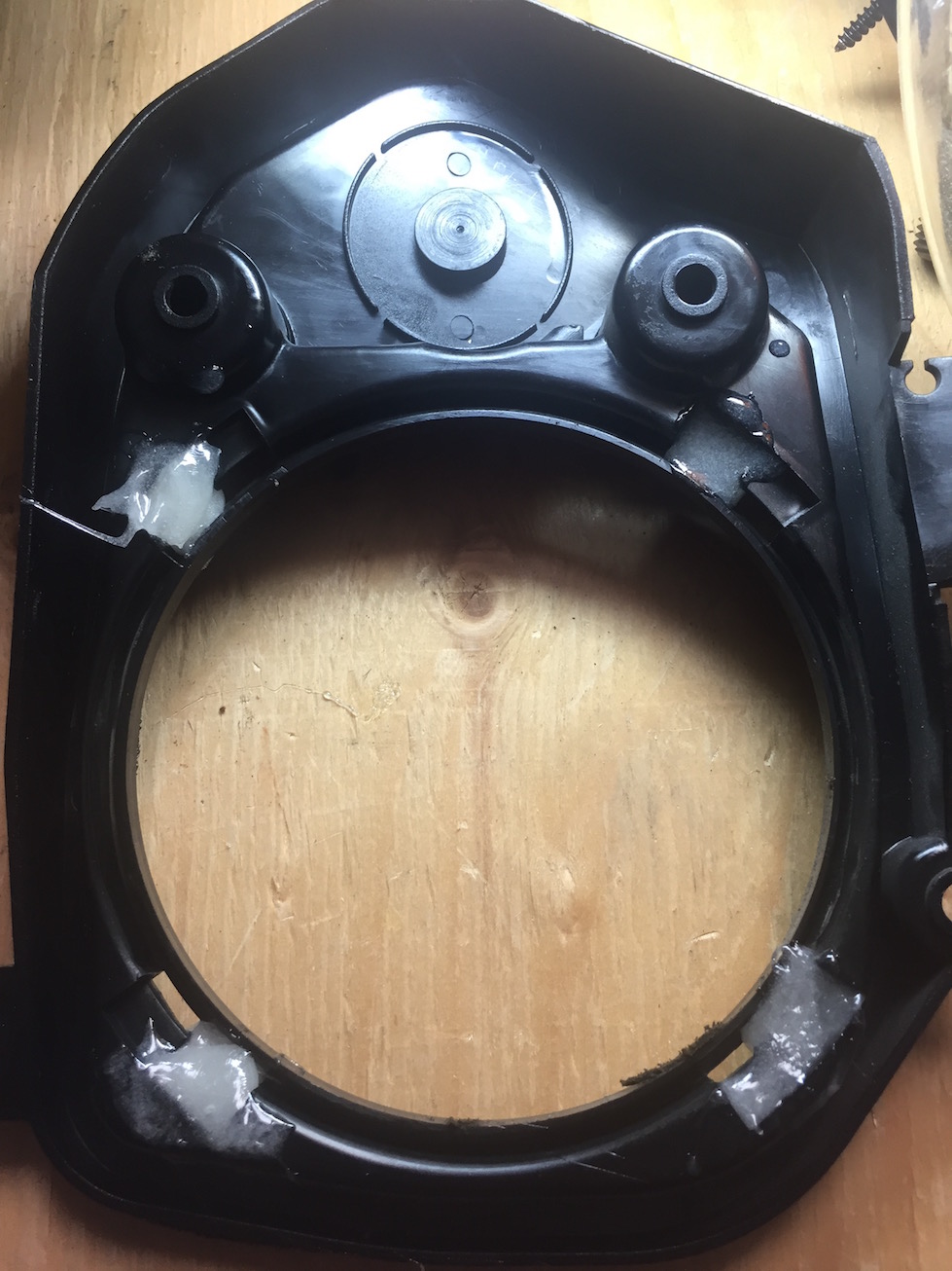

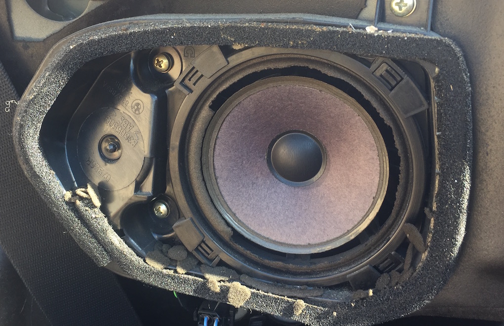

Hi folks. My BM@ has rear speakers that need to be replaced.
They are 100 mm (4") and 56 mm depth for the OEM measurement. The problem I have is the mount, which is OEM insert, and lock by rotate. I will have to break the locking tabs to get the OEM speakers out, but that leaves me with a strange mount.
I've researched buying new mounts, but there are none, outside of buying a whole new set, and it gets expensive with sub-standard used OEM speakers that would also be ~25 years old. I'd rather buy new more powerful speakers. I just need a way to marry new speakers with the current mount.
Here are some pics of the current situation. Can anybody suggest how I can get this done? I'm thinking crack out the current speaker, and maybe hot-glue those mounting slots closed, then fit and drill new 100mm full-range speakers and use some speaker gasket foam tape as well.

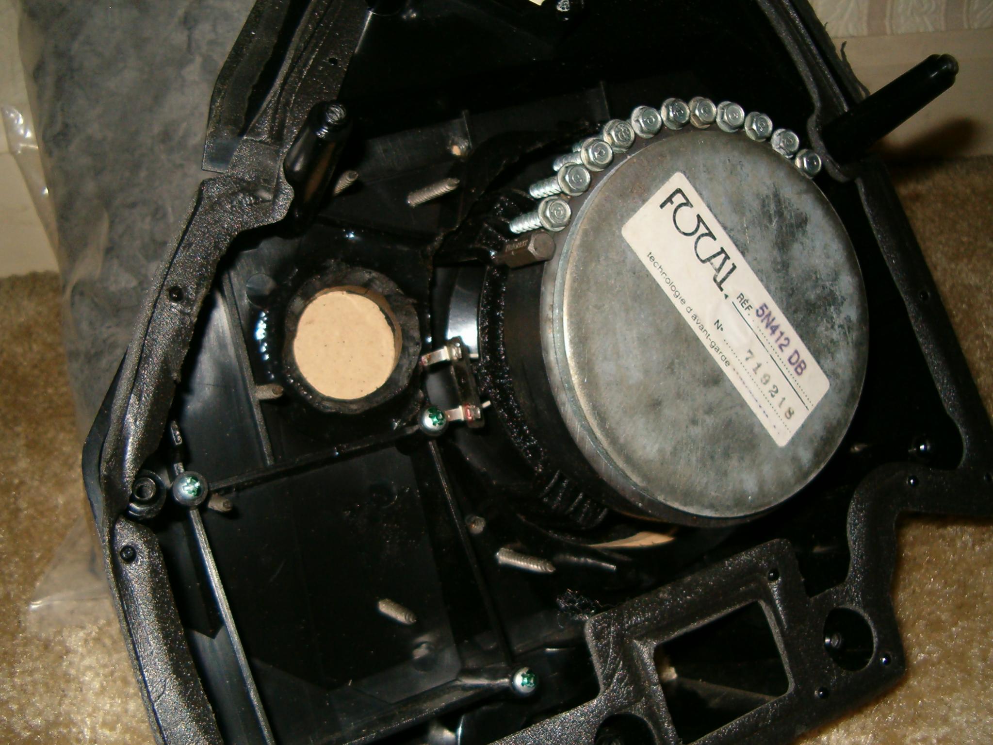

In my VW Golf (Rabbit USA) I fitted Focal brand speakers (separate crossover) and they sounded far better than the Nokia stock ones, but then I also changed the head unit for an Alpine type after a while. I had to use some adapters in order to fit them. Ask the shop or BMW for the adapters. I believe if You use 4 hands and 4 screwdrivers, You can actually loosen the locking tabs without breaking the speakers. Other option would be to order a kit and re-foam them.

It's just the speakers. I don't know if BMW has mounting kits, but I should call them.
So for a kit, where would I find those? I can't find any reference online because the car is that old. Hence the issue of finding solutions.

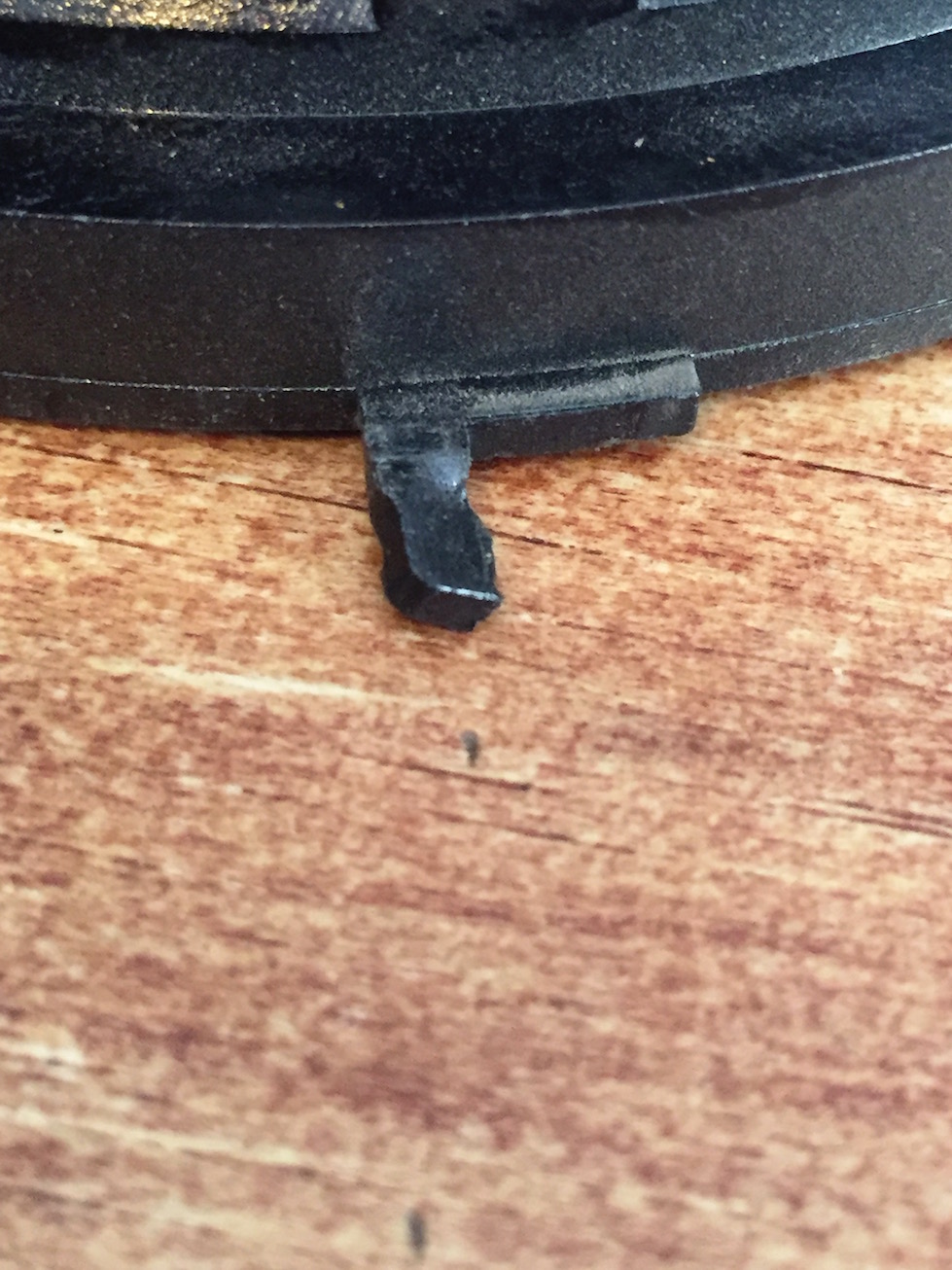

Breaking the small inner tabs makes the speakers come out. It's the speakers that have the tabs, so I'm not worried. It's just an odd mounting bit that's the challenge.

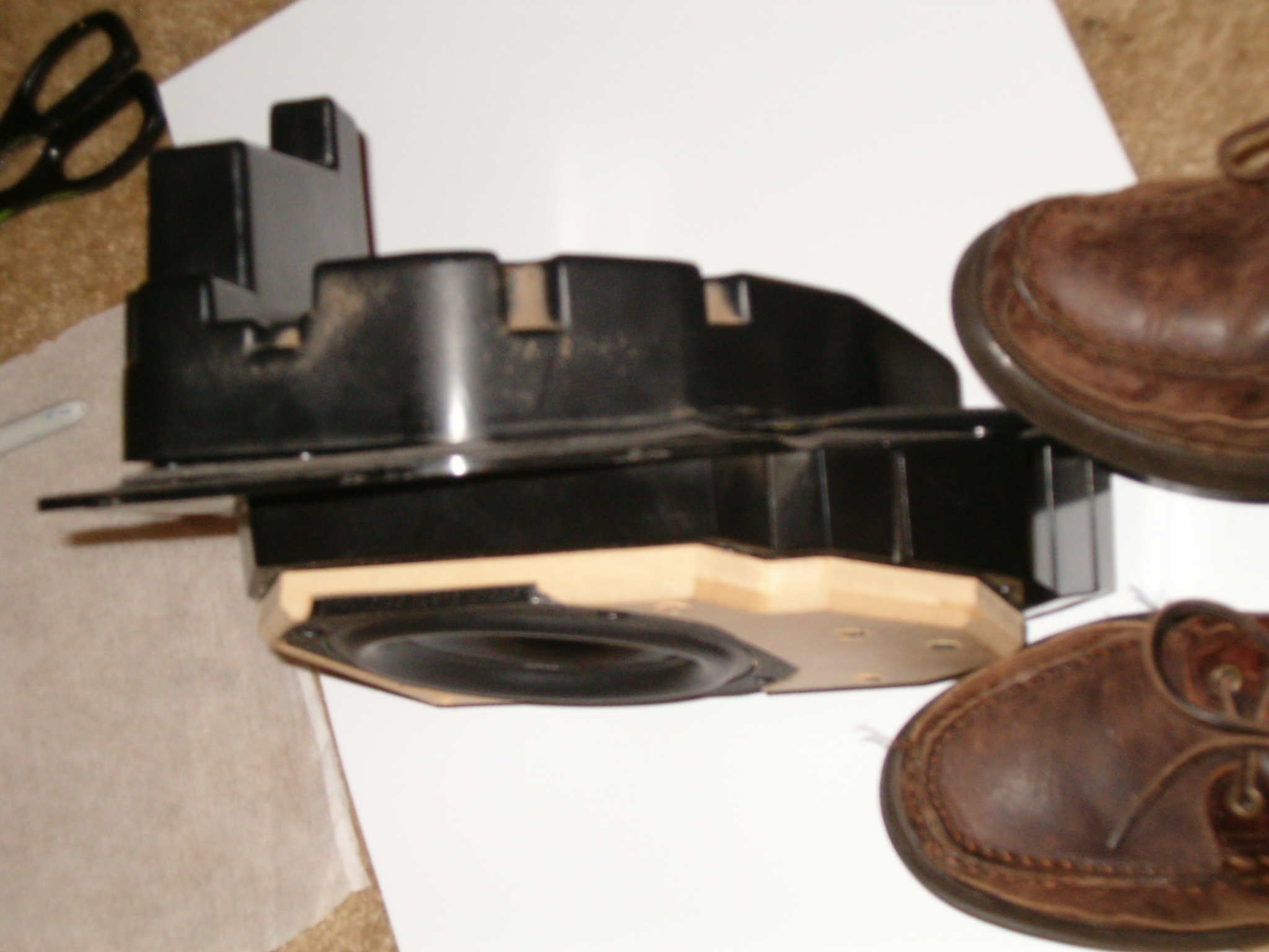

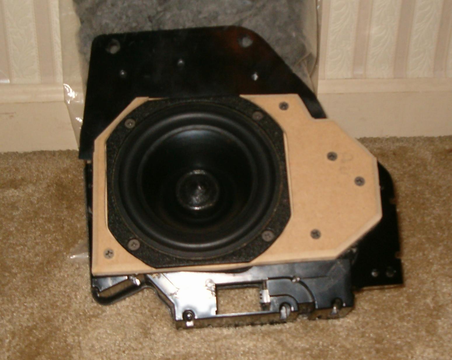

Use epoxy or PL Premium to glue a flat piece of FRP or aluminum onto the old OEM frame/mount. Cut a round hole in that and install your new driver. If you wanted to, PCB manufacturing is a very cost effective way to make custom precision plates in FRP (fiberglass reinforced plastic/epoxy).
Worst case, find someone who has modeled the whole mount in 3D on thingyverse and print it, modified with your own driver mount.
No, it will instantly crack, it´s a filler not a structural material.OK, will self-tapping screws work on Bondo?
But you can rotate your new speakers 20 or 30 degrees and holes will be on solid material, which will take self tapping screws.
or cut an adapter disk, actually a toroid/doughnut/washer out of a suitable material (per above suggestion) , mount it to existing frame and and mount speaker to it.
Or remove the whole oval thingie where speaker mounts to, cut a proper sized oval with a round hole in its center and mount new speaker there.
Nothing designed in 3D, but I kind of like the aluminum bit. Thing is, it doesn't really solve much as attachment of the aluminum faces the same issue. Maybe the image can give you a better view.
No, it will instantly crack, it´s a filler not a structural material...

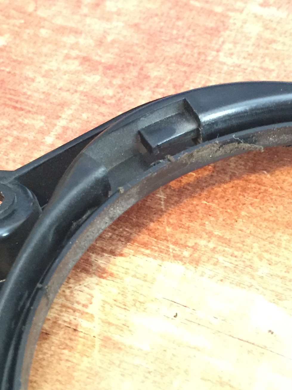

Hi there. The issue is the minimized mounting points on the current mount. I think I have found a proper sized speaker for this, so I will move with that. I will assess the fit when it gets here, but the aluminum sounds promising.
This mount is the only thing holding the speaker in. It's meant for the M3 as well, which has component speakers. My version has the tweeter section filled in. My hole is for a composite 4" (100mm) speaker. I don't own a speaker shop, know anybody, etc. So I have to work with what I have.
Adapter plate:
Hi there. Ya that is an option, but the image I posted is the issue, as the current mount has limitations. It's not flush all the way around. Check about 3 posts ago.
They rarely are flush. The factory mount in my picture was originally for a 4" speaker and was ported. The drivers were recessed into the front of the mount like yours are. That's a 5¼" speaker in it's place. You'll need to do a bit of trimming, and possibly make the adapter recess into the space a little. Modification is the name of the game in car stereo installation.

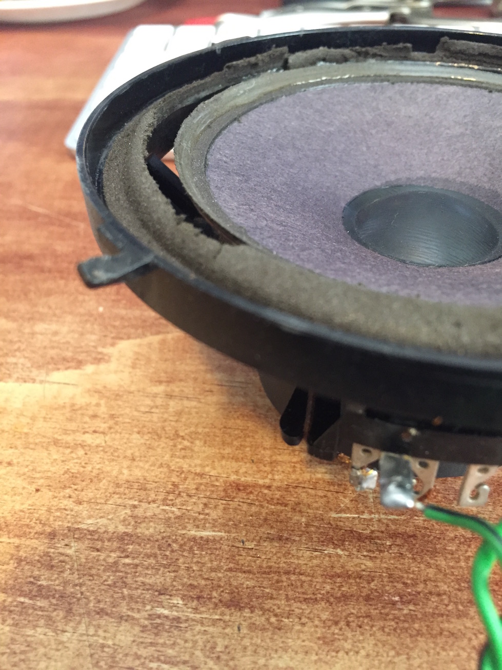

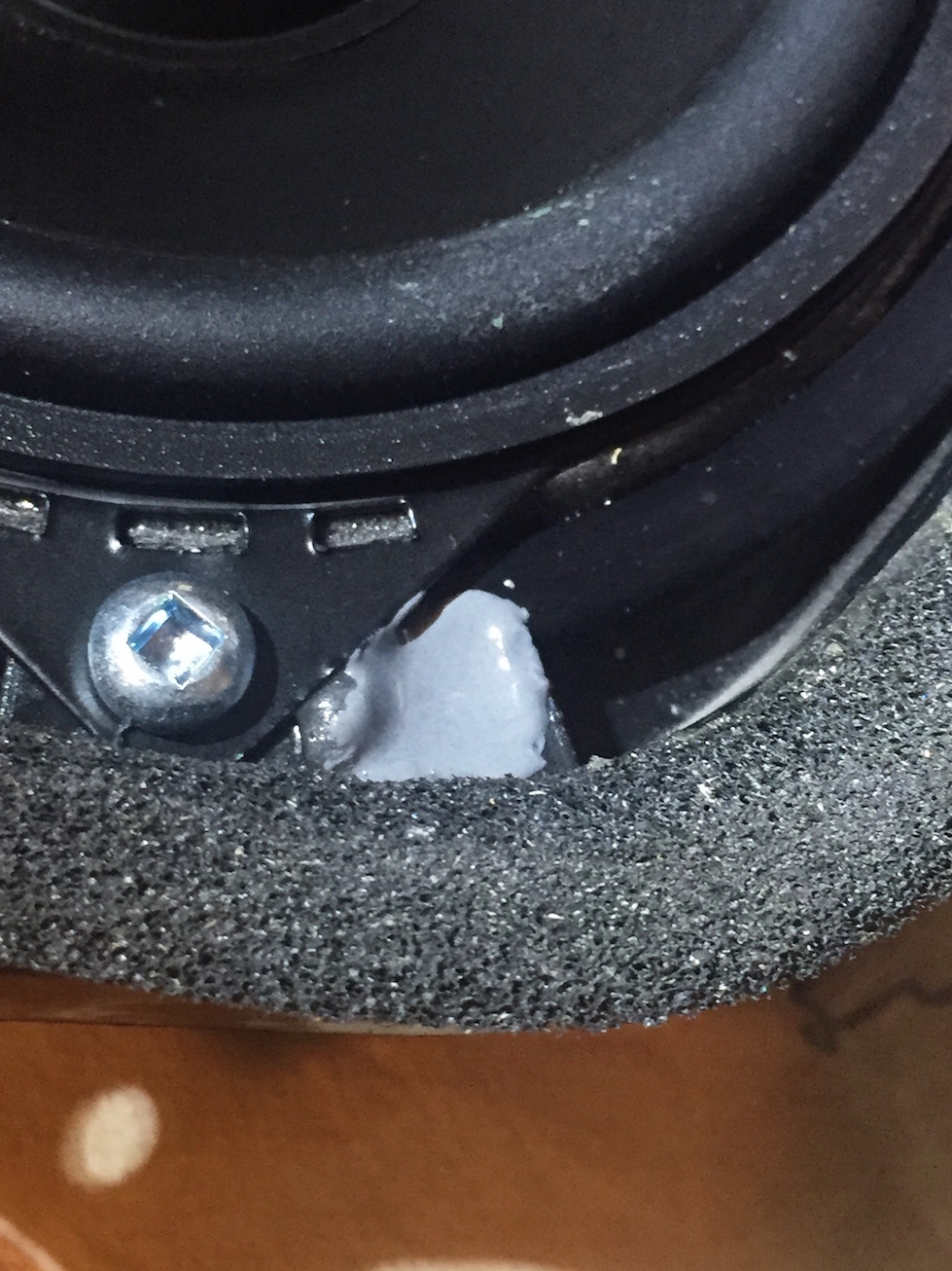

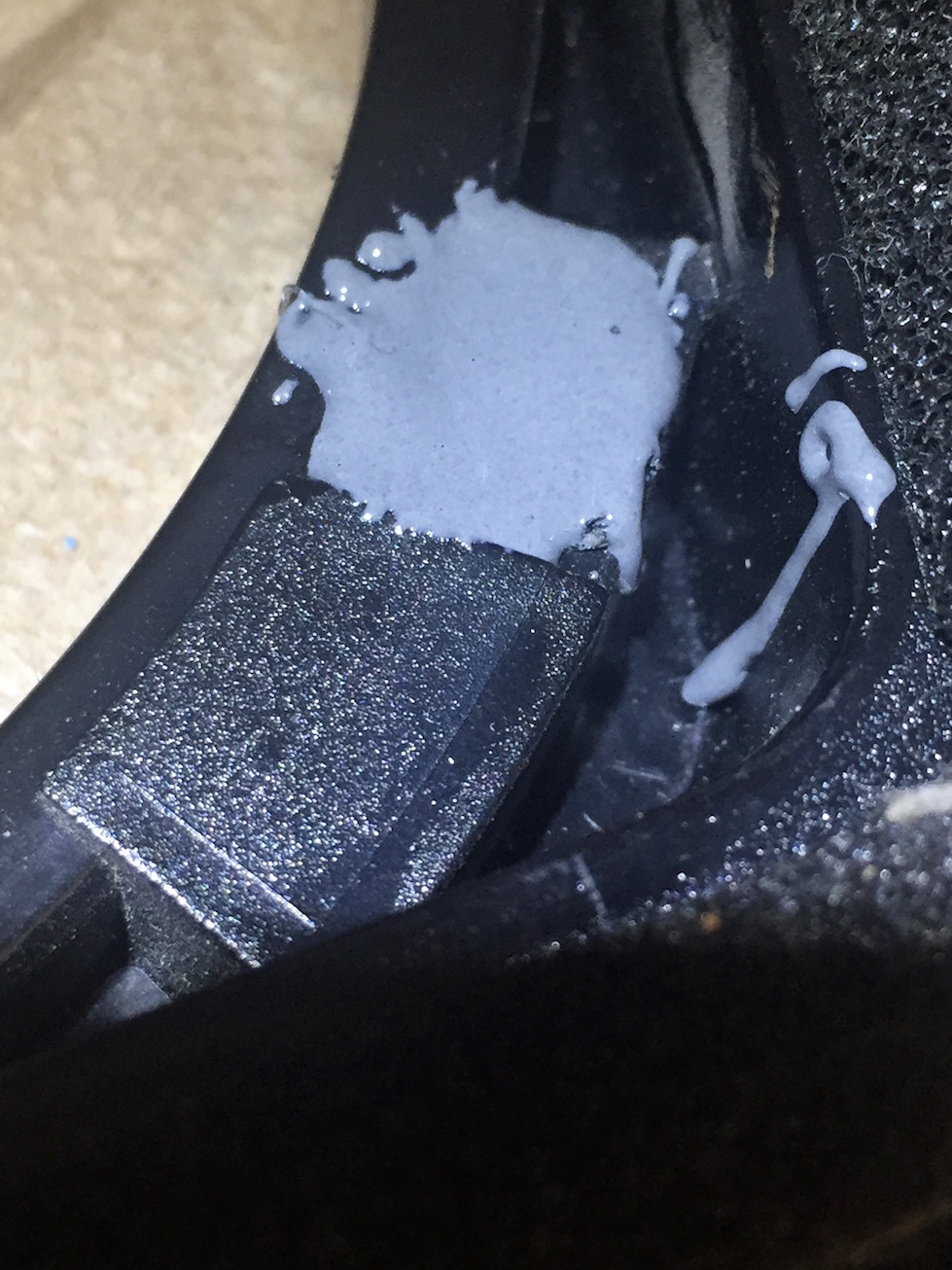

Seems these are flush due to the nature of the twist and lock feature. I ordered some speakers from Crutchfield Canada and will take out the current drivers when they arrive. I got me a dremel with those bits, so I think I'm good. More on this when the speakers arrive.

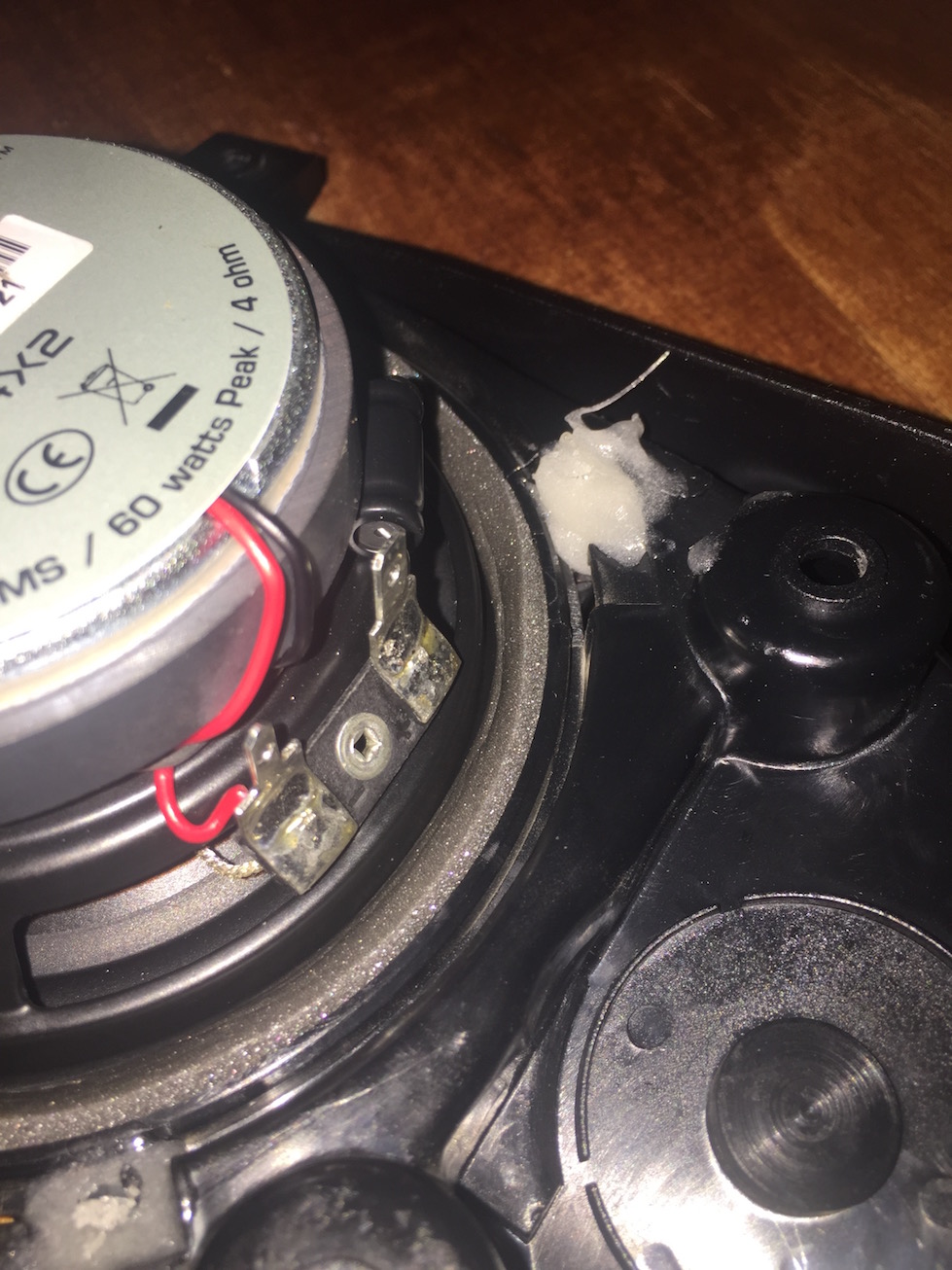

Success! Epoxy that I had filled in the backside of the flush mounting flanges for this Fosgate 100mm speaker.
Then the engagement slot on the other side, with some JB Weld. That crap is runny for some time, and wish I had more epoxy for that. I bought some 5-minute epoxy later on, and started with 1-minute epoxy. Gotta work fast with 1-minute, and 5-minute stays runny. So maybe let it sit for 2 to 3 minutes to get some viscosity to it first.
Drilled with self-tapping screws. Held pretty solid. Interesting that the speakers had some long self-tapping screws, with some flasher-type nuts for grabbing, on the other side. If this current mount fails, I'll chase those up.
Sound is good (60W) but wish they didn't distort on low end with volume. I might play with the EQ a bit more. But very happy all the same.
