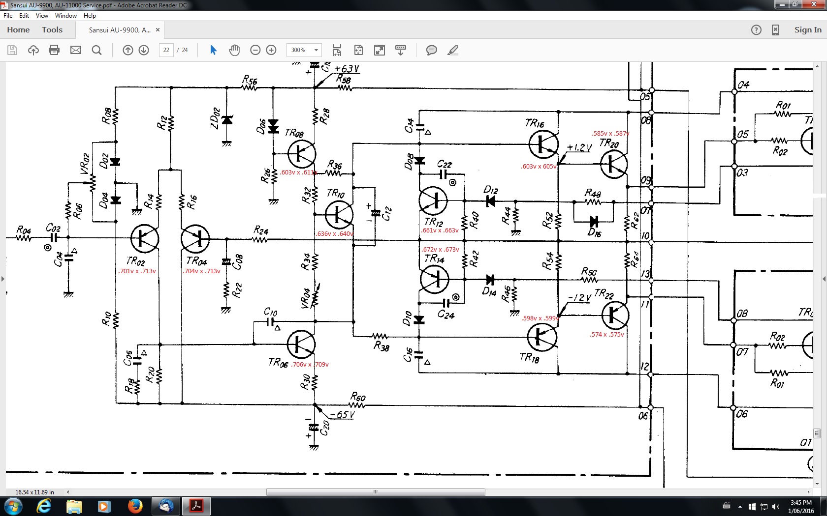

Is the bulb of the limiter contiuing to glow after settling? If only faintly, it's probably reasonable to test without it now, and check those voltages again. They will vary with bias level and probably according to predriver and driver transitor Beta, since the 1k base resistors R37,38 mean the whole bias spreader arrangement is unbalanced until the correct current is set, I guess.
There is a nominal 2V rail offset, so I'm not sure what difference there should be, if any, between those bias voltages.
Vbias of the driver and output stages should be around 4 x diode drops or ~2.6V total. You have ~ 2.3 and 2.7 which isn't so bad even if unenevenly spread. I think there is still a problem there, perhaps as you do. Hopefully reoldering will find it, assuming all the semis are still fine by Vbe checks etc.
Soldering failures are still dogging you and they'll continue to, until you systematically reflow them on the power amplifier boards at least. Inspection by microscope might be interesting but until all joints are reflowed, you can't be certain you have found them all. It might sound like a chore but it's got to be quicker and less agony than finding them one by one 😉
Ive resoldered the whole driver board and set the bias to 25ma and 26ma thats as far as they go then I set the DC offset on the left to under 1mv then I tried the right channel which was 600mv,I got it down to 120mv and smoke started coming from the driver board,the bulb only lit up a bit though. I found R54 68 ohm resistor had burnt a bit and everything else was OK I went over some more solder joints just in case and tried again I reset the DC so that both sides were under 1mv then connected up a DMM on both channels to do the bias and just after I turned it on the bulb went full on bright. I quickly turned it off and unplugged the power to the driver board then turned it back on,I tested the voltages on the power supply F-2567 and they all appeared to be OK! So its still on the driver board somewhere but I cant work it out ? Ive taken both of the output transistor modules apart and resoldered everything including the big capacitor power supply. Well at least its narrowing it down but Im wary of giving it full power because there must be an intermittent short somewhere on that driver board? Ive gone over every inch with a magnifying glass and running a fine jewlers screw driver around the solder joints to clean off any stray solder etc...Ive put the driver board Collector and Emitter readings on the schematic,they read OK to me? This is starting to become a pain and Im a very patient person as a rule.lol 😀 PS I nearly forgot to say I was getting 40 plus volts on the output Power module emmitter resistors every now and then?

A long time ago, I found a problem on two different Sansui products :
resistors of the power supply decoupling circuit (R58 and R60 in the figure) had gone wrong with the time, they became of much higher value without apparent signs of degradation.
I had the same problem on my driver board years ago they are 220 ohms mine read 1800 ohms.lol
