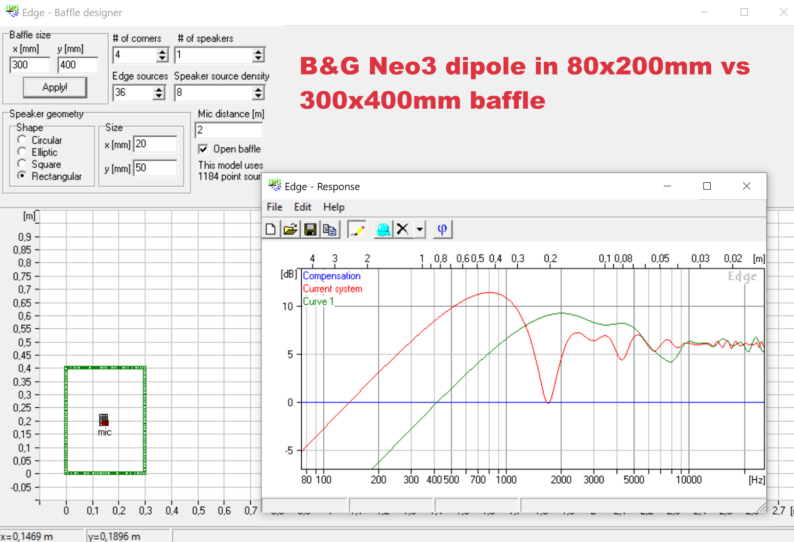

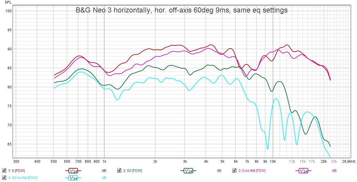

Baffle dimensions are very important in dipole radiation (dipole loss of low freq)
xrk's baffle looks much wider than others here, and side panels add to virtual width too. Effect of waveguide is guite small with dipoles (in smaller range of freq)
Factory datasheet measurements are always in much much wider baffle (virtually infinite baffle)
VCAD2 and even The Edge can simulate different baffels and monopole/dipole effect

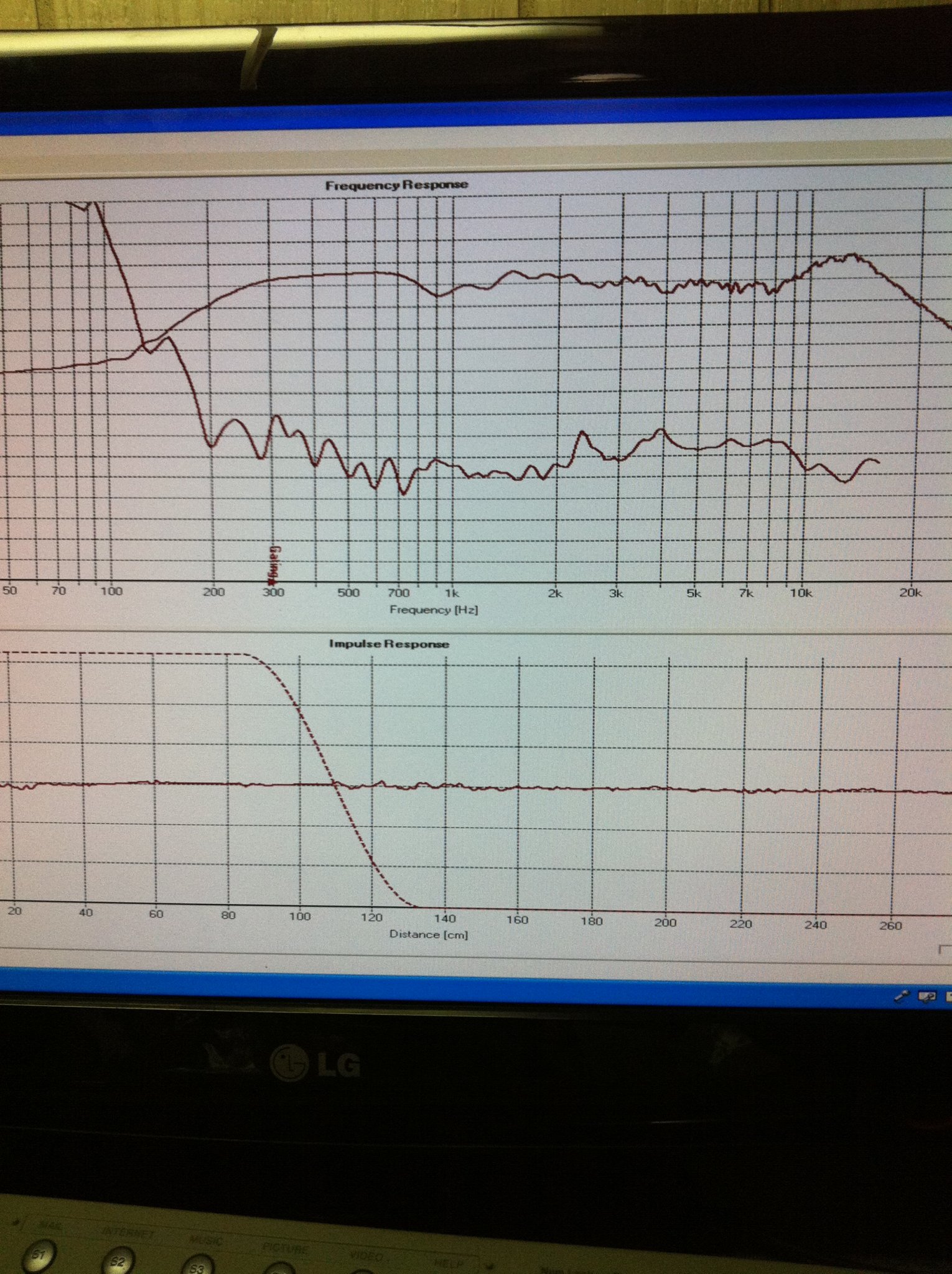

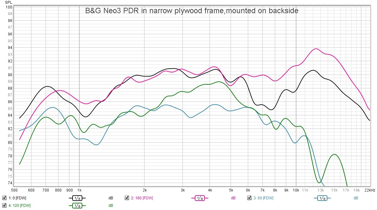

On my XSD speaker, the baffle is 12in wide and where the tweeter is, there are no extra wings. The shallow waveguide had a nice effect of increasing the lower bandwidth and smoothing the upper response. When I used the same waveguide on the sealed back version of the PTT2522-4 on a speaker with a beveled baffle, it looked like this:
Here’s the cabinet with beveled baffle:

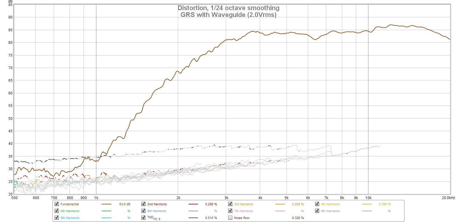

I've just been informed that this dipole tweeter has a bit of a distortion bump at ~2,000Hz; However, I hope 2.5kHz/24dB will still be okay since I'm also using a 30uF MPK cap wired in series to protect the tweeter from turn-on thumps. This also acts as a 1st Order filter at ~1.2-1.3 kHz (an octave below X/O) and should help to further reduce the tweeter distortion.
Any advice from experience here will be appreciated.
