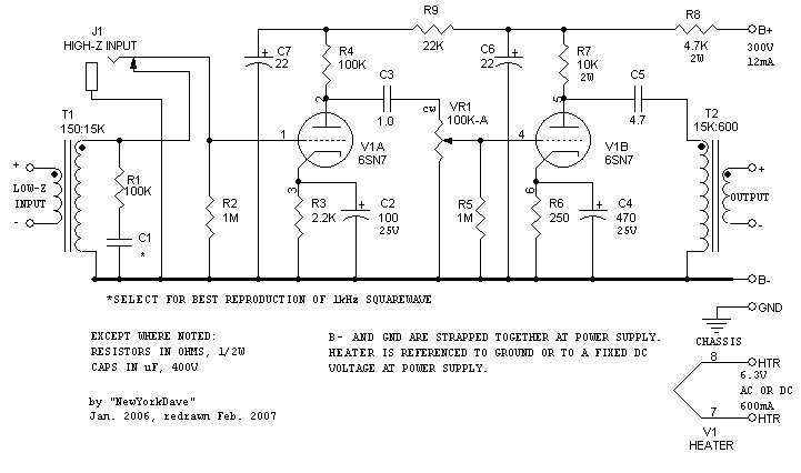

Hey Im building one of NYD's 6SN7 One Bottle mic pres. I bread boarded it and
it is awesome!!! Then I made a turret board for it. Wired up another one, enclosed it. Fired it up. And began to debug.
Here's my issue. The 1uF cap between the stages used for coupling has DC voltage present before the next stage headed to the 100K pot. Its about 11vdc. One might think okay replace the leaky cap. Well I did and it's still there. I assure you I checked that turrets connections and it only has the cap, and the lead to the pot!! ???????
My breadboarded version has no DC after this cap. So I used that one in my build and sure enough still 11VDC.
Anybody got any thoughts on this?

You haven't built what you think you have built, or you have a faulty component.
As you have tried changing the cap, try changing the pot or the turret. Check what the other end of the pot is connected to: ground or a cathode?
Agreed. It sounds as though the grounded end of the pot is internally open circuit or goes somewhere else. If it was o/c though, the 1M resistor should ensure a good zero volts. So perhaps it's more likely that you think they're connected to ground when they are in fact connected to another point, such as the cathode of the second valve.
Well I just went cap to pot and it's fine the turret measures 11VDC just sitting on the board with nothing attached!!!!!???????

Reverse-engineer your circuit from what you have built. Don't refer to the original diagram when doing this. Show us the result, unless you spot the mistake yourself.
We can't diagnose a fault from a diagram of something different (e.g. phase switch - anything else). 10-11VDC difference suggests a wiring error.

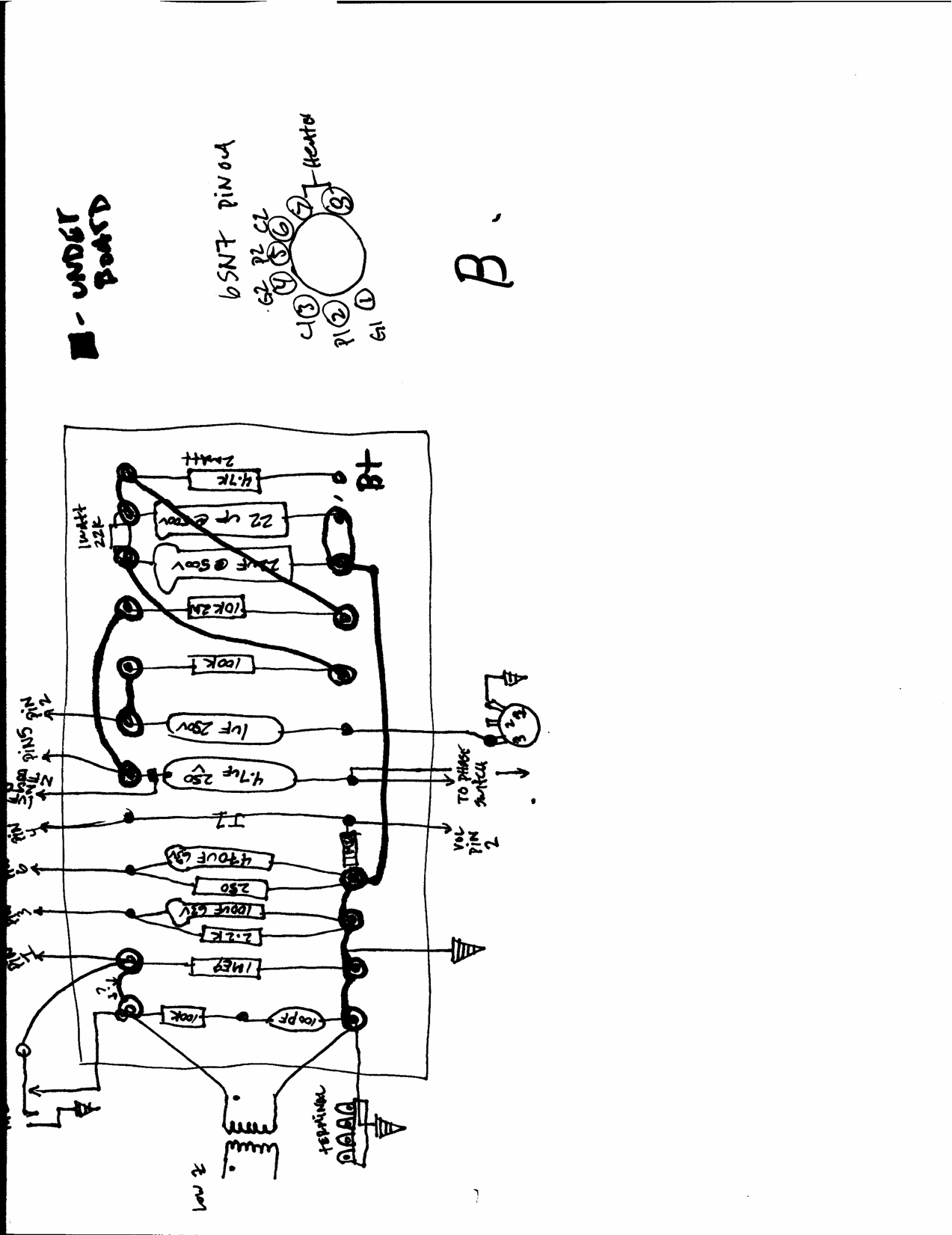

Still having some output issues with the turreted unit.
Still missing some db's and the volume is all the way up. Nowhere near where the breadboarded version sounded.
Also, when the turreted version is all the way up the unit is very microphonic. Infinitely more than the perfect performing breadboard.
I have troubleshot all the peripheral functions. Like -20db pad, phase, in xfmr and out xfmr, all jacks and connectors.
So Im looking at the circuit/turret board as the culprit.
Wondered if I could borrow you eyes and minds!
Take a peak at my layout of the board and see if you spot my error please.
The board is for the schematic at the top of this thread!

Also, the 4.7uF cap is going to the OT not phase switch.
Also wanted to note that all voltages are on spec.

You say all voltages are on spec. You are describing DC voltages I presume.
Put an AC signal on the circuit and compare AC voltages to that of the breadboard unit. That should locate the gain problem.
You have two bypassed cathode resistors. Check those. They increase gain by reducing negative feedback.
