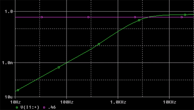

I've now reached the point where I am about to throw this circuit across the room, so I thought it might be healthier to seek some input here.

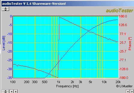

Quite simply, my problem is that the circuit below does not meet the calculated or simulated -3dB point. It should be an excruciatingly simple 12dB HP filter (ignore the passive piece as it is not in circuit) with a -3dB point around 3800Hz. Instead, the actual circuit has a -3dB closer to 7500Hz, and that is being generous about where the 0dB point is measured.
Can anyone offer any insight as to what could possibly be going wrong? I just can't fathom how this behavior could be happening.
The transistor is BC549A biased at ~1.3mA. The current source is a conventional type and is tested working.

I dunno, bub.........
I built one, and it works. If the 6.8K resistor was missing, you might get something similar. But the slope of the response shows that it is in, and also suggests a slower transition from probably more damping. All of which suggest that some values are off.
I plugged the numbers in as if you had the frequency coefficient upside down, and that does not explain it either.

If the eq. doesn't work, maybe the model is wrong
BC546's effective input impedance is too low in this circuit for it to operate as predicted. I swapped the buffer BJTs for JFETs and it works great. Anyone have an opinion on a good BJT for this application?
