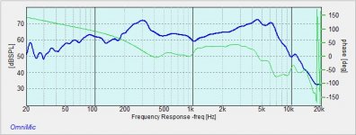

Dumptruck and I have been wrestling with doing a OB design and I can't for the life of me understand why I am getting this weird saddle shaped response on my OB mid. There is a 10db dip at 1k. But the response is down by a wide freq range in the middle see graph. The baffle is 11 1/2 w and wings are 4 inches deep on the side. Do you think this is due to the OB? If you look at the spec sheet the response is nothing like that, unless it is my room.

What are the measurement conditions? I'm assuming that's some sort of in room response, not gated?
measurement
In room. I am 2 ft from baffle and i vary the gating without much change other than a few ripples. I use Omnimic.
Behavior >1kHz looks close to published data; 300Hz is dipole peak, and below is roughly dipole behavior. Peak at about 30Hz could be room, but looks to me more like poor signal/noise ratio.

I'm not sure about everything, but I do agree that it is "similar" to published data. Maybe not as extreme. I remember seeing the measured response of my drivers on the baffle, and they had the same smile🙂

I don't know of sensitivities, but the response of the Peerless HDS is "real" to me. The lower peak is dipole peak and higher peak is driver's rising response at 0¤ http://www.audio-components.co.uk/pdf/products/830883.pdf

Ok i see the upper end response matches fairly well. I also assumed the lower peak was a dipole peak. I xo at 300 and 2500 so maybe I adjust the points just enough to mask it 😀

Where did your dipole peak occur? The peak is affected by baffle dimension etc so i was thinking if i have to play with the baffle or side wings.....

If I remember the original files correctly, the peak on my baffles was between 250-300Hz. My baffles are ~19" wide with the driver at around 3-4" offset.

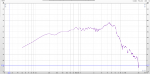

If it can be helpful in any way here is the frequency response I've measured from my peerless 830883 (on a 20 cm wide baffle) - It is from the Nomex 164 by Troels Gravesen so its in a ported 2.5-way setup 🙂
EDIT: The measurement is taken from 1m and the response window is 10 ms - hopefully eliminating most reflections.

Well, I notice the rising response on the upper end which tracks the spec, but the lower end is flat where mine has the dipole peak.
So that clarifies the "saddle shape" of my measurements. I will need to play around with the XO to minimize the effects. Thanks to all for your help i think I understand the measurement profile.
