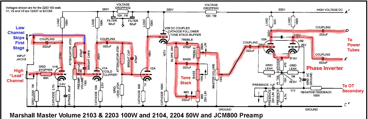

Hi people,
I have a guitar amp here that sounds awesome for two minutes after I put a new master volume potentiometer in. After the two minutes the sound gets dull and the potentiometer becomes intermittent when I push the shaft.
Since the amp has three 12ax7 halfs running straight into eachother, without attenuation between them, I think the potentiometer is simply overstressed.
Measuring the signal voltage at the master volume potentiometers input only gives me 31 volts though, which seems awfully low to me ( Is this because I am not using a true RMS multimeter and the signal is severely distorted?)
Anyway, what I would like to do is cut the voltage at the potentiometer in half, the amp is 100 watt and way too loud anyway.
Would a voltage divider before the master volume pot be the best option?
What would be good values for the resistors to keep the sound as unadulterated as possible? ( Thinking about for example Miller effect of the phase inverter)
Below is the unmodded schematic of this amp. All gain stages have cathode bypasses now and all attenuators have been taken out.
Thank you in advance for your time and attention.

There's no reason for the new volume control to be malfunctioning. It must be defective,
so I would replace it. Perhaps it was damaged during installation.
Did you cut off part of the shaft, or otherwise put pressure on the shaft?
....Measuring the signal voltage at the master volume potentiometers input only gives me 31 volts though, which seems awfully low to me....
Low?? It is rare to shove more than 1 Volt at a volume control.
However, 30 Volts in 1 Meg is 0.001 Watts, in a part surely rated for 0.125 Watts.
Agree that mechanical damage is possible.
Another is poor connection so a grid (maybe not this one) is not really drained.
Are all grid leak resistors OK? Bias voltages that at random slowly drift to some totally wrong value can be quite confusing; I once spent quite some time debugging the internal amplifier of a condensor microphone amplifier when all that was wrong was a disconnected gate bias resistor.

I have found out that the dull sound was actually due to a ground that was not properly connected. After some manipulation I could just pull the ground wire out of its lug!
Tomorrow I will put the PEC pot back that I deemed broken to see if I can replicate the intermittant signal problem .
The Alpha pot that I put in after the PEC pot actually makes loud popping sounds when I manipulate the shaft too, but it is a used pot.
I will report back with my findings.

The problem here was clearly caused by one tube losing its ground reference,so it would work, sort of, for a couple minutes, until space charge made its grid more and more negative and eventually cut it off.
Even grid leak bias uses a 10M or so resistor to keep leak within reasonable values.

I have swapped the PEC pot back in after reflowing a ground connection yesterday and so far it works: the amp has all the highs it could ever need.
I say so far because I have a feeling that this gremlin might pop up again. Fingers crossed.
One question I still have is this one: is in my application the power rating of the potentiometer dependent on the setting?
I ask this because when you set the pot very low there is only a very small track between the wiper and ground. Would this not affect the possible dissipation of this very small variable resistor?
I know I am wrong but would like to learn.
