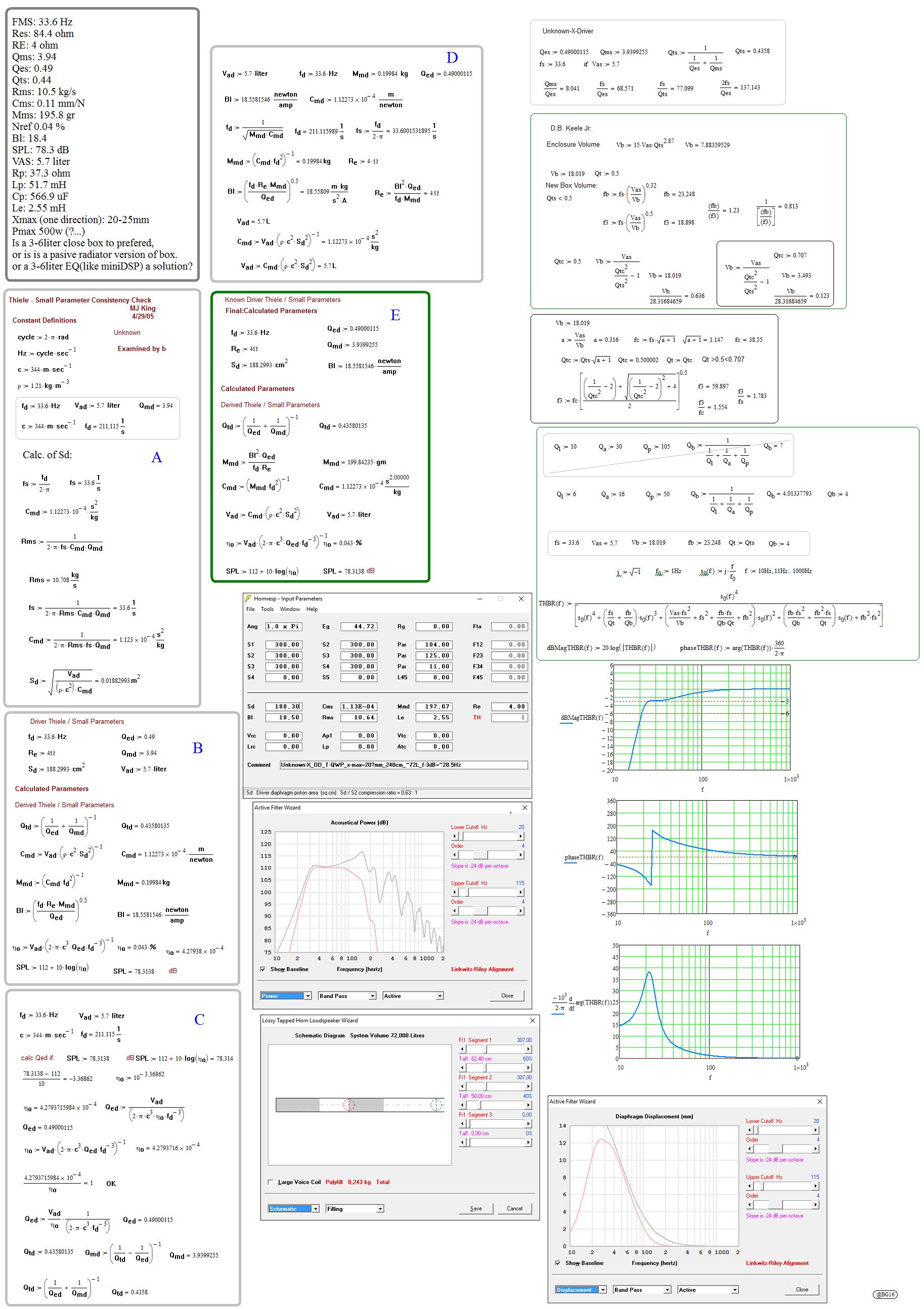

I have a strange looking T/S of an 8" speaker
sending to me..
This is the claimed paramerters
[book=FMS: 33.6 Hz
Res: 84.4 ohm
RE: 4 ohm
Qms: 3.94
Qes: 0.49
Qts: 0.44
Rms: 10.5 kg/s
Cms: 0.11 mm/N
Mms: 195.8 gr
Nref 0.04 %
Bl: 18.4
SPL: 78.3 dB
VAS: 5.7 liter
Rp: 37.3 ohm
Lp: 51.7 mH
Cp: 566.9 uF
Le: 2.55 mH
Xmax (one direction): 20-25mm
Pmax 500w (?...)
]%[/book]
Is a 3-6liter close box to prefered,
or is is a pasive radiator version of box.
or a 3-6liter EQ(like miniDSP) a solution?

Hi All,
FYI:
b🙂
So it can produce 110dB with 1500W RMS or so.
Or so it claims.
If it can handle real 1500W RMS and IF even 20/25mm Xmax is still enough (not sure about that either, would love to see an X displacement graph at such frequencies and pressure levels)
