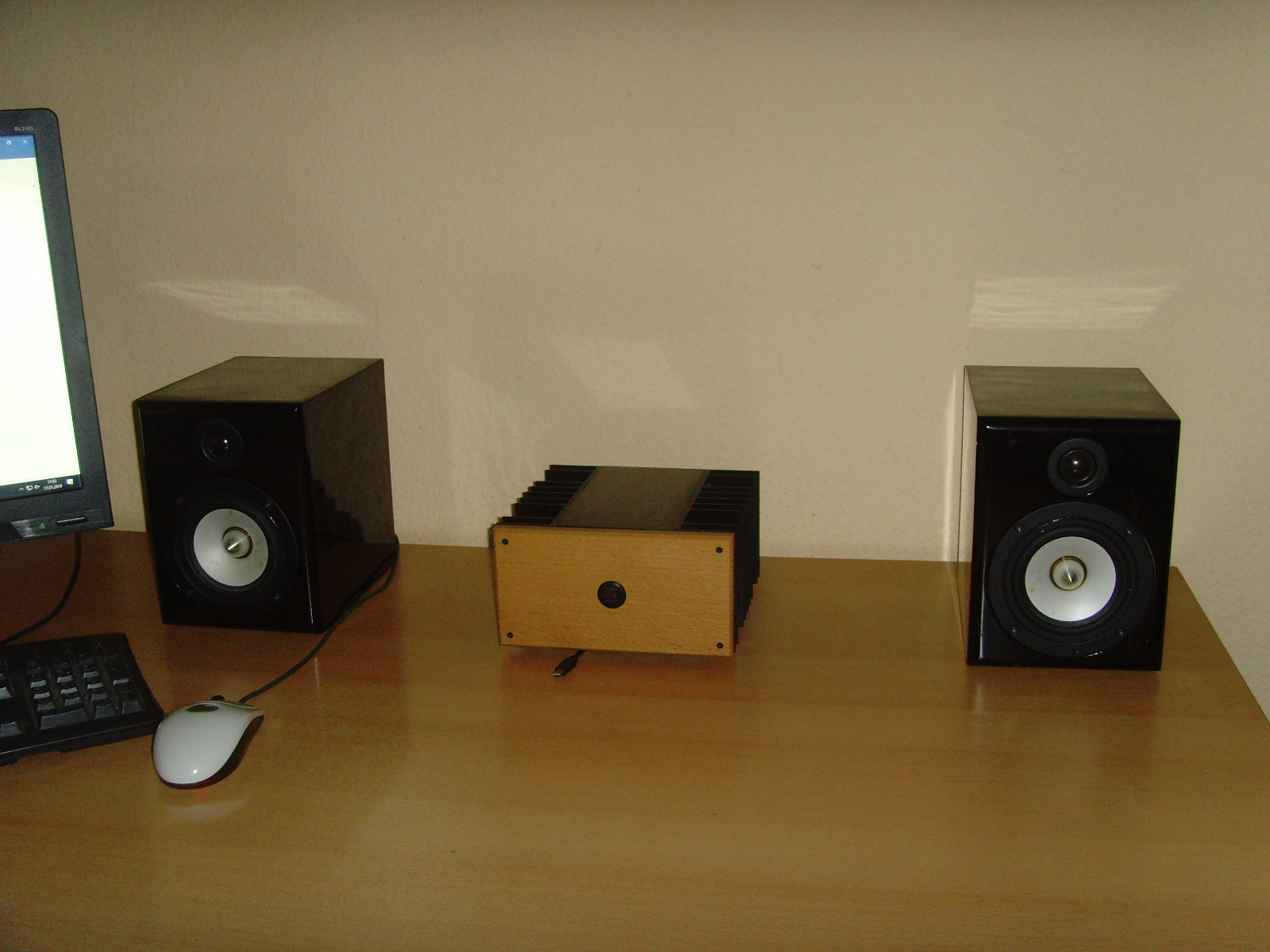

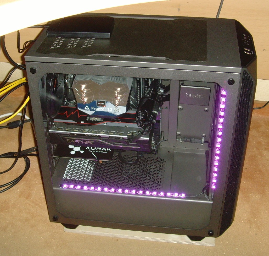

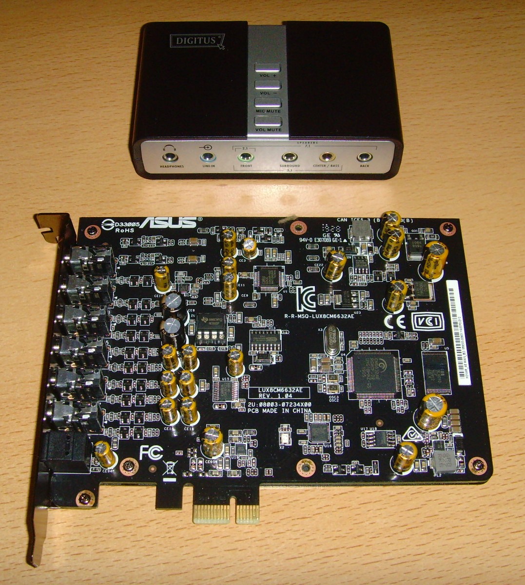

Gentlemen, I own a PC (image 1), running Windows10, whose soundcard (ASUS XONAR AE) is connected to an ACA ClassA amplifier
with DIYed-speakers being connected to it (image 2).

I connected the ACA to the Mainboard Realtek 892 music chip, to an external USB soundcard (image 3 - I have installed current drivers),
I even did a new and "clean" (nothing but current drivers and the game) Windows10 install,but the "noise-problem" persisted.

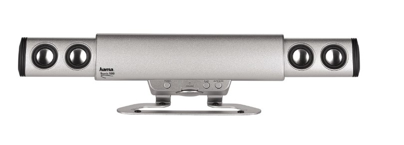

I then bought a new HAMA Sonic 500 PC-soundsystem (costs: 33€, image 4) - and: my "sound problem" is gone.
I do not hear the least noice on the HAMA sound system.
So currently I can (have to) choose between 2 sound-Sources on my PC: "ASUS XONAR AE connected to my ACA" and
"Mainboard Realtek 892 connected to the HAMA Sonic 500".

I compare the HAMA and the ACA: both amplifiers use a wall power supply.
The "original" ACA (as is connected to my PC) uses a Dell laptop power supply, rated at 19,5 VDC / 6.7A.
The HAMA uses a wall power supply, rated at 15VDC / 1A.
Class II adapter, no PE wire, galvanically isolated from the mains, only Y-class EMI decoupling capacitors.

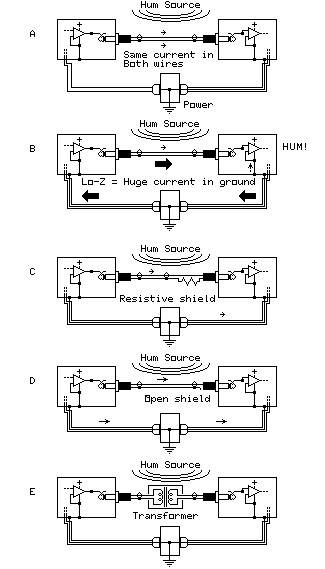

My 2 cents (and many confirmed cases) the ground trace from your graphics card PCI-e slot (and/or CPU socket) is (partially) shared with ground trace from other PCI-e slots/USB ports/integrated Realtec codec. When the graphics card (and/or CPU) load increases (game started), the noise voltage created by the large currents through the shared ground traces causes currents in your 0V return wire of the single-ended connection to the class I amp. Again, it is a very common problem. No software issue involved.
Solutions have been already given, all are about breaking the ground loop you experience:
- line-level isolation transformer
- class II amp
- balanced amp input
- galvanically-isolated digital output (optical, proper coax with isolation transformer)
- to some extent adding resistors in the 0V return line to limit the ground-loop currents - point 3 ABOUT GROUND LOOPS
Thank you, phofman, for pointing me to this article:
ABOUT GROUND LOOPS
The accompanying image shows possible sources and resolutions for existing ground-loops.

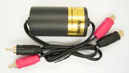

I tried reason c) - resistive shield - but his did not remedy the situation at all.

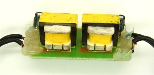

I then tried reason e) - transformer - and I do not have any hum anymore, neither while listening to the PCs music nor while playing AOE.
Thank you very much for your advices - Rudi_Ratlos
P.S.:No Ground-loop exists using the HAMA Sonic 500, since the HAMA PC speaker is a Electric Class II device and ist PSU is not connected to Protective Earth!
So: a Ground-loop is not possible using the HAMA.
