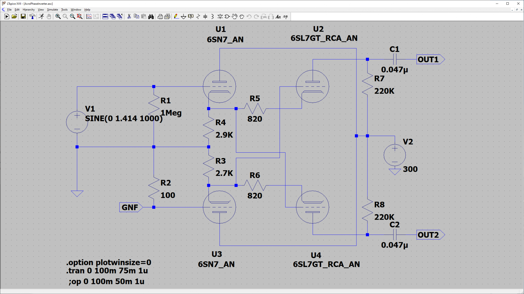

Hello!
I have seen the following circuit in "Acrosound_Ultra-Linear_Transformers_1955_gc.pdf" as part of a 100W PP amp example. What are the advantages (if any) against a more conventional one?

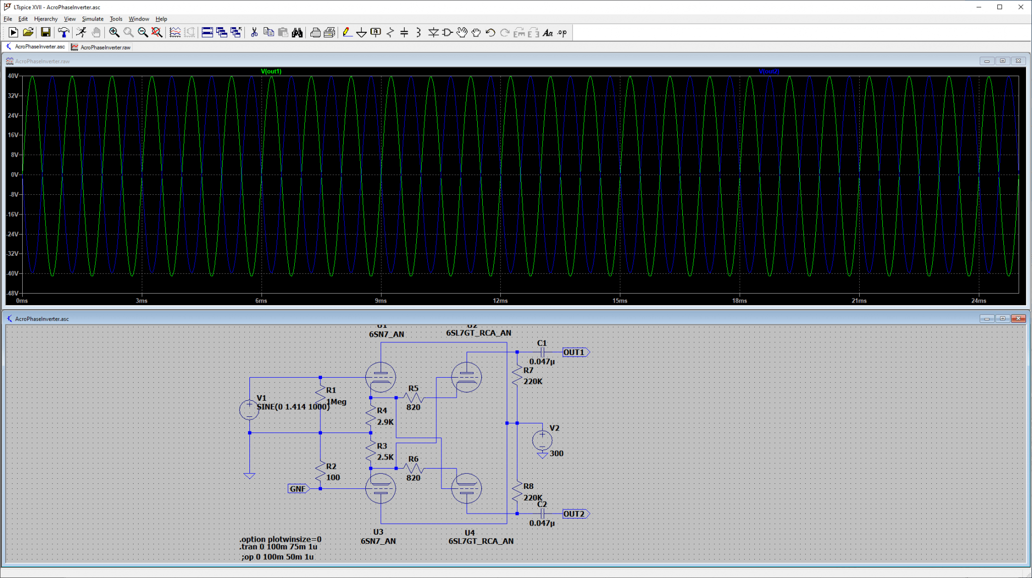

Simulation works. There is a balancing resistor between R4 and R3, omitted for simplicity.
Thank you!
Jose
Originally used in oscilloscopes, this is a cross-coupled phase inverter, also used by Audio Research
as a balanced driver stage (with cathode follower outputs and current source load) in their earlier amplifiers.
