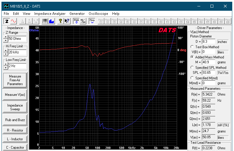

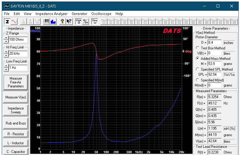

I had the same problem recently.
The new Dayton MB1025 had a strange measurement.
As though something was preventing the cone from moving.
I was about to return the item but decided to try it one more time.
I used my fingers to move the cone in and out.
After a few times, I measured it again and measurement was normal.
I didn't feel the voice coil rubbing against anything when I pushed the cone.
Maybe there was a grit inside.

Any time the impedance peak is reduced and not well defined with alot of small noisy ripples, there is a mechanical problem with the VC alignment, mostly a rubbing VC. Sometimes the contact isn't constant or static ie. It only occurs with a drive signal around resonance and creates an uneven or non-symetric diaphragm movement, sometimes wobbling and rocking. It can also temperature related, only happening when the VC expands enough to contact the upper / outer pole plate. Very rarely it can be loose windings rattling around or in the case of older drivers with paper VC formers (if you're lucky enough to catch it early) a partially detached VC former.
Most of the time drivers have left over debris that gets churned up during shipping after the driver was tested and packaged. This is where it pays off to have a driver with a removable VC and magnet. Some drivers have their VCs not so perfectly centered, and even though you won't hear any obviously bad things with music alone, the drivers performance can be tweaked a bit by just loosening the motor screws, applying a small sine wave close to Fs and wiggling the VC asy around until you're satisfied its centered as well as it can be. Distortion measurements can confirm this to be successful, as THD can decrease significantly as well.
Some drivers don't have self centering VCs, so you'd have to go through the above procedure anyways. I usually do this anyways as precaution, mainly because there's always some little bit of debris in there and it just gives you piece of mind knowing you're gettingthe best performance the driver is capable of, especially on expensive drivers with large diaphragms. At the very least it pays to check the VC and rear chamber mounting screws for even torque and to do a quick impedance sweep before running the driver for the first time with a higher level input signal. You can catch an issue this way before it becomes a bigger one and potentially avoid an expensive situation.
