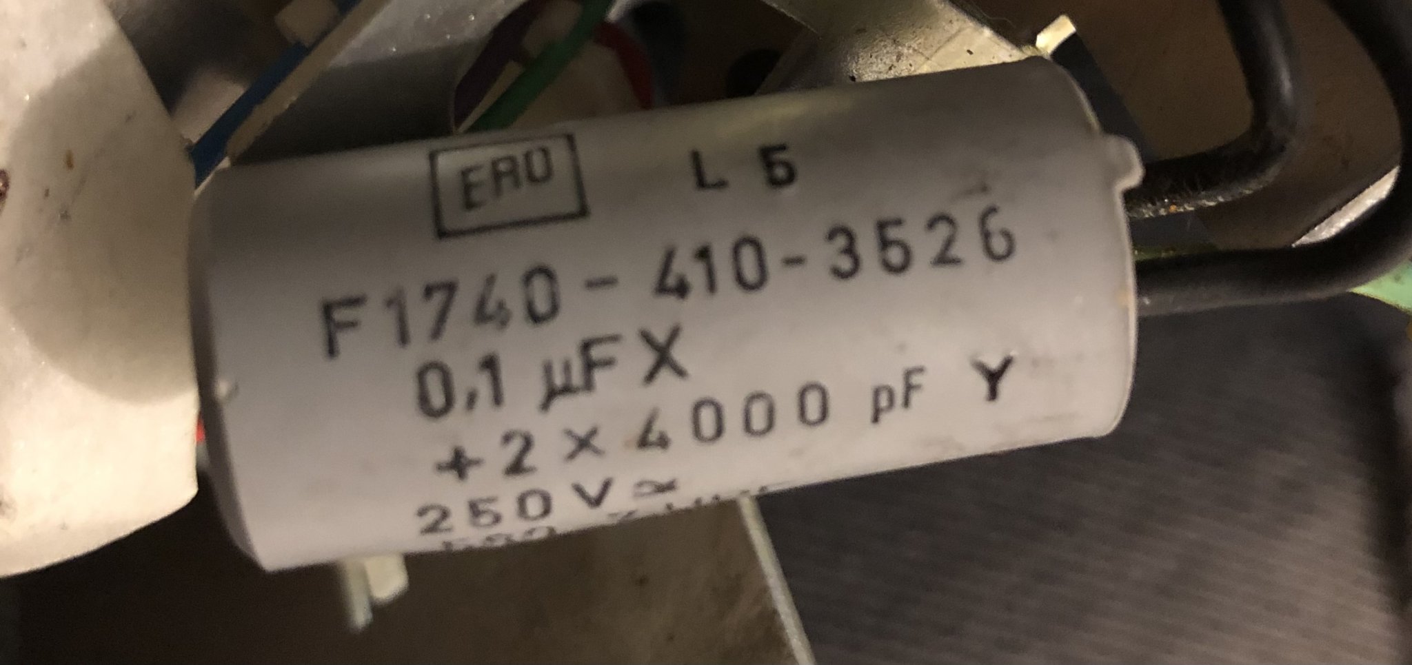

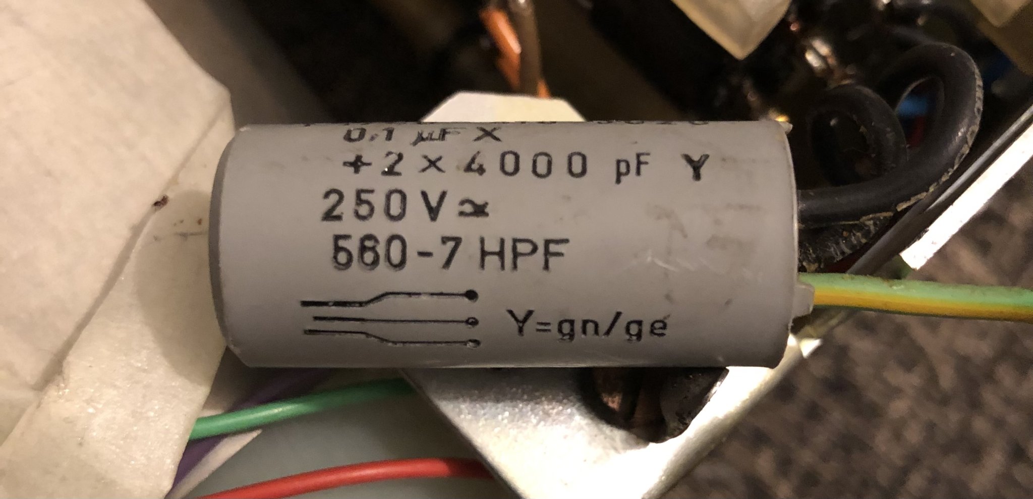

Hello , I have a problem with my analog oscilloscope . I want to replace the burnt capacitor of my oscilloscope, but the problem is that this capacitor is not available in a local store. writes up 0.1uf X 2x4000pf Y

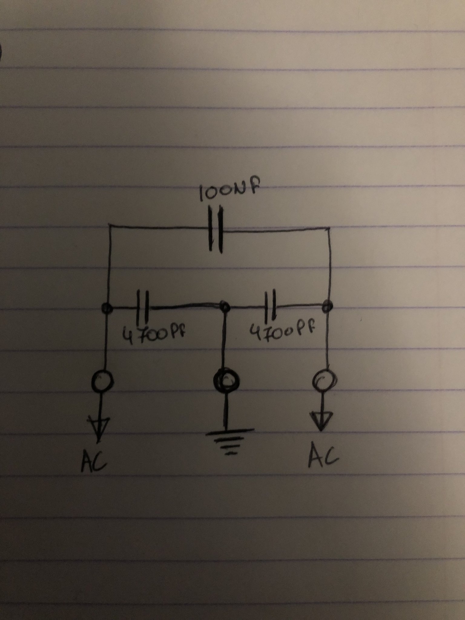

.and I thought to replace with 3 capacitors. 2 are 4700pf and one is 100nf .. the problem is how exactly will I connect them? I researched the topic a bit and thought of this way in the photo with the design. if anyone knows i would appreciate it, i am also attaching the capacitor that is burned .
