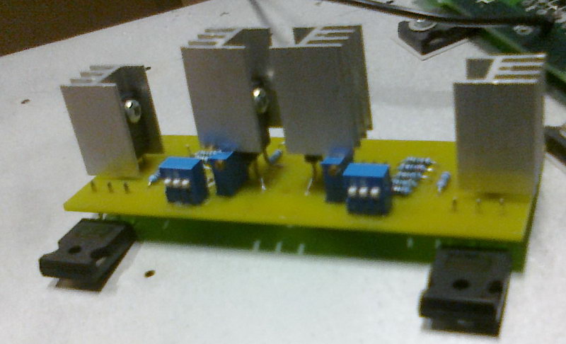

my f5 works fine,all voltages OK, it may work weeks without any issues. until i conects some DAC's and put up some juice at the input. then sk170 just blow and speakers read solid 24V. it was first time, and second and third. i can even force amp blow-just put on some complex music with bass and crank up volume and after 4-6sec. sk170 blows. amp did not clip (at least audible clip) before that, it put clean undiscorted output until j-fet dies.
I believe input is no more than 3-4v, while other amps do not complain when i am feeding them with balanced dac with output 6V rms(they just reach max output level and starts clip) I do not use any preamp.
any ideas, may I overdrive fragile F5 input fets ,or there is some issues with input which I should know? or some mods can be done? with ineficient speakers it would be good idea to swing amp for its max. I still have plenty sk170 but its not solution to replace them twice a day..

Put a resistor to ground about 100-200k, then a cap, maybe 1.0ufd film or larger, up to say 20ufd, then keep the same resistor to ground that is at the input of the amp now.
This will keep DC out.
Now, add a 200pf +/- 100pf to ground across the resistor to ground at the gates (input) of Jfets. This will keep HF/RF out of the amp.
If this cures the problem, then check the output of your DAC with a DC voltmeter while it is not playing, and then while it is playing. See if there is any DC reading.
IF this does nto clear it up:
You may have built the F5 so that it is experiencing a parasitic - self oscillation. This may only get out of control at high levels, which explains perhaps the relationship between higher level signals and something blowing it up.
Maybe there is a clue in the way it is built, so perhaps you can post some clear jpegs of your build?
AND, does this happen to BOTH channels or just one??

thanks fellows, i will try. it happens to both chanels, sometimes one blow earlier in few seconds than other -that depends on music material, all I wanna now is that this mismatch between this DAC(parasound dac 1600HD) and F5, but not at ALL high output voltage DAC (3-5V) I still need to drive F5 to full output. idealy this would be without any modifications as I want to have genue fruit of Papa creation..

Thanks , I still remeber my first ZEN V4 and how hlpsful DIYaudo comunite was then and now. I will measure DAC and will try higher gate resistors. while I am invalid in amp creation , I'am old enought to know that there is nothing for free 🙂 with higher gate resitors I will gain xxx and loose yyyy.. 🙂ataching completed amp. I folowed original design except erased thermistor and 2.2kohm resistor.
