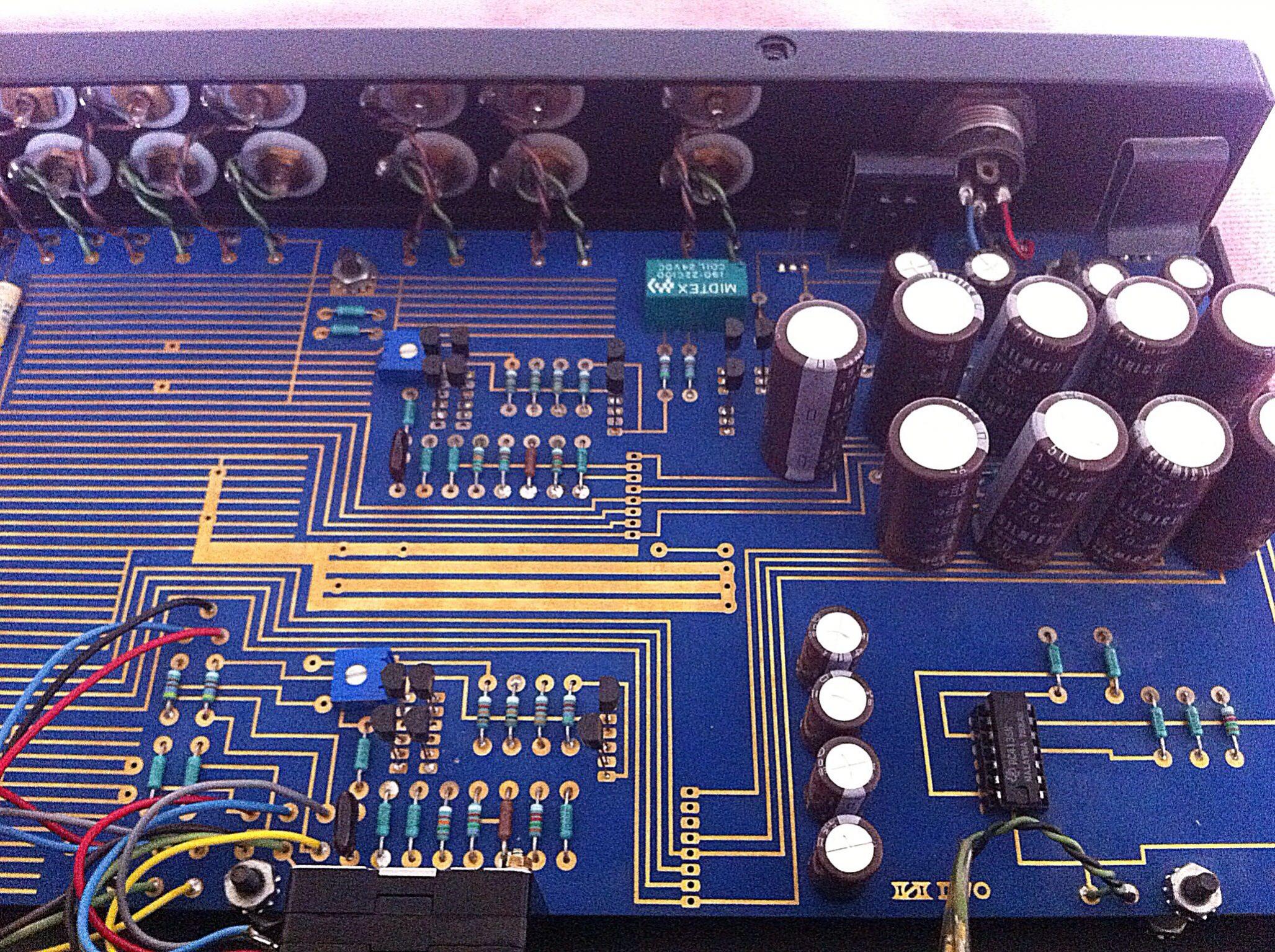

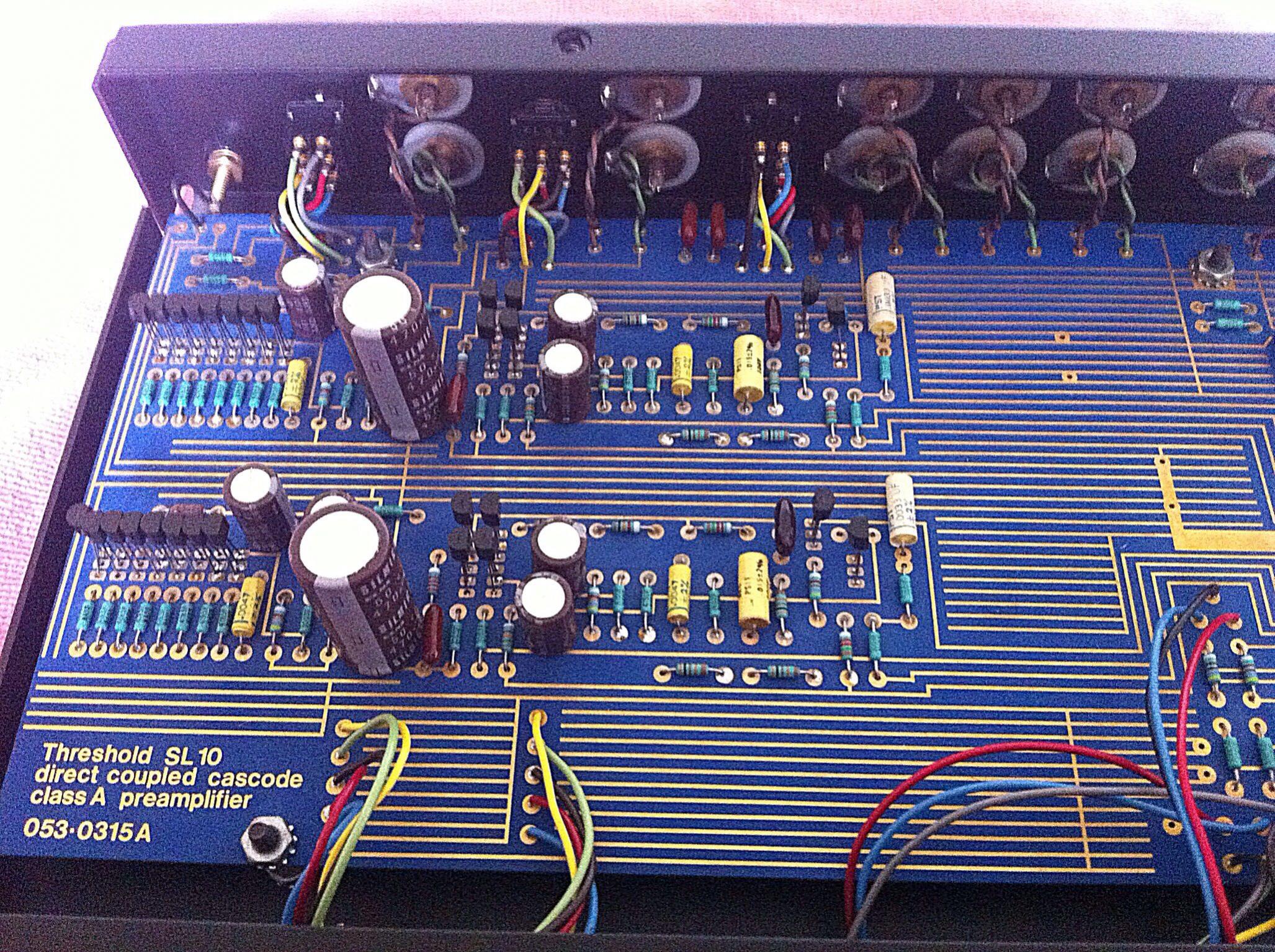

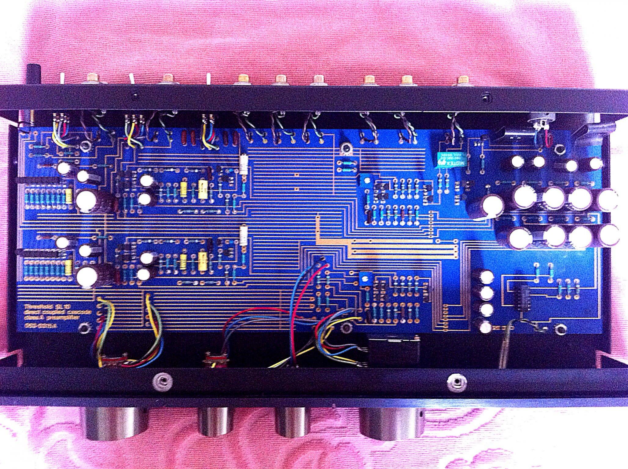

Here are some photos(sorry for the quality, I will try to re take them).
I've double checked all the cables/connectors and external connections — all good.

I recapped it :) So everything should be good there. I guess one thing was that I was having hard time assembling all these tiny rotary switches after I deoxited them. Do you thing you can shorten something in there so you have this "mono" problem while switching functions will be ok?

well , something is obviously wrong
useful and easy procedure these days , while working on gadget, is to make plenty of digi pictures
it can save you later , if nothing else - time saving during assembly ( less thinking needed) can be substantial
dunno ... comparing your pictures with pictures of SL10 from Treshold broshures , it seems all wires on pcbs are in place , and I resume that you didn't desolder any of them
culprit can be either on switches or pots - take a good look for unintentional shorts

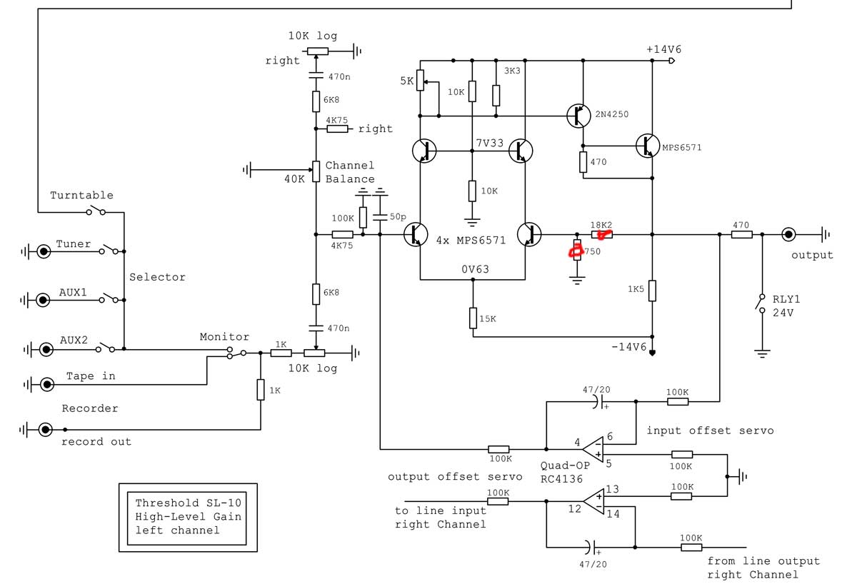

regarding gain issue - look at attached schm - for 6db gain decrease - either double in value 750R or halve in value 18K2 (both marked red)
The schematic has a minor error compared to my SL10. The volume pot in my SL10 is 22K, not 10K. But your answer is still fine.
Another way of reducing the gain is to increase the value of the 1K resistor in series with the volume pot. Increasing it to ~12k will decrease gain by about 6db if your unit has a 10K pot. If your unit has a 22K pot then increasing the resistor to ~24K would drop the gain by 6db.
