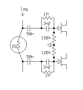

Hi Hazard..
As I mentioned in the Phobos thread, I have a new found interest in SG phono as a result of my visit to SoundSmith, and your writings. I too have purchased an EPC460 'for fun' and plan to build out a preamp, based on your design, using a Phobos PCB.
But as you point out, the SG response does not match RIAA after the 318us (500Hz) turnover. For what it's worth, here is a circuit, easily applied to your design, that corrects this, and includes the 50Hz rolloff. This mod will surely change the way it sounds. Will it be better, more accurate? I of course have no idea. I hope you try it out.
The math: the series value of the caps times the // value of the resistors = ~318us

Hey Hazard, I have an epc451 and I would like to build your new circuit. Do you think you would improve it using the above eq network? Also, I am not exactly sure how you go about trimming the 10ma target you want? Is that just a j112 and a varistor to ground in the schematic? Or is it going to -12v?
Hazard the schematic for the new circuit is drawn using 3.18nF but you say 3.18uF in the text? Likewise the new schema says BC550 but you mention BC560 pnp in the text? Polyphase would your circuit require any changes given the new schema may not be accurate? Thanks very interested in building this.
I bought myself a Decca Gold a few months ago and haven't been playing with Panasonic for a while now. So - I haven't tried Thomas' input eq network. Now I have built Thomas MC circuit and he knows his stuff so I'm sure that this circuit will perform well, but my suggestion is to try playing without any eq and see how it sounds. Most people use strain gauge without eq, my WIN does not need eq and a few of friends use Panasonic cartridges without eq. But the Panasonic I bought definitely needs a boost, in my system. So I don't believe that there is a hard and fast rule. There is a standard eq curve for magnetic cartridges, unfortunately there is no standard for strain gauges.
Other stuff:
The input cap is 3.18nF. Together with 1meg gate resistor, this forms the 50Hz time constant.And the BJT is obviously pnp so its a BC560 (I did say in a previous post that you shouldn't trust my calculations. Don't trust my scematics, either). My current source is a cascode J111/J112, the current is set by a resistor between J111 source and -12V, and the J112 cascodes the J111. But there are so many ways to build a current source, you can do whatever you like.
As suggested in an earlier post by Jam, my strain gauge circuit may have too much gain. I have found this to be true and I have changed a few values to reduce gain, and this works well with WIN cartridge. But a Panasonic needs a bit more gain. I will see if I have time to draw an updated schematic.

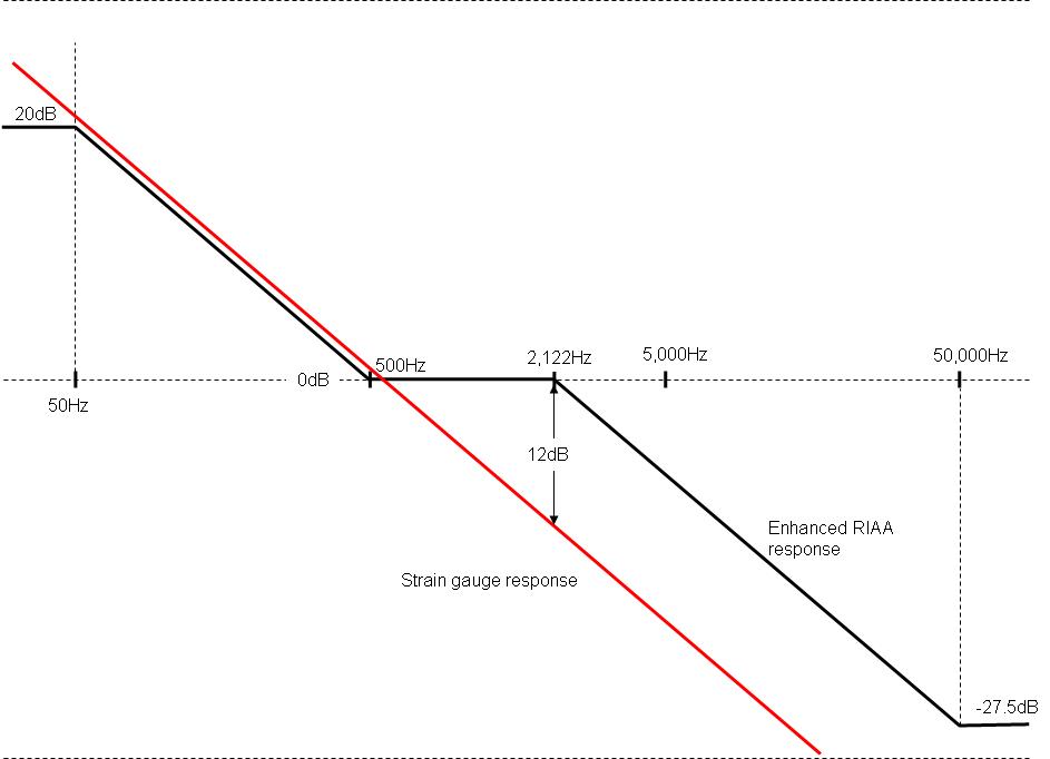

Back in Post #7 (April 2012!!) I was ruminating on eq requirements for a strain gauge, and suggested that a perfect displacement device would need a hf boost of 12dB to track the RIAA curve. I have re-attached the graph I exhibited back then. I didn't get much response, and as the WIN cartridge quite demonstrably had enough treble without any eq, I let the matter drop.
http://www.diyaudio.com/forums/analogue-source/211081-strain-gauge-jfet-pre-amp.html#post2992786
My interest was re-kindled when I bought a Panasonic EPC460 last year. I plugged this into my strain gauge pre-amp, and it was noticeably dull compared to the WIN cartridge. I recorded an LP through my 24 bit 192k sound card, I then opened the file in Sound Forge and experimented with eq. I got the best result with a treble boost of 4dB. Member Thomas posted a schematic in Post #33 which can be used to achieve this boost (more accurately, it is a shelf circuit that attenuates the bass).
Member Jam has now given me some more information, that has led me to this site
Audio Investigations: Equalizing the strain gauge
By coincidence this web page was written in April 2012, the same month I posted my initial thread! What a shame it has taken me so long to find this as Charkes Paterson has already covered the same ground, and reached very similar conclusion. Here are a few key quotes:
"The critical region requiring equalization is 500Hz to 2122Hz, right in the middle of the midrange. In this region, the treble must be shelved up at 6dB per octave to be the same as a velocity sensitive cartridge with no EQ. Since this region is just over 2 octaves, the total amount of equalization should be about 12dB. "
"But other strain gauge promoters who were not so hung up on ordinary audio engineering practices started producing high end strain gauge cartridge systems without using ANY electronic equlization. They did in fact have cartridges that needed less equalization than perfect strain gauge cartridges would because they already had a slightly rising frequency response characteristic. One of these Strain Gauge promoters was Sao Win, and his preamplifiers used NO equalization (and sounded mostly OK)."
"It turns out that even the Panasonic cartridges are not exactly perfect either. Just like the Win, they have a slight (but very slight) rising frequency response above 500Hz. They still need equalization for truly flat (correct) frequency response, but less than the 12.6dB that would nominally be required for a perfect position sensitive device."
"I thought it was about 10dB so I tried that. It sounded OK, maybe a bit thin. Counting on two octaves of equalization, I then tried 12dB of EQ. That was horrible. Rolling the EQ down to 6dB gave a nice warm bassy sound."
So experimentally I cam up with a requirement for 4dB boost for a Pana strain gauge, Charles decided on 6dB. Maybe I need less treble boost because my ribbon tweeters go all the way up to 11! But we are definitely in the same ball park.
So the corollary of this is -
1. If you have a WIN cartridge - there is no need for treble boost (not that I have already corrected for the 50Hz pole in my input circuit).
2. If you have a Pana strain gauge, you will probably need some treble boost 4 to 6dB. Thomas' circuit is a good starting point.
3. If you have some other displacement type device - you will need to figure it out yourself.
Thanks to Thomas and Jam for their inputs on this topic.
