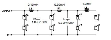

It would matter what the driver impedance is but you can scale their network if your driver is 4 instead of 8. Since that is half impedance then cut all network impedances in half. That means double every capacitor value and halve every inductor.
David
David
David
Hi David,
The LC pair are used to emulate the circulate arc (delay). So it means the LC values cant be changed without affecting the arc. Is my understanding correct? Also I don't see the load value being taken into consideration in the patent.

Keep in mind that it's not the component values that create the phase delays but the acoustical responses. Unless the drivers you choose have exactly the same impedance response as the ones in the paper you'll probably have to calculate your own values.
In the end it is the relative delay between the elements. That means that the system is scalable in impedance and immune from the particular response of the elements (presuming all elements are the same).
Scaling impedance the way I mentioned (cutting all reactances in half to match a 4 ohm rather than 8 ohm) would give the same electrical curve shape at the terminals of each driver. That would give the same phase shift or group delay and so should match well to the JBL design.
If your driver response is way different than the JBL target, you should still use the same network (scaled or otherwise) to create the array, then use global EQ in front of the whole array.

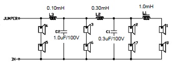

I figured out some things
1)The "mistuned" (part in the patent) means that the low pass corner freq is set for delay and not for a particular cutoff.
Look at the first two LC sections of CBT-50(image with 4 stages), it has each LC section fixed at 16khz when viewed as a typical low pass.
2)But look at first two LC sections of CBT-100 (image with 7 stages), it has the first LC at 22.5Khz and the second LC section at 8.5 khz
3) If we use the CBT-50 or CBT-100 driver arrangement, then at lowest frequency (where L is closed and C is open), the array impedance is such that as if all the stages were in series-parallel. So the drivers are choosen with unusually high impedance (about 10 ohms in case of CBT-50)to yield a nominal 8 ohm array impedance.
4)The delay also seems to be independent of the load resistance. LC ladder networks create delays at each stage equal to the root of LC product at that stage.
