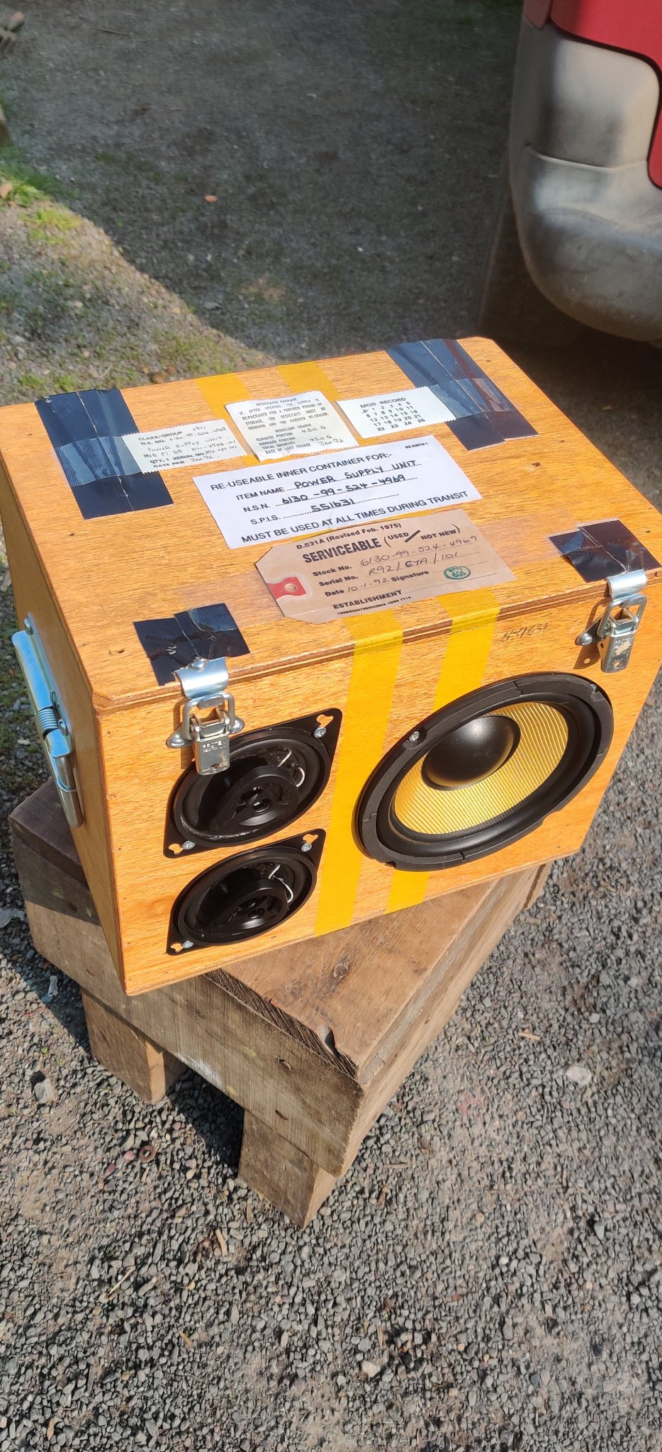

I've had a few speakers kicking about and found a nice box that they fit in. I've also found a couple of D class amps that can power the 2x3.5" speakers (140w) and the 6" sub (250w). The only problem is when running through a port calculator I'm getting a port length of 442.4cm @35hz which isn't gonna fit in the box! I'm not sure if I've messed up on my calculation and should have used a larger box. Can anyone advise if it's worth carrying on with the project either with a short port or as a sealed sub? I'm trying to build a system to run off of 12v for days out during the summer.
The box is 22x20x24.5cm and was thinking of sealing off the 2x3.5" speakers so would loose a bit more space.
Apologies if newbie questions it's my first build and struggling to get my head around it. 🤔

Why would you tune that box to 35 Hz?
Measure speaker parameters, unless you can get their datasheets, feed those to some cabinet designer software and it will suggest proper tuning.
Given the small speakers and cabinet, wouldn't he surprised at 80-90 Hz or thereabouts.

Working in imperial units:
If you were to tune that 0.353 cu ft box to the 35 Hz resonant frequency of the woofer, the round port length calculator in the link that follows suggests that a 1.25" diameter port should have a length of 6.7 inches (17 cm): https://www.the12volt.com/caraudio/boxcalcs.asp#por
To calculate the optimal box tuning frequency, we would require to know the Thiele/Small parameters of your woofer which, unfortunately, are not quoted in the specifications you gave.
Please note, however, that 1.25" is rather a small port diameter and could generate wind (chuffing) noises. Taking this and what JMFahey had to say, I'd be inclined to try tuning the box to, say, 70 Hz. This would require a 2.0" inside diameter tube of length 3.43" (8.7 cm).
P.S.The above calculated port dimensions seem to be in the correct ballpark to me. My David Weems "Building Speaker Enclosures" book gives an example of a 0.5 cu ft box tuned to 70 Hz by a 2" diameter port of length 2". A smaller box volume would require a longer port.
P.P.S. Under the circumstances, the dimensions would not be critical.

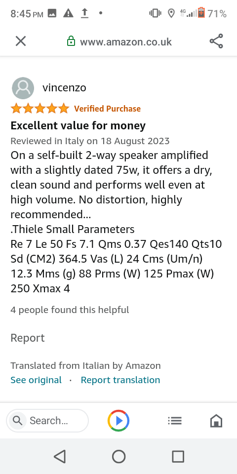

I did think that seamed a bit small when I adjusted the port diameter parameter on the calculator. Thanks for taking the time to have a look. I have a 2" port here from a damaged speaker at home. So tuning to 70hz could be the best solution. I'll check the book mentioned too as hope I can have a go at more projects in the future. 🙏
Let us know how it goes. Meanwhile, here are some more thoughts from my permanently addled brain! 🤓
You could always cut a selection of lengths from a 2" plastic pipe and slide them, in turn, into a snug locating hole to determine by experiment which length audibly delivers the best bass response.
And we should consider that this 6" woofer may actually sound better in a sealed box!
Let's face it, given this T/S parameter unknown woofer, experimentation is the order of the day!
