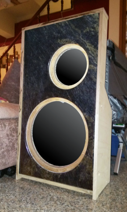

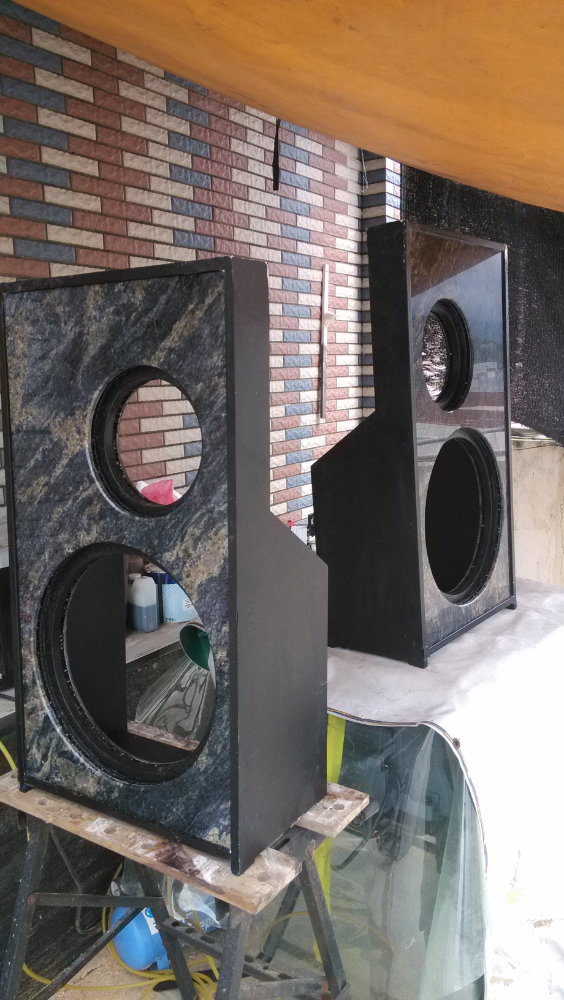

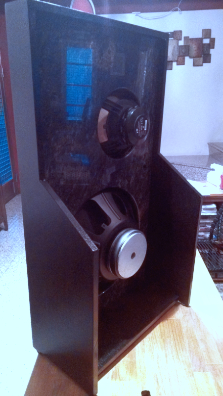

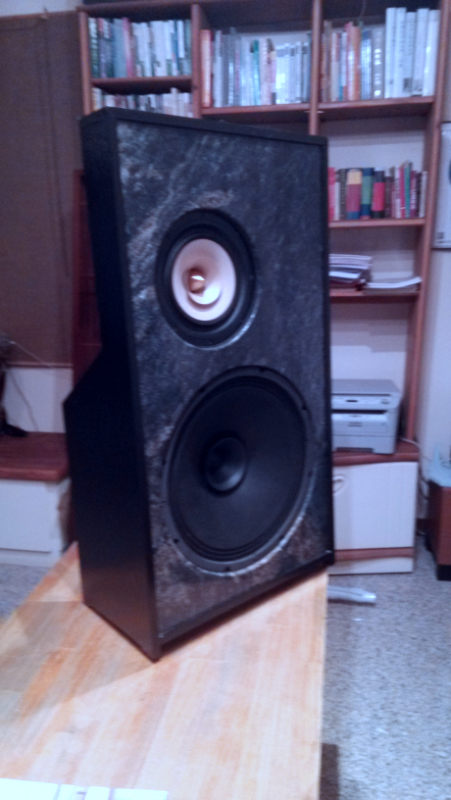

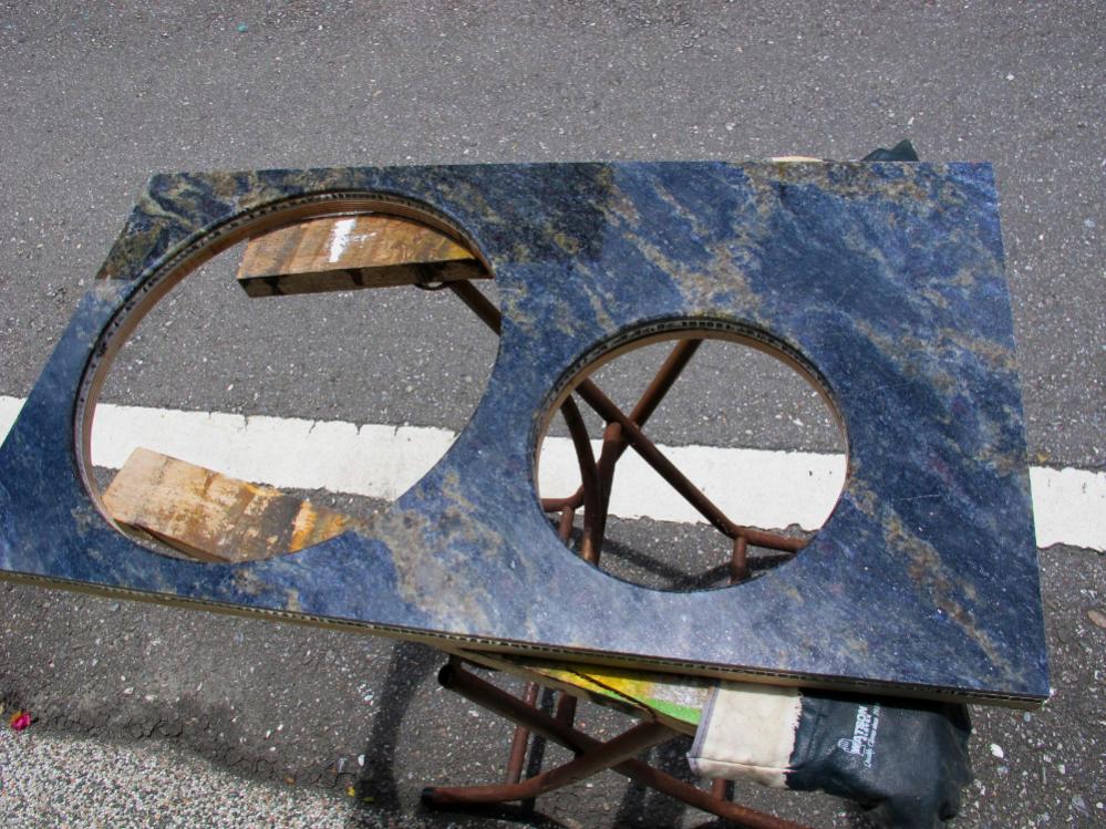

Pictures, ... well, I just took these.
Only need to wire them and they'll be ready!
I'm very happy with the final look.

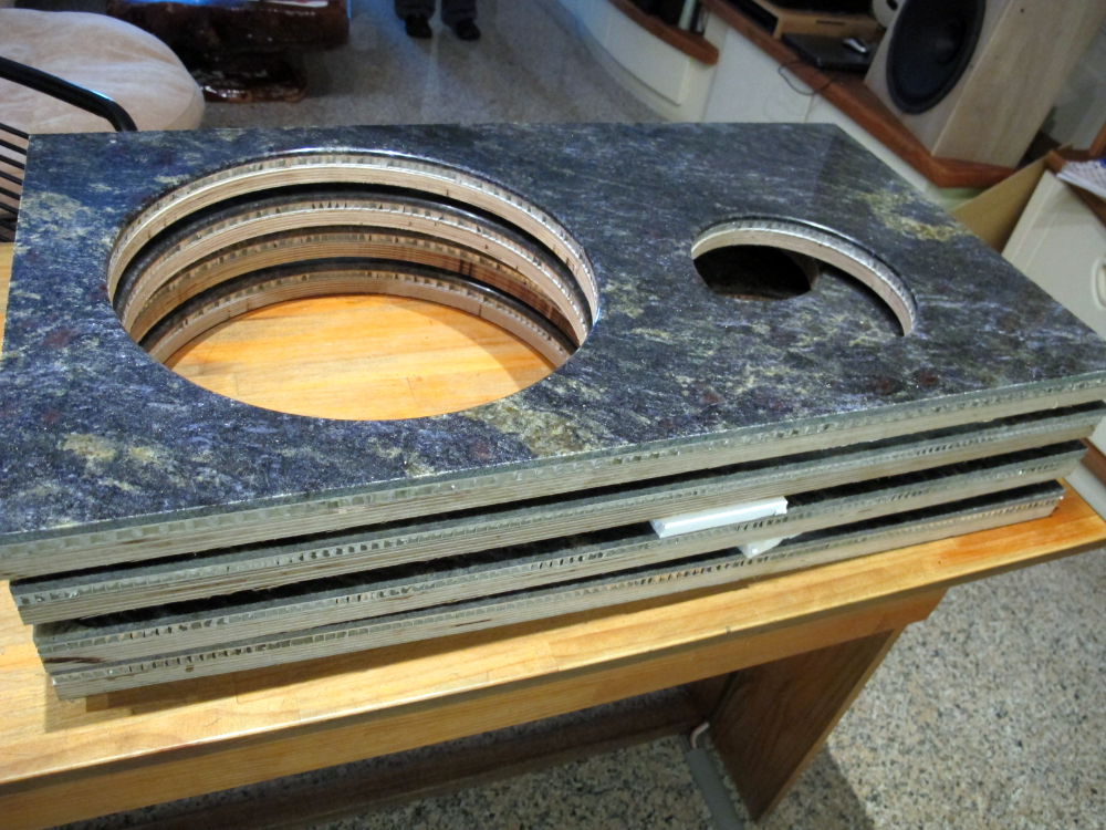

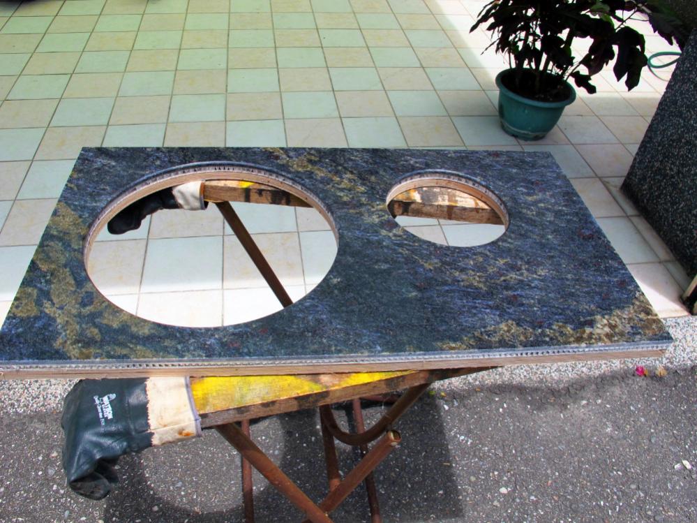

I know it took me a long time, but finally, here are the measurements I finally took of distortion from the Blue OBs. I needed some free runs to play with XSim, so it was the perfect opportunity to do this test.
I just let each driver (the W8-1772 and the AHE15") run without any filter or EQ.
The layers of stone, aluminium and plywood are doing their thing! The distortion spike at 30Hz is a glitch with the sound card.
