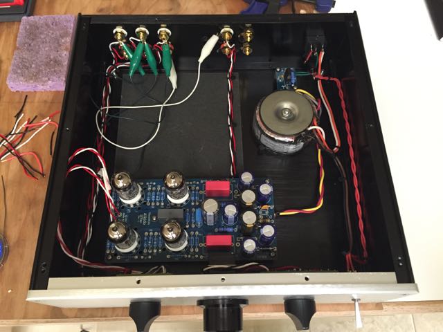

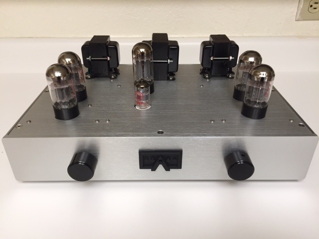

Interesting. In the distant past, I built the 6SN7 based Aikido with a Janus regulator PS. I also built the 12VAC Aikido with 12AU7s. The 6SN7 one sounded more "polite". The 12VAC version had much more of a liveliness. Always made me wonder if it was the PS that made the difference, not just the tube types.
