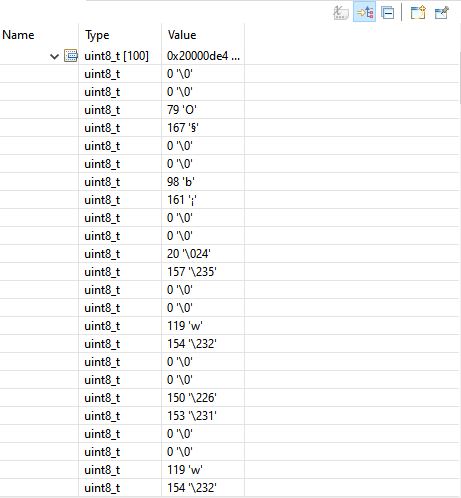

In debug mode, I looked at the buffer values, with one channel active and the other with tome, and it looks correct. Pattern of values around 0 for the silent channet (0x00, 0xFF, 0x01…), and logically changing values for the tone.

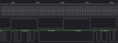

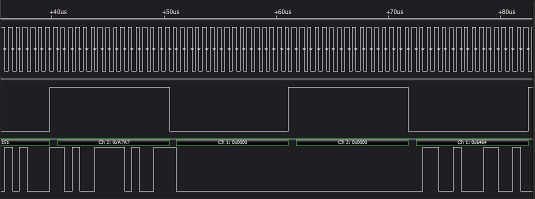

Hello,
I borrowed a logic analyzer. Setup it for I2S and connected to the board. Iplay a track with silence on one track and a 1000Hz tone on the other.
I ran the working example (Playback and record), and the output is fine: one channel to 0x00, the other with sensible 16 bit values.
Then I ran my code, and the output is clearly wrong. There are variants, but basically, it stammers. Instead of 0x0000, 0xDE1F, 0x0000, 0xCA... it gives something like 0x0000, 0x0000, 0xDEDE, 0xCACA, 0x0000, 0x0000,
However, the buffer from USB looks correct, with altervating 0x00 and filled Words for the oyther channel.
This should help to narrow down the issue, but I still don't have the culprit.
JMF
