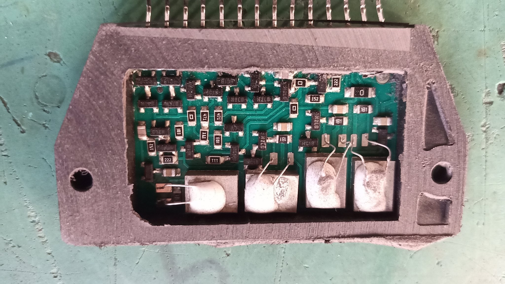

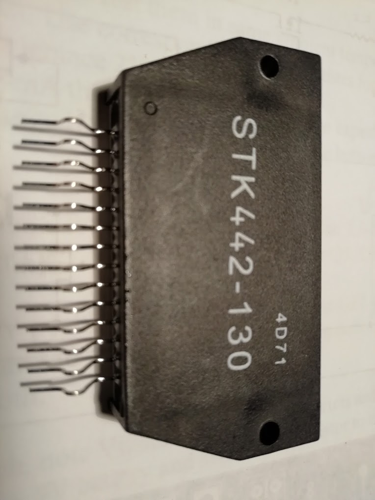

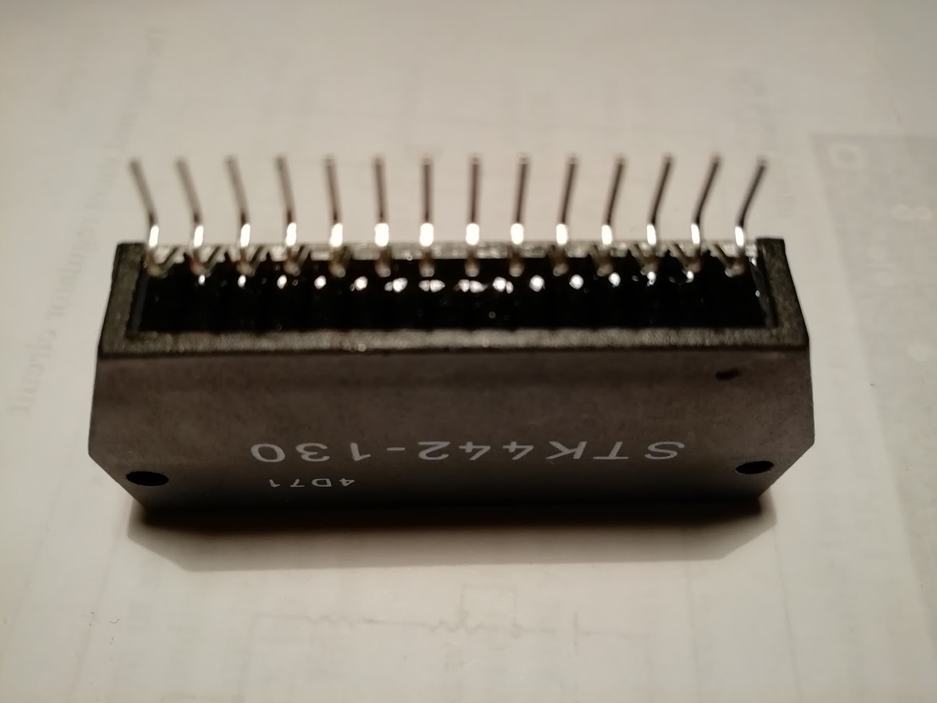

I have just received a couple of STK442-130 modules from an eBay seller located in the US. The chips have a 4D71 code on them. This code is the same I see on pictures from eBay sellers located in China, which makes me wonder if these chips are fake.
Any advise from the experts?

Definitely not a real original. But maybe not a BAD copy. I’ve seen worse on THIS part. The power stage IS chip and wire, with proper heat spreaders. As long as the thermal path to the back plate is good it would survive normal use IF the power stage dies are correct. They may be since this is just a driver chip. The use of white goop is a concern - if they resort to using it then the dies may not have the proper passivation and will eventually fail from moisture ingress. In that configuration, they won’t fail from thermal. They at least TRIED. The small signal devices being SMD is not a concern in itself - if you were building one yourself this is how you would do it. If you used DPAK (TO-220 type SMD) properly heat sunk for the power stage they would be fine, and that would be the way to build it. The really bad fakes out there use SOT-223 or even SOT23 for the power stage and there is NO way to get the heat out of them. The resulting high operating temp causes failure…. Very quickly.
The device in the photo is a decent copy, and with the advent of LED, the aluminum backed PCBs are easily available, so this is easier to make than earlier.
